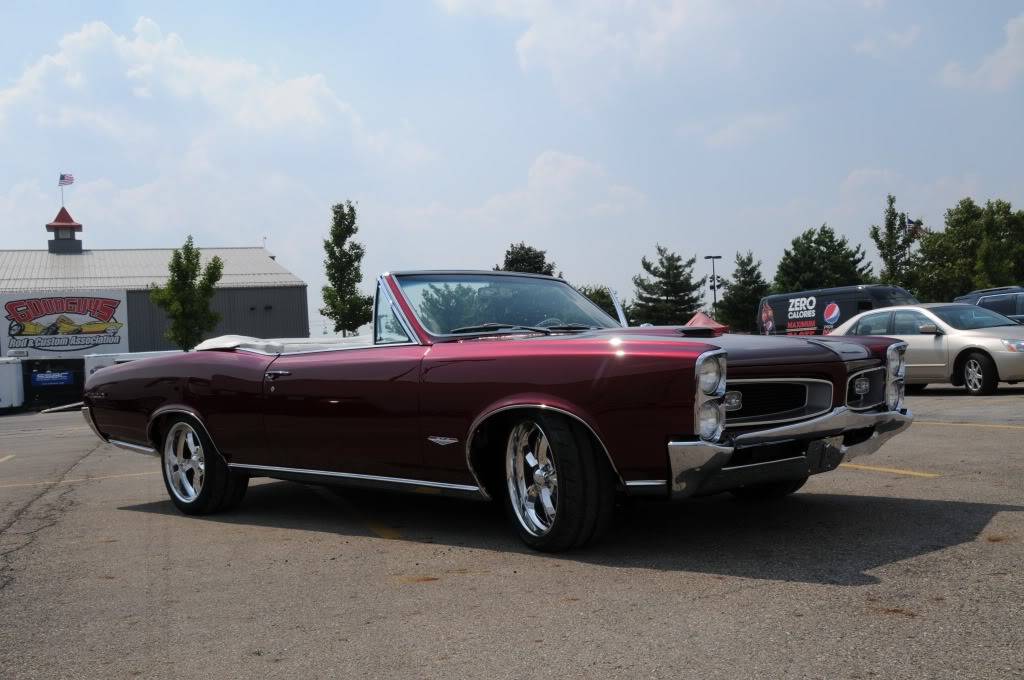

      You tell me if it's ok.
      This is with Stage II+, spc lowers, currie rear setup. Spc springs and bilstein shocks.

      looks good to me!
