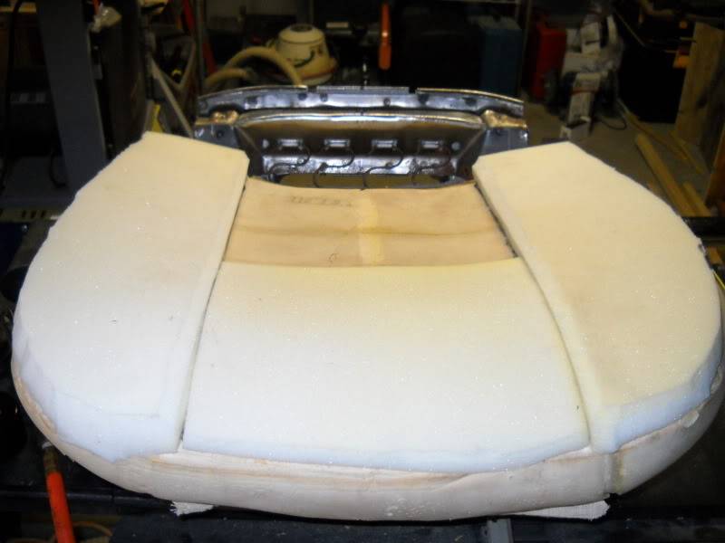

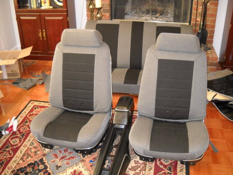

      I love the chrome trim back of my 442 seats, but they are crappy.
      I added some medium density foam, some ne springs, edge wire to pull down the center....... and it feels like I fall into these seats.
      Before
      A little 1" and 1/2" foam added, cut 1/2" slots in the old foam for center section.
      After
