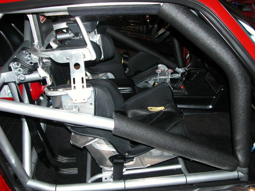

      Doug, The G body floor to seat bottom bracket mentioned in the link above is designed for use with the # 41 Kirkey seat, and ONLY for the 16 or 18" sizes. The #41 is the Pro-Street Drag race seat. If you go with one of the more road race oriented seats and want to use that bracket I'd check compatability.
      As a side note, an 18" Kirkey is HUGE by LARGE! I bought one for the navigator seat in my 2nd gen bird because I have a couple very large buds that wanted to be navigators for Open Road races. We couldn't even get an 18" in the car. About a hundred bucks in shipping later I swapped it for a 16". G bodies have more room to fit seats but get the measurements off the Kirkey site before you order to avoid my costly time consuming mistake. Even the 16" I bought had to be modified to fit because of the height.
      Here's the 18" next to my 14" (I'm small).
      Here's the 16" after several modifications to the head halo and height reduction. This is a NASCAR type seat so the head halo and shoulder protection is big, their # 45 and #47 are better suited for most PT type cars.

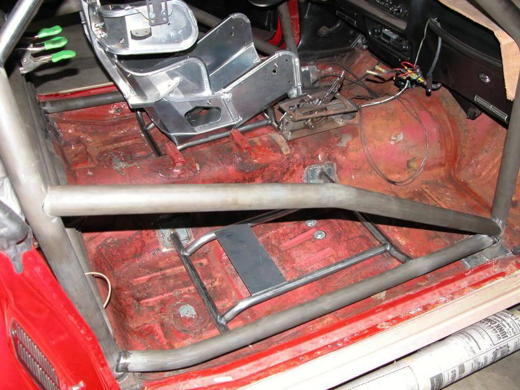

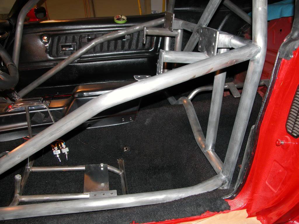

      John,
      Do you mind posting a pic of how you tied the small tube seat mounts to the car on the inside? Do they loop over the transmission hump or tie to the floor on that side?
      jp
      ​John Parsons
      Loganville, GA
      931
      Here is a good way to do it (F-bomb Camaro)
      http://www.hotrod.com/projectbuild/h.../photo_13.html
      2018 Cruze LT Hatchback
      2003 Suburban 2500 8.1L
      1975 MGB Roadster
      2003 GSX750F Katana
      Florida
      2,391
      John: The seat supports tie to the tunnel. Helps stiffen the car, allows the stock console to fit without mods.

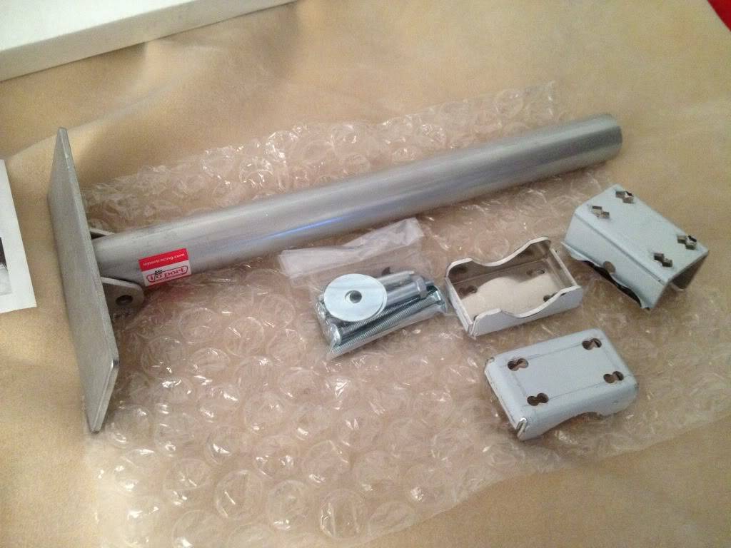

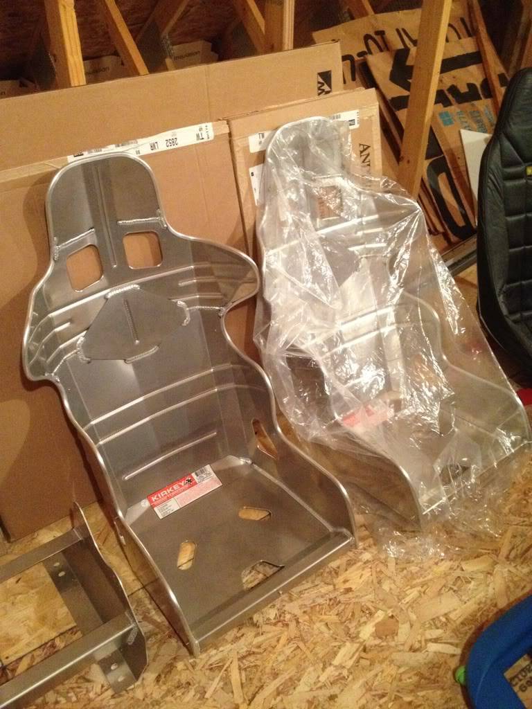

      Well it has been a year and I am finally getting around to mounting these darn seats!! I decided to take them to Jason's shop, G Force Design Concepts, and have them assist me in mounting them. Here are pics of the seats and the I/O Port Seat Back Braces. Couple questions...
      1) Do these seat back braces look like they are enough...if I even need them.
      2) What size/kind of hardware do I need to actually mount the seats to the frames?

      I think four 3/8" bolts attaching the seat to floor mount and floor mount to the floor is sufficient and meets most sanctioning bodies. It loosk like your seat floor mounts attach to the seat with 6 5/16" bolts. I would use grade 8 hex bolts or alloy steel socket head cap screws. What does kirkey reccomend?
      Seats looks great, what do they weigh?
      That is a unique seat back brace. I would suggest you use that. Do you have a roll bar already? Do you have a harness bar? Make sure the harness bar is at the correct height for mounting the shoulder straps.
