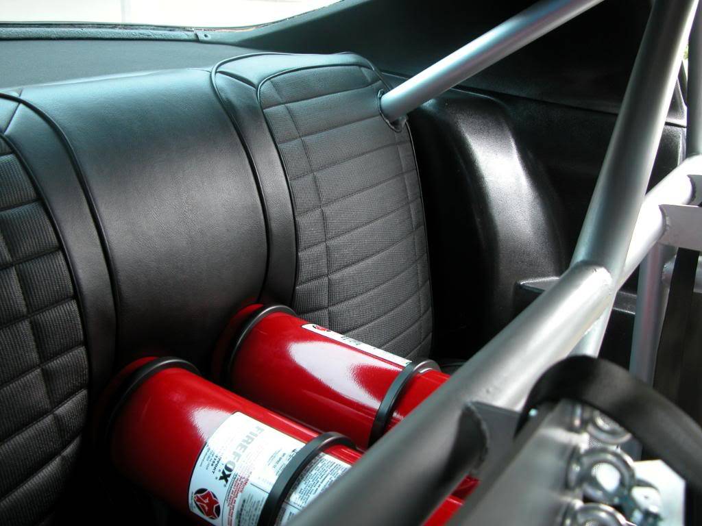

      I didn't care for the piggy back deal on those. I kept thinking "what if" something hit the bottles during a crash and swiped off the rider. My cars more of a track car so I wanted the weight as low and central as possible and protected as much as possible to assure functions after a wreck. So I mounted my bottles in the rear seat area since no one can go back there anyway.
      Jan 2000
      Thousand Oaks California
      10,190
      Interesting thought.
      Looks nice!
