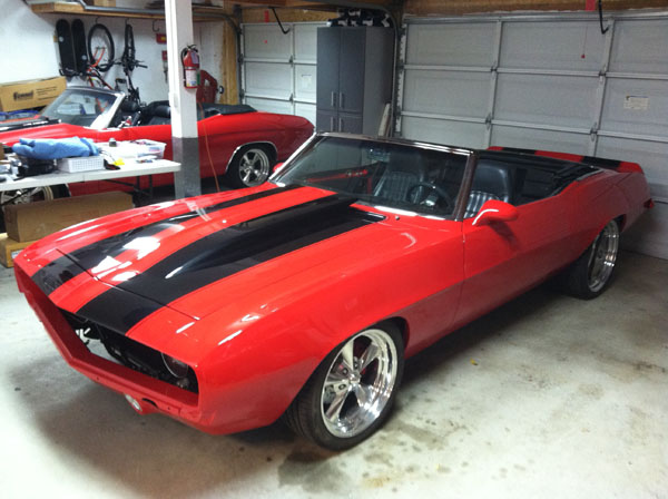

      First firing of the motor
      Pat should know what a beast this thing is...he was one of many who came over and helped get the car started for the first time!
      This is my first EFI build so needed to bring in help getting it running (using the FAST Classic ECU). Luckily my buddy Mike knows a lot more than I do and was able to get the car fired up.
      Also, special thanks to Pat (67 ls1 vert) and John (johnny68) who were also a huge help (Pat was also the one who painted the Camaro...at Pat's Custom Cars)

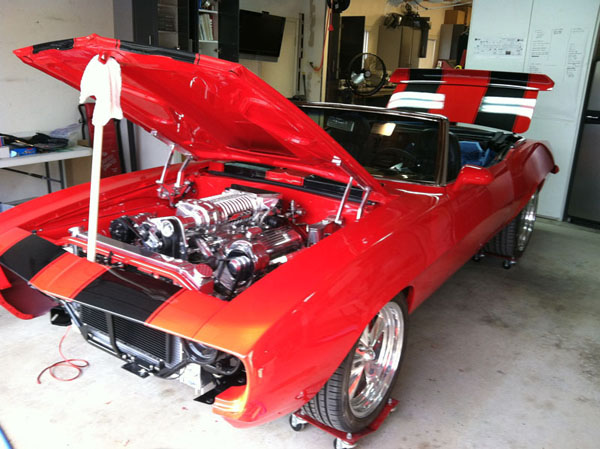

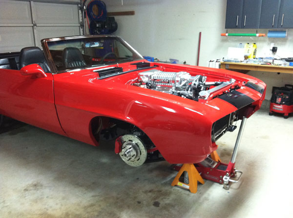

      Getting the front end put together...
      Ran the AC and heater hoses under the fender. These will eventually be protected by a set of custom inner fender wells. Also ran all of the wiring to the front end through the passenger side:
      Front end is coming together:
      Working on the wiring. Hiding wires is such a pain in the a$$ and why didn't I get into this hobby when I was younger?!
      Hid the fan relays and breakers, RH HID module, High Horn, and AC Dryer under the RH fender. The ABS Brake pump, LH HID module and Low Horn are under the LH fender (not shown).
