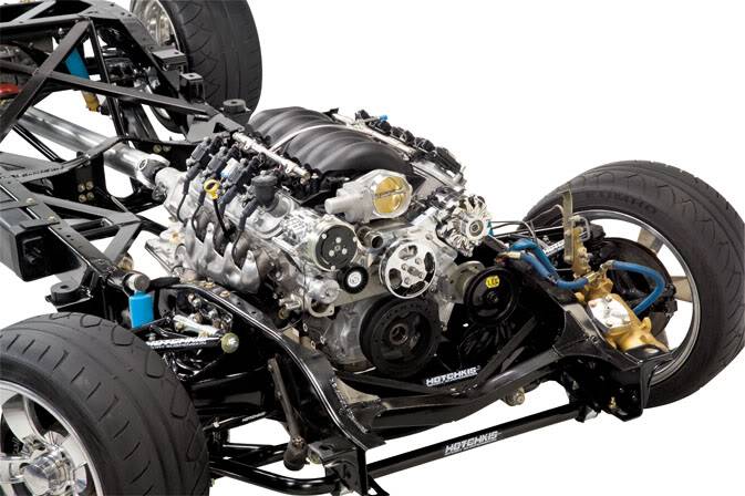

      Looks like this should be a great build.. I do however have a question about the front crossmember. Why did you guys decide to notch the center and not go with an aftermarket crossmember?

      Quote Originally Posted by FRENCHBLUE72 View Post
      Wouldn't an aftermarket crossmember use different suspension components?
      Although I did see a new aftermarket cast aluminum oil pan in a magazine recently that is supposed to clear most crossmembers. I don't know that it's available yet though.
      Jul 2010
      OREGON
      365
      There is a crossmember that clears the newer chevy motors and older alike it does however require a rack and pinion..
      Oct 2008
      Santa Fe Springs, CA
      625
      Quote Originally Posted by brakenit View Post
      BrakenIt,
      The crossmember we’re modifying is the original unit. Since we’re not modifying the suspension mounting holes, we’ll still be able to use our bolt on or stock suspension pieces.
      We could change the oil pan, but notching the crossmember leaves us more options of engines in the future and also allows us to install a GM Performance Parts E-Rod engine without having to loosen a single bolt on the engine.
      Thanks for the note! Keep following along on FaceBook.

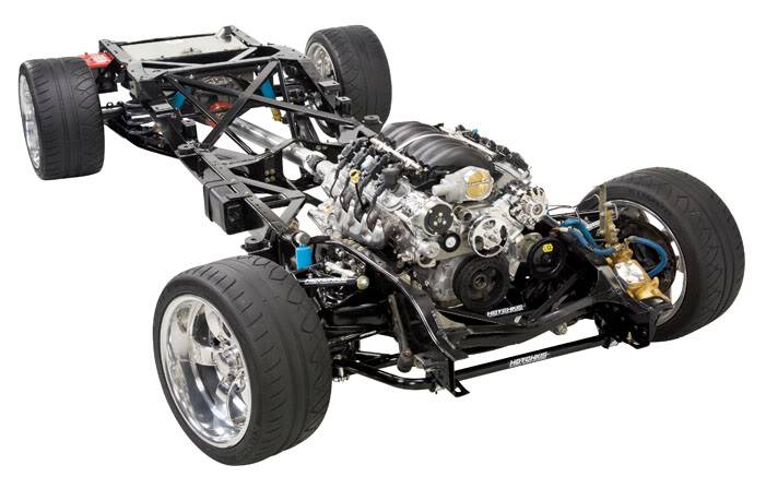

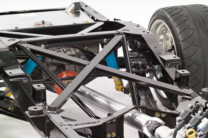

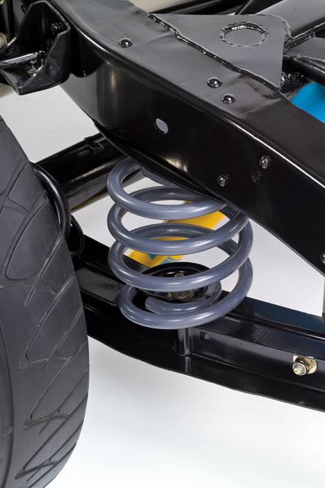

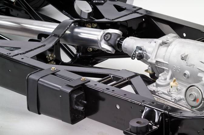

      We’ve been making a lot of progress on Project C-10 Overhaul!
      Here’s some beauty shots of the chassis showing off some of our handiwork and our TVS kit. We’ve also stitch-welded all the chassis seams and added a lot of strengthening braces and then had it powdercoated. The rearend was swapped out for a Cup Car style full floater setup.
      Now to start getting the body mounted and get the new GMPP LS3 E-Rod crate engine fired up. It’s coupled to a new GMPP 4L65E automatic overdrive transmission and controlled by a TCI control unit and paddle shifter. The engine has a new Vintage Air Frontrunner billet serpentine drive setup.
      It will be ready for some serious fun on the street, track, and autocrosses very soon!
