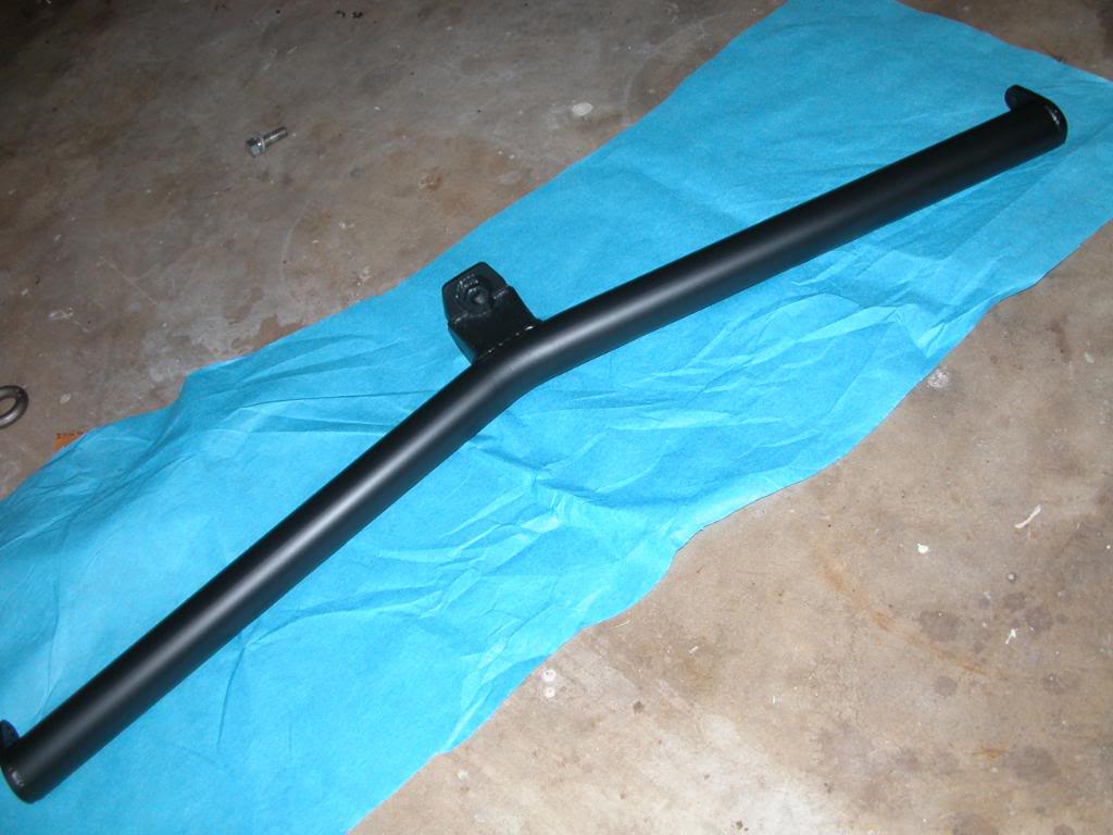

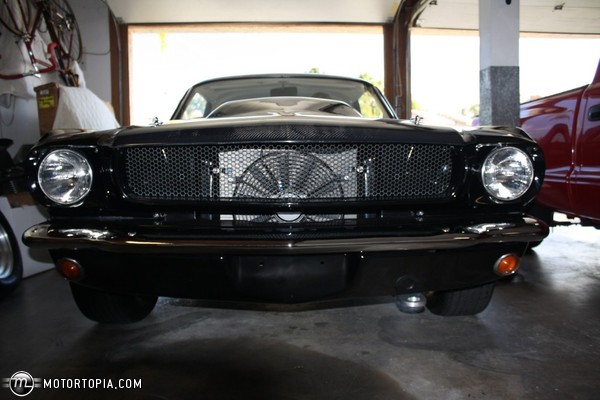

      I have one on my 65 mustang, I use it to pull it onto the trailer. i will try to find a picture. My dad made it from 1/2" aluminum and bolts onto the frame.

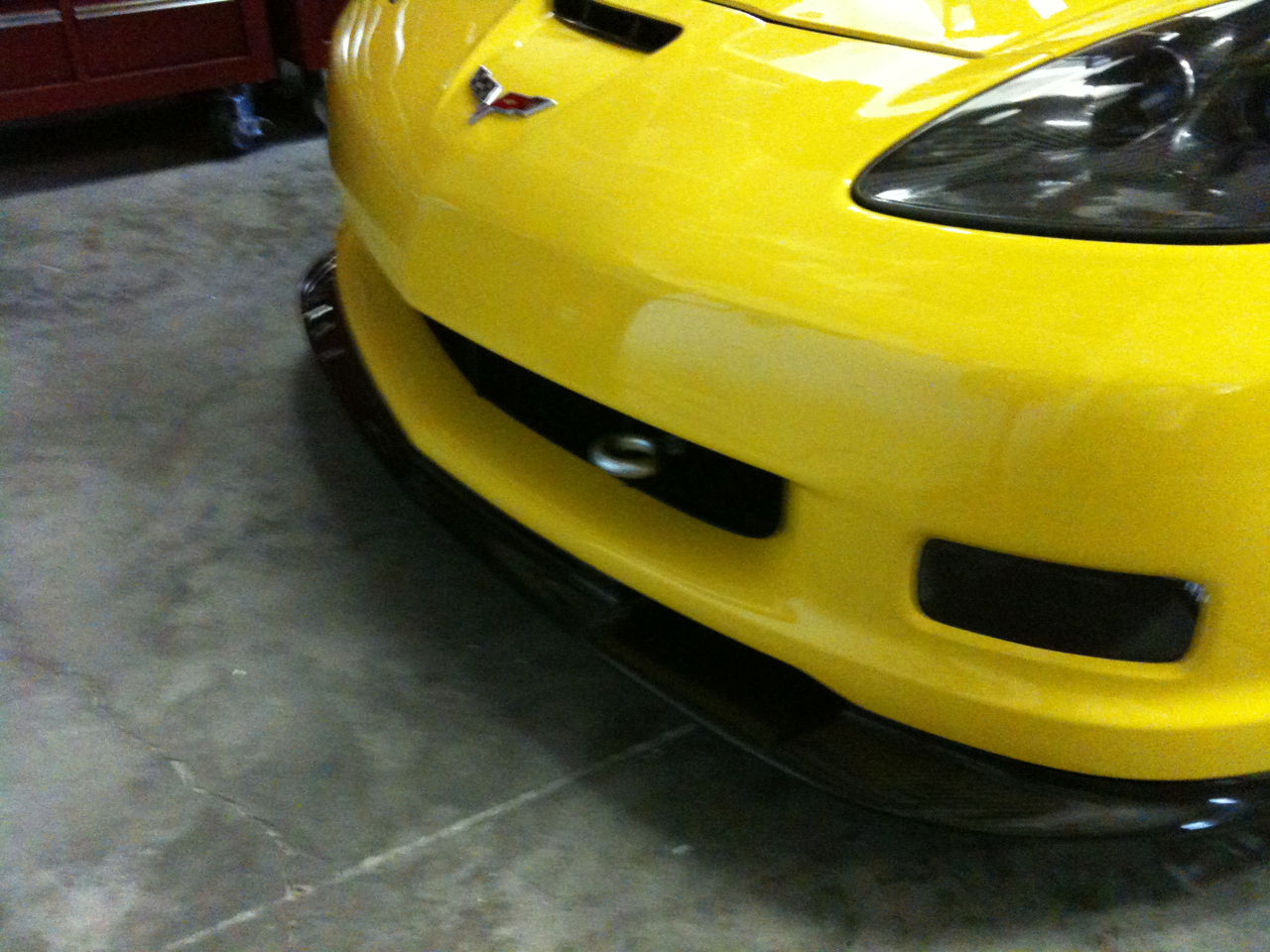

      I use this on my Z06. Like Bryce, I've found it it useful for trailering, pulling the car into position on the lift, etc.
      We'll be putting something similar on Unfair, along with tie-downs hooks on the frame.

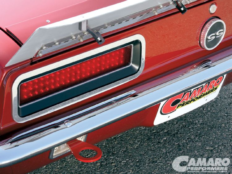

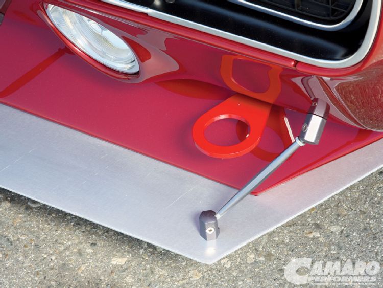

      two in the front - one in the back...
      Camaro Performers - photo by Steve Rupp

      So how do you mount that thing if you frame rail is father away than it is long?
