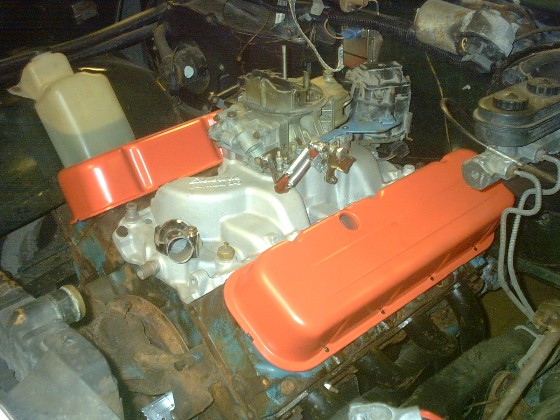

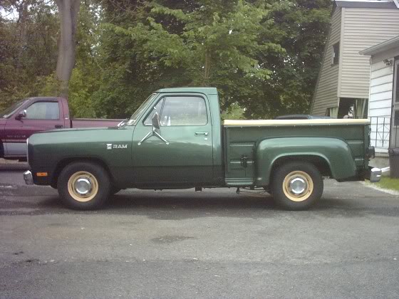

      Project is kinda a lead brick. Its a '85 Dodge Ram, with a 454 BB Chevy and a Mopar 833 4-speed manual overdrive. I have it mocked up and the engine is about halfway through the build. Just a 9.1 engine that I am trying to make run on 87 octane. I know its heavy and not ideal, but its what I want, so I am working with it. Maybe someday down the road some aluminum heads to lighten the weight. Till then, i just need to get it running.

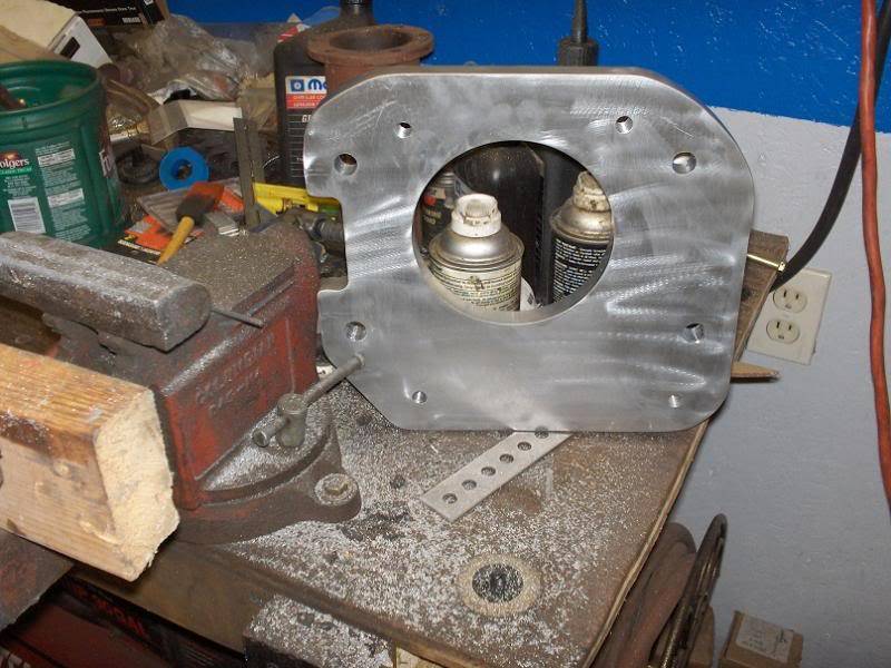

      I made my own adapter. I bought a piece of 3/4" aluminum plate , had my machine shop machine the hole for the front bearing retainer and then I drilled and tapped the holes as needed. Here is a pic attached to the lakewood bellhousing. I guess you could do it with a regular bellhousing, but I like my feet. I have about $150 into the adapter and probably about 4 hours of my time.
      I had bought one of those GM 833 trans and bellhousings. I ended up just using it for measurements then sold it. Reason was I think at times I may stick a non OD 833 trans in it which means Mopar length and didn't want to mess with two driveshafts, different mounts, different shifter mounts and rods, etc. Plus i can hook my speedo right up as I am still keeping the same brand trans. I have not had a flywheel and clutchdisc /throw out bearing hooked up so I hope i had all my measurements right. I also took a Mopar pilot bearing and had my machinest turn down the outer holder (which fits in the crank torque converter hub hole), so it fits into the chevy crank.
