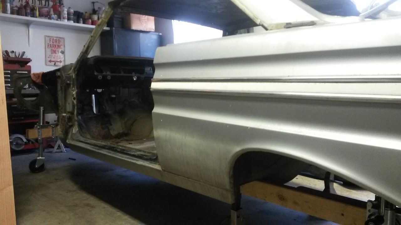

      Body is in great shape, really the reason I bought the car, it has already been taken down to bare metal and as currently sits is primered and only a skim coat and good sanding away from paint. The floor pans however are crap and will be replaced as part of the beefing up of the rockers and framerails.
