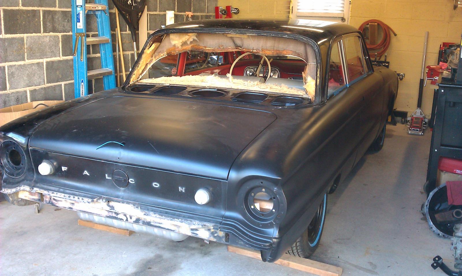

Size:  178.7 KBCongrats on the new move!! Your build makes me wish that I would have kept my 62. I bought it for my wife, but our newest addition to the family over ruled....
      Here is a quick pic of it..
