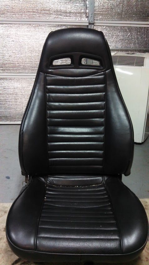

      Im using Gen IV Camaro seats. Recovered to match my rear seat. They have adequate side bolstering and can be purchased for super cheap. I added the harness slots myself. Just had to weld a bar to the frame to support them. No biggie.
      Those look nice, are the manual adjustment? Whatever I go wtih I plan on manual adjustment, no need for the added weight or complexity of power operated seats.
      1965 Falcon Hardtop
    8. #208
      Roanoke (FortWorth) Texas
      786
      They have manual OR power available. I had power but converted to manual for a lower seat position. I found these on craigslist and paid 50.00 for front and rear seats.

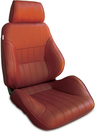

      Here is a picture of the seats. Should look good with the interior and exterior. Plan to go white with satin black accents on exterior and black/satin aluminum on the interior. Seats and some door/dash trim will be in the maroon vinyl.

    15. #215
      Nov 2007
      Lafayette, LA, USA
      485
      Those look really nice. Is that color right from Scat? Special order? They only had black when I bought mine.
      Life's journey is not to arrive at the grave safely in a well preserved body, but rather to skid in sideways, totally worn out, shouting - Holy cow - what a ride!!!
      See my build
      Jason
    16. #216
      Texan Back in Texas!
      675
      Yes stock color, but most places do not carry them "in-stock" and they have to be direct shipped from Procar/Scat. I bought mine through Summit Racing, black would have shipped same day, the Maroon are a 2 week lead time. I had Procar send me samples of all the availalbe materials. It came down to the Maroon or Blue, the Maroon fit the look of my build the best, and the wife also prefered the color.
      1965 Falcon Hardtop

      Quote Originally Posted by LowFast View Post
      Looks more "burnt orange" in the picture than Maroon?
      Michael Mosley
      1968 Barracuda
      Plano, TX
      https://www.pro-touring.com/threads/...in-Plano-Texas
    19. #219
      675
      Haha, I went to Tech so either way it is the wrong color. Truthfully the picture is somewhat misleading, I have the physical sample they sent and it is definitely an earthy maroon color.
