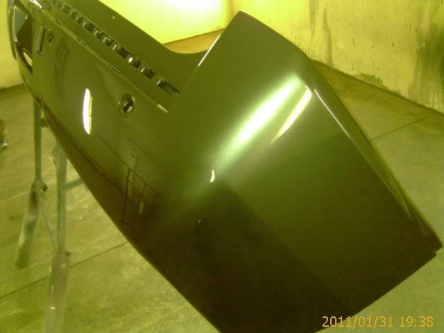

      That airdam is some sort of thermoplastic like TPO,Olefin,Elastomer or Polypropylene,either way, it can be cut and plastic welded, as long as it smears when you grind it,it can be welded, If I were you,I'd check to see if a full size truck airdam will work or buy two s-10 airdams, you can buy them dirt cheap aftermarket, cut two and make one.
      I just finished painting a bumper for Fernando's (killer67) new Escalade. I cut this bumper in pieces as you can see in pics below, shortened it by about 6 inches to give it a roll pan look,but still retain factory reinforcement bar/trailer hitch,parking sensors and a portion of what used to be step pad.
