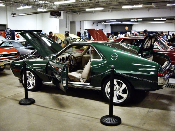

      Greetings – this is my first post here, so I thought I’d show off our favorite toy.
      This 6 year project began as a straight, rust and dent-free original California black plate specimen. Over $90k in receipts document the rebuild of this one-of-a-kind classic 2-seat AMX. 90% new old stock (NOS) using original AMC parts. We took what has always been a unique American Muscle Car and made it even more unique. Totally updated in every way, but still maintains a tastefully executed original factory appearance – with a build quality AMC could only have dreamt about. It rides and handles like no ’69 AMX ever did.

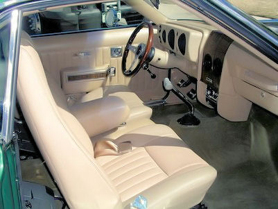

      Fully updated interior features high grade soft leather bucket seats and dash padding, pleated vinyl door panels, 72oz. cut pile carpet, fully finished and carpeted trunk, custom rear deck enclosure for sound system components w/trunk access, overhead console, custom padded felt headliner, padded vinyl A-pillars, visors, roof rails, front & rear windshield trim, and quarter panel sail trim, dual overhead map lights/dome lamp, 14” Grant GT mahogany steering wheel, NOS factory AM radio and speaker, NOS gauges. DynaMat Extreme installed everywhere before being closed up. Heavily modified but still looks as if it could have been built this way by AMC at the factory. Hypnotizing new car leather smell!
