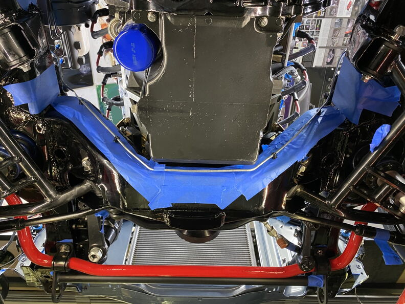

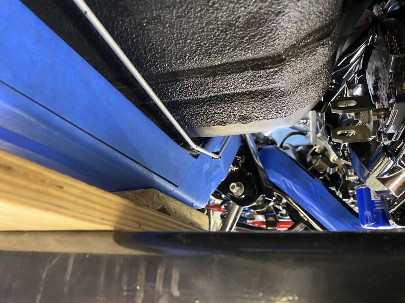

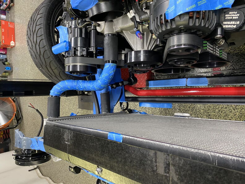

      So I am trying to figure out a way to run the lines so they look good and if need I can service them if needed. Remember I am not building a show car I am building car that I can drive and easily fix without having to take the 1/4 of the car apart to get to stuff.
      This might work and less chance of rub.
      Choppy Choppy
      So in order to charge the system I would need to have to trim/chop the inner fender or charge the system before I put the inner fender on.
      More blue tape notes
      Stepping Back.

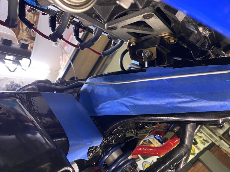

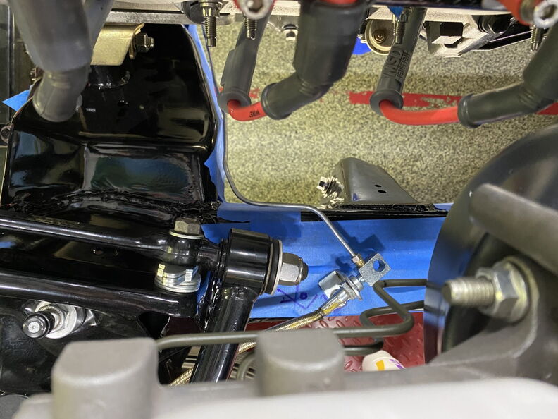

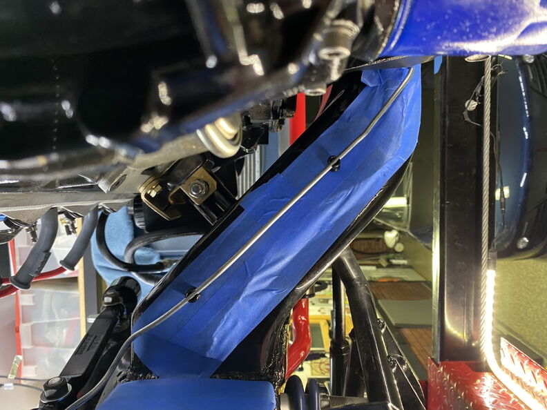

      Committing to the new brake line routing. (( 07-12-20 ))
      It took a little bit and I am finally happy with the location of the brake lines. So here goes nothing and if these don't work I am going to cry.
      Step One remove the inner fenders...again (really I am getting good at this)
      Step two remove the DSE Brake Booster (what an awesome piece) and slowly but surely loosen the nuts.
      Eak !!!
      Tap the hole.
      and install the ARP hardware from Totally Stainless.
      marty-mj

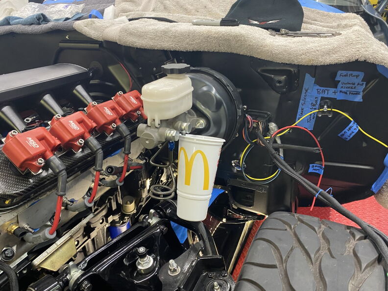

      Yet another while I am here moment. These two relays are for the Vintage air and before they were sitting on the top of
      the unit. By mounting them I will be able to access them if there is ever an issue.

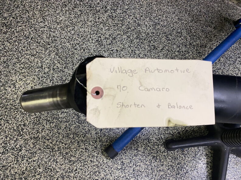

      07-14-20 I dropped my driveshaft at Village Auto and they took care of shortening it for me.

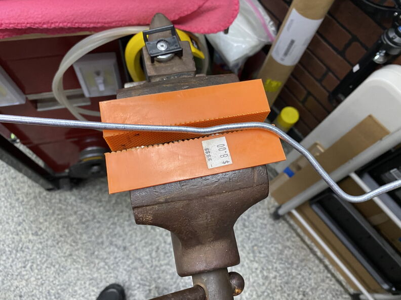

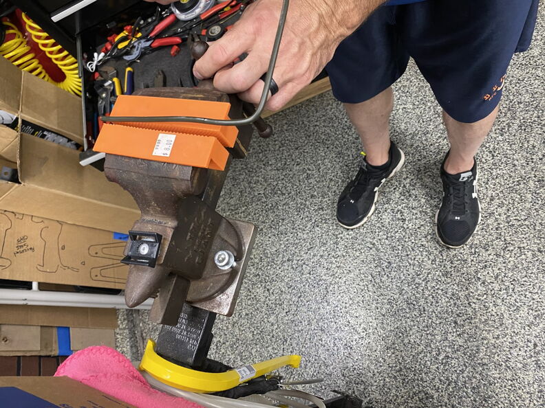

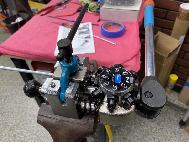

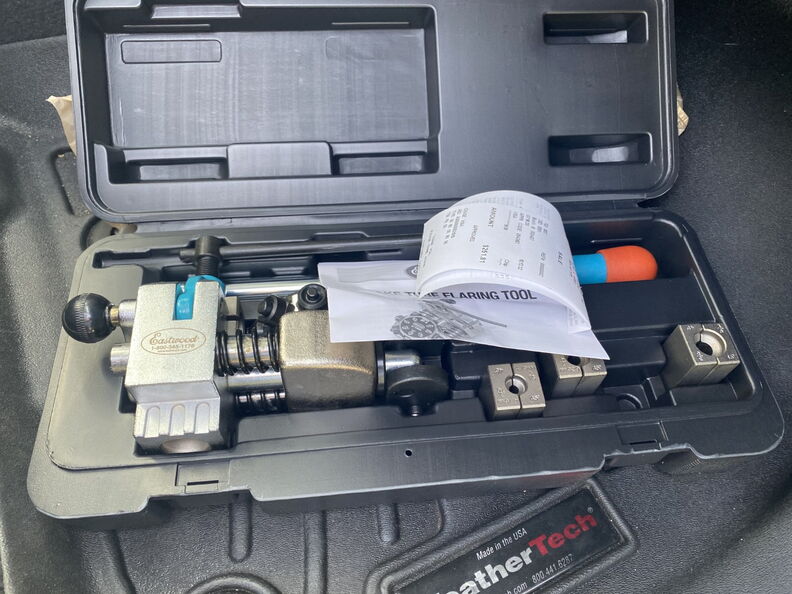

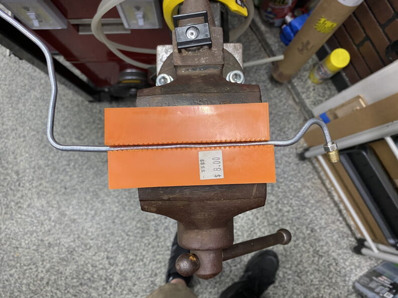

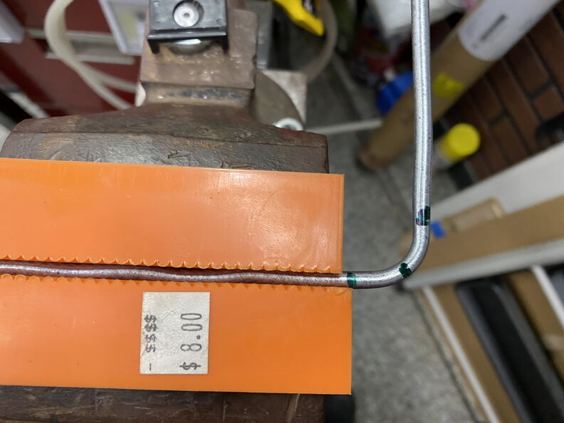

      07-18-20 Time to start working on the brake lines and let me tell you I haven't bent lines in years so I asked Mike if he would come
      over to assist me. I also picked up the Flaring tool from Eastwood hoping it would make my life easier.
      I pick up some steel lines from my local Napa and maybe one day I will convert these to Stainless Steel.

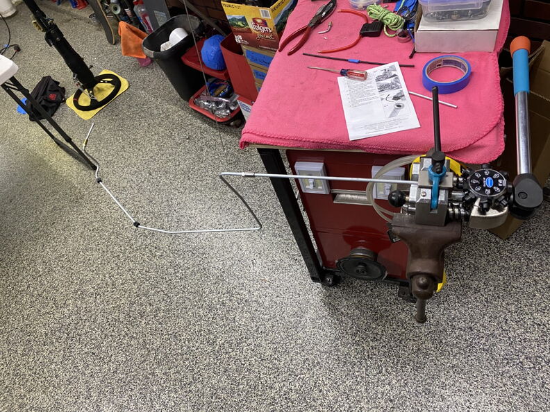

      Best 2nd Gen investment ever would be the DSE Brake Booster with the Kore3 brakes.
      Here we go.
      Love this tool.

      Not sure what you're using for bending duties but I've been mildly surprised at the small Harbor Freight line bender (dark blue). It's done all my lines with no kinks. Larger bender, not so much.
      Also, jealous of the Eastwood flaring tool! When I was working on my lines I found there were spots a traditional flaring tool wouldn't get into and I didn't want to pull the line down. I found this inline flaring tool at Summit, man, it's worth it's weight in gold. Makes great flares and is compact enough to work on the car.
      https://www.summitracing.com/parts/cav-164
      Keep it up!
      *Jeff*

      Thank you and that was the tool we used to bend the lines.
      Also, if you need to borrow the tool I will be more then happy to ship it to you.

      Back on the brakes lines (( 07-19-20 ))
      Working on the line from the Drivers Side to the Passenger Side. I did purchase a factory line and modified it to work with my new layout. Which meant that I needed to straighten some of the bends & curves.

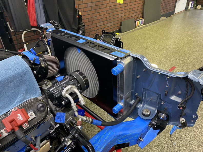

      Time to make some modifications and order a few new parts. (( 07-25-20 ))
      My plan is to keep this car simple and order a new steel trans pan with a drain plug and use ARP bolts to make it a little nicer.

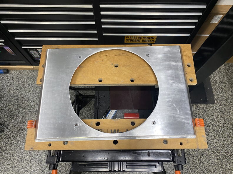

      Time to mount the Radiator ...
      So i need to lower the radiator down so out came the floppy disk.

      Fitting the Fan Shroud.
      The shroud also doubles as a way yo secure the radiator.

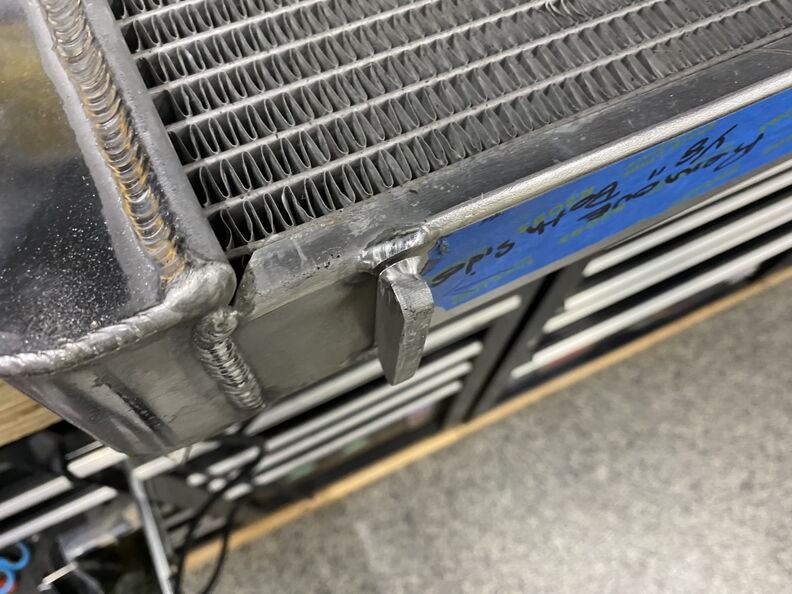

      Time to remove these tabs.
      and there gone....

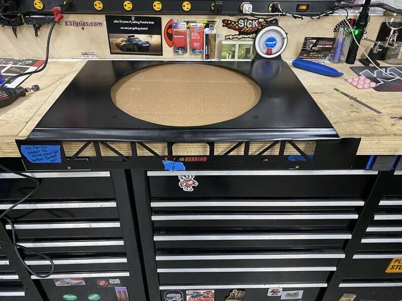

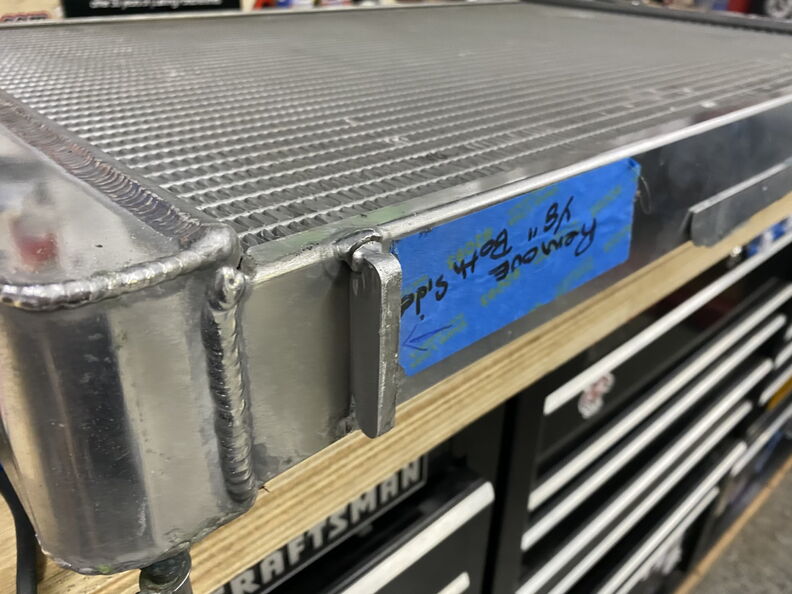

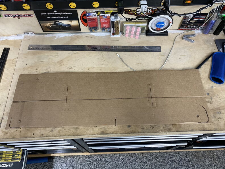

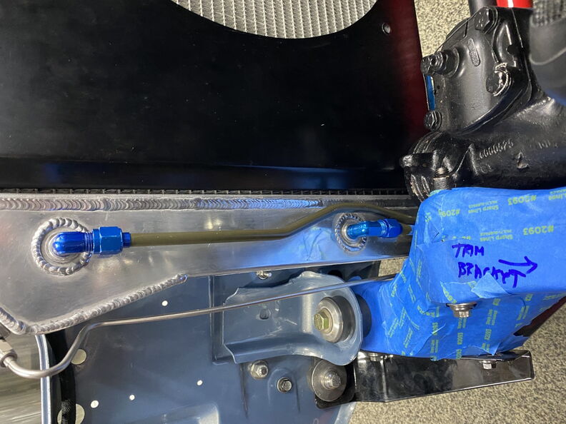

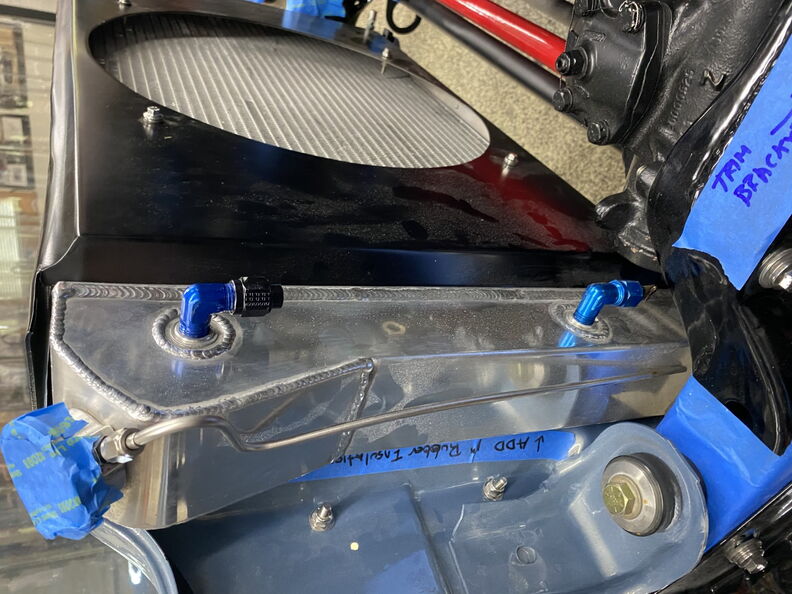

      Trying to figure out the top mount for the Radiator (( 08-01-20 ))
      Thank God I sell packaging as I have used so much cardboard and chipboard on this version on the car.
      Splashing some paint on the cardboard so I see what it might look like.

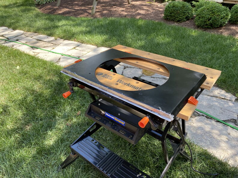

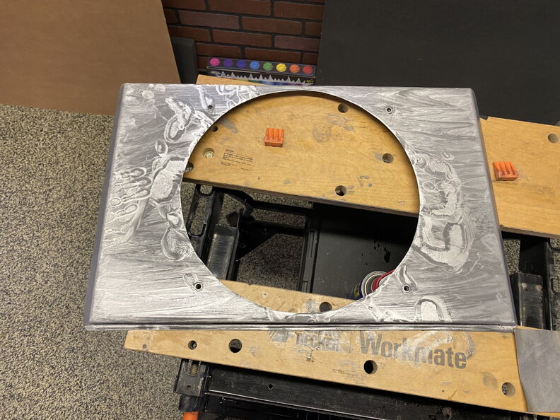

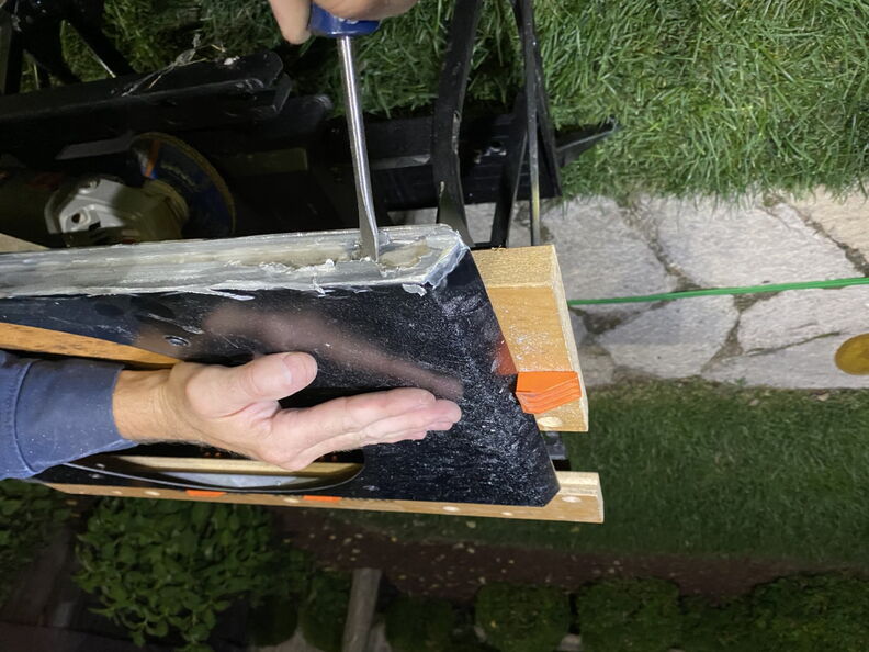

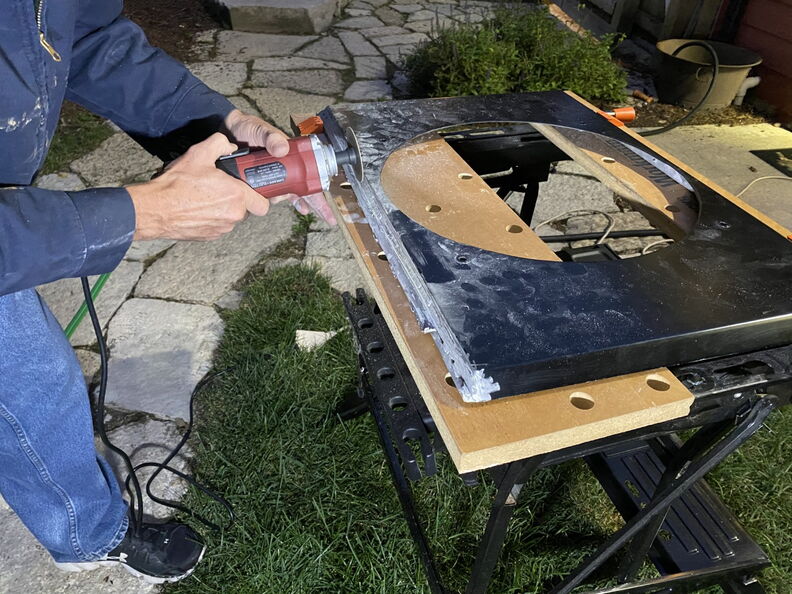

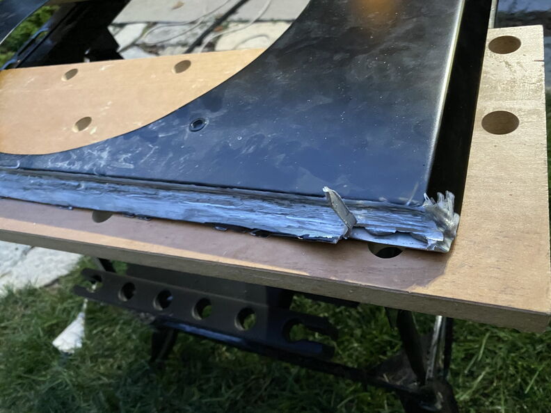

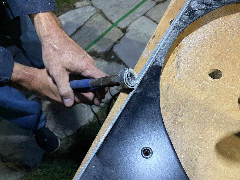

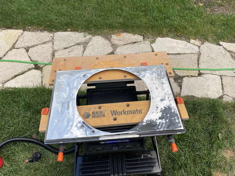

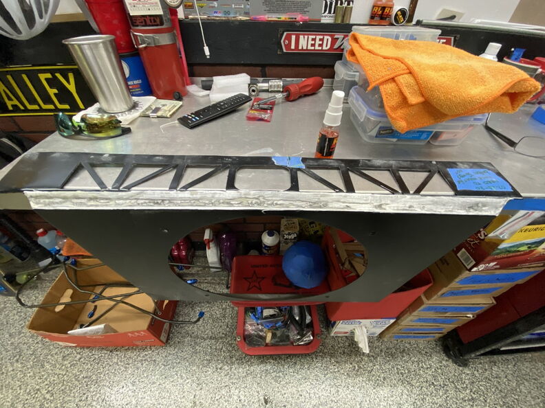

      This is not going to be fun but I plan to cut off the top of the Fan Shroud.

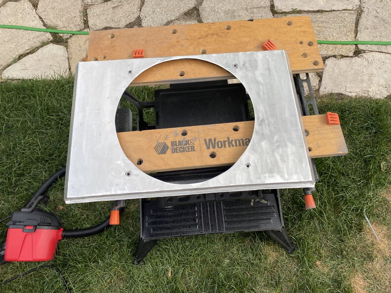

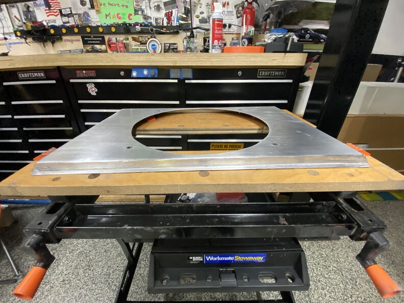

      Afco Fan Shroud Redo (( 08-02-20 ))
      So being honest this part has not been fun.
      Time to remove all of the paint and create a new way to mount the fan shroud.
      Close enough to take it over to get painted.

      Remember this edge from the first picture.

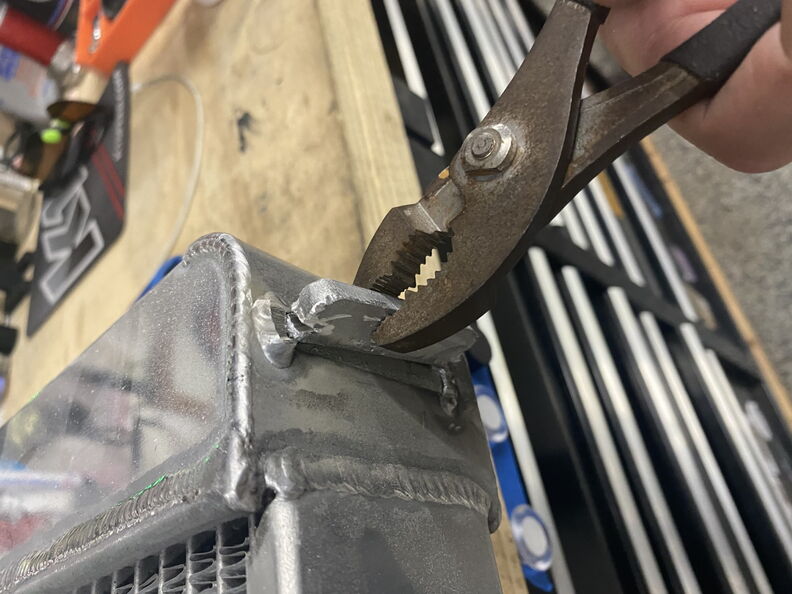

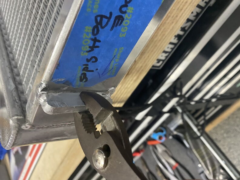

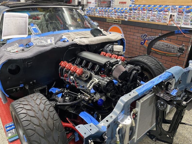

      New Upper Mounts for the Radiator (( 08-17-20 ))
      Time to make a better mouse trap.
      I decided to go in a new direction with how the radiator was secured in place. Keeping with the "KISS Principle - Keep It Stupid Simple" I decide to make a flat bracket they will attach directly to the Core support with rubber Well Nuts.
      And I might as well have Dennis "High Speed Welding" create a different way to mount the fan shroud.
      and might as well fix the inlets/outlets so they match the waterpump.
