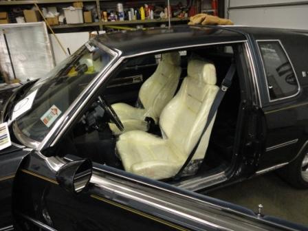

      Few of you guys have seen my 87 Olds Cutlass at Motorstate, day at the strip and RTTH. I figured it was time to give the interior a face lift and add some safety to the car. I decided to install a four point roll bar, install new bucket seats, carpet, console, and 5-point harnesses. I got the new seat installed. The seats are waiting to get into the upholstery shop to be cover in dark blue leather. The roll bar will be going in next week or two. New carpet is ready to be installed and console will be here soon. I attach a few pics of the seat mounted in to car. I'll post more pics when I get more done.
Size:  45.8 KBName:  cutlass2.JPG
      Scott

      Awesome build man! Looks good! Im in Kalamazoo, About an hour or so away from you. What seats are those? Did they come uncovered? A link to where you got them? Im interested in doing something similar so i can upgrade the performance of the seat, But keep them matching the original rears.

      The seats are pro-car elite I purchase them from lane automotive. The got them without covers. I should have bought them with covers. We could have used the covers as a pattern. When I get the seats back I'll post some pictures of them.
      Scott
