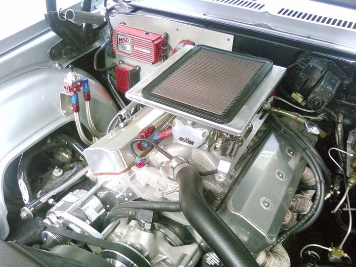

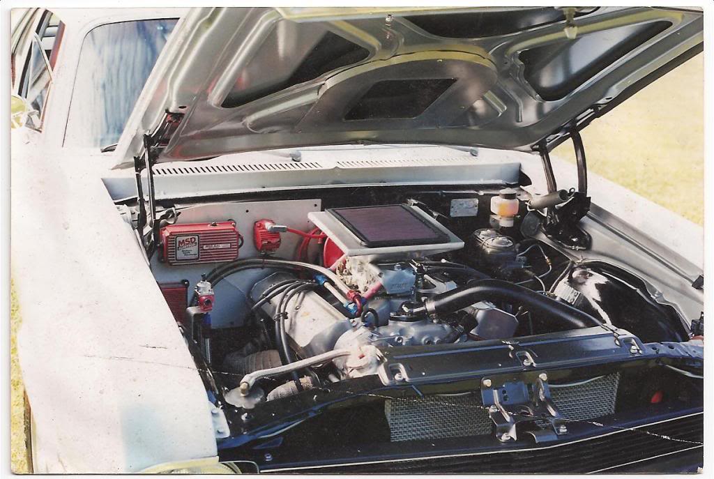

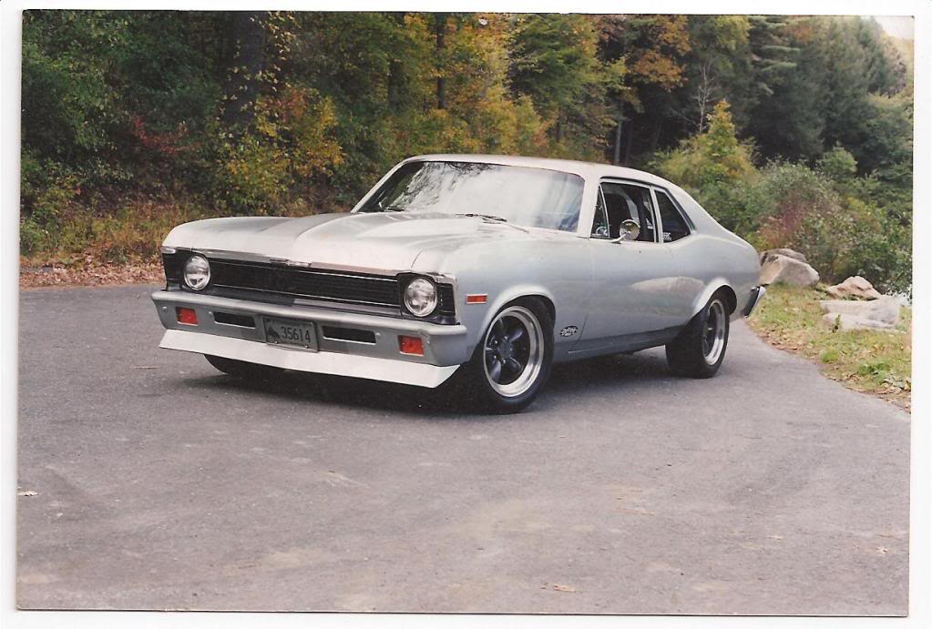

Size:  59.0 KB72 PRO-TOURING NOVA owned the car 13 years The engine is a ht383 Name:  44756_1436903636459_1049032382_31297759_6104055_n.jpg
Size:  104.4 KB 4.000 bore 3.800 stroke Edelbrock 200 E-TEC HEADS,air gap intake 750 DEMON double pumper,edelbroc extreme energy cam,tko 600 tremec 5speed,cenName:  NOVA022[1].jpg
Size:  55.3 KBterforce dual friction clutch hydralic,dennys nitrous ready drive shaft and 1350 u-joints,a well built 10 bolt posi with 3.23 gears and moser aName:  NOVA027[1].jpg
Size:  105.6 KBxels for top end speed,ssbc 4 corner slotted manual disc brakes rotors,custom ordered rear leaf springs,DSE upper&lower a-arms and front sway Name:  162730_1587355437660_1049032382_31611301_6991001_s.jpg
Size:  6.1 KBbar,rack&pinion steering,sub frame connectors and rollcage,custom dash panel with auto meter gauges,custom body mods including a cold air intakName:  165137_1587355277656_1049032382_31611300_1720871_s.jpg

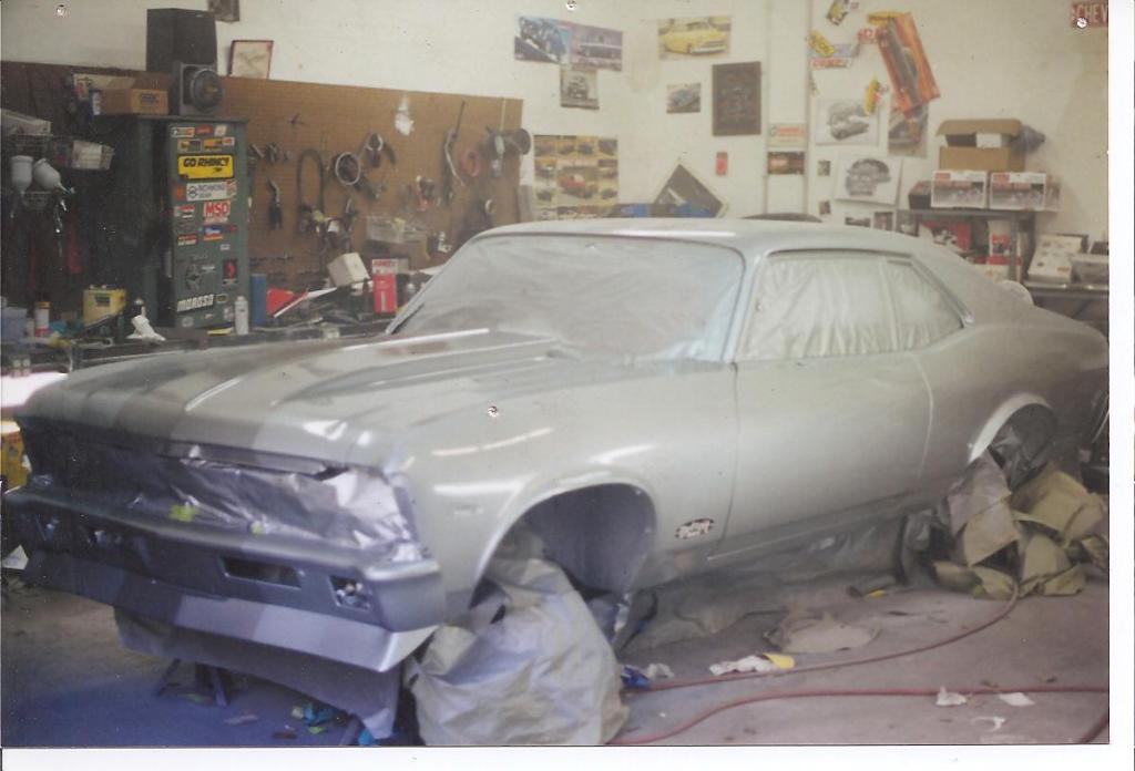

Size:  7.4 KBe lots more !!!!! did every thing my self with NO help from any one!!!!!!!!! and my first ever paint job. here are some start to finish pics.Name:  NOVA023[1].jpg

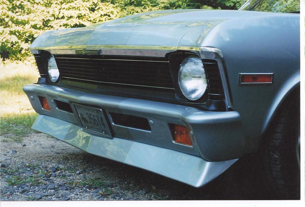

      That is really nice and clean ... What did you use for that front valence?
      1969 Chevy Nova - complete rebuild
      looks great
      Dec 2010
      CT
      6
      picked up the valence over 10 years ago,can`t find the place i got it from.

      Great looking nova! Has a nice stance.
