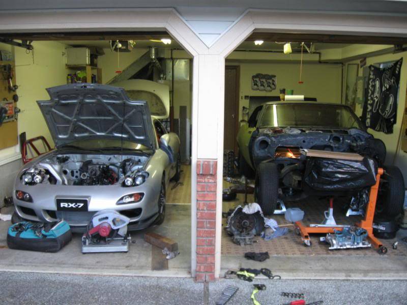

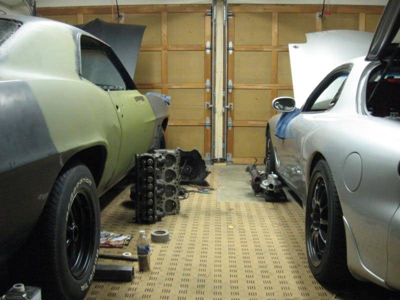

      heres my garage. the N/A turbo, piston rotary battle face to face

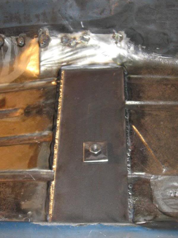

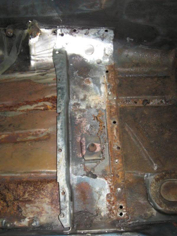

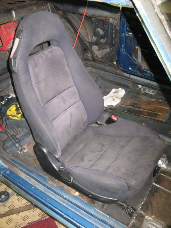

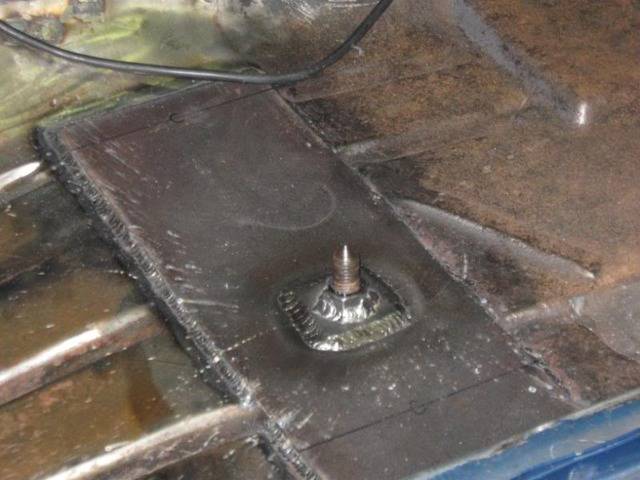

      so i decided to make new seat mounts. started tearing out the old seat mount, found the stock frame mount was in the way, so me and my buddy came up with a solid plate mount. this bugah is stong as hell. we were lifting floor to seal the gap to weld the plate, and with less than half the plate welded, we saw the whole car lifting.
      the angle iron is the going to be the mounts for the seat tabs

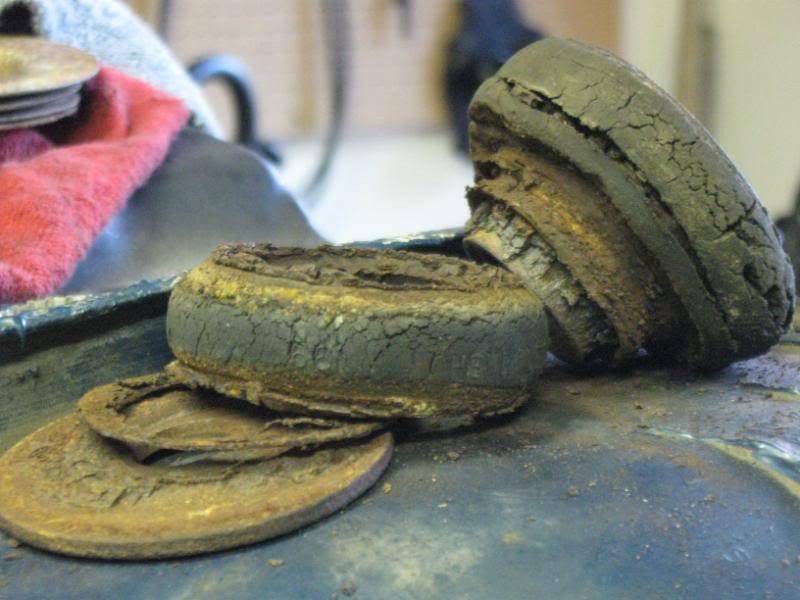

      time to go with solid bushings
      bought my buddys seats from the silver rx-7
      they fit perfect and are super comfy

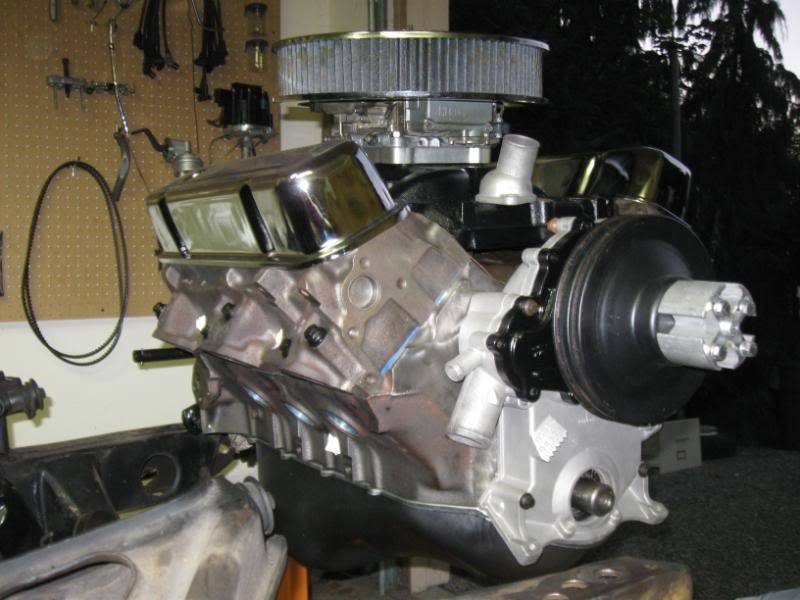

      rebuilt 400, .030 over. selling to my dad to fund my LS2/t-56

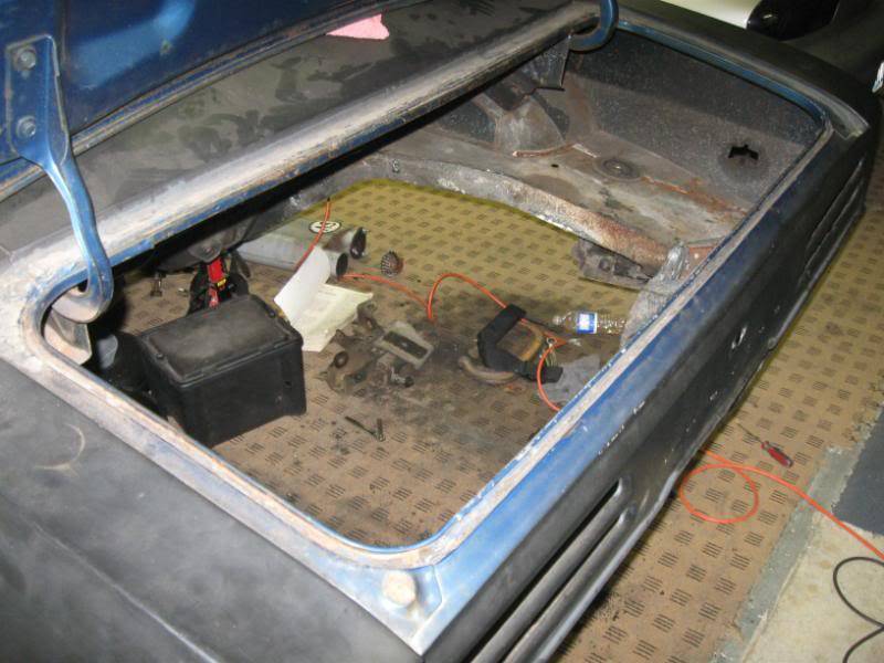

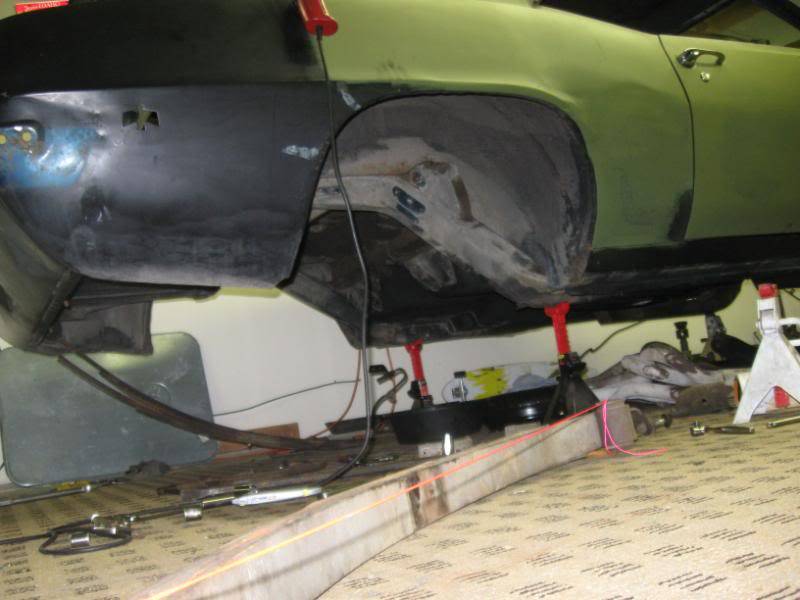

      rear end dropped and trunk cut out. ready for a 9in and 4link. trunk pan removed to skin it flush, for a drop in fuel cell
      started workin a a tubb last weekend. im gonna see how much frame rail i need to keep intact for the 4link, then cut the rear legs off and relocate them inboard to keep a full frame rail, unlike the dse's method, dont like the idea of cutting and filling in the notch.

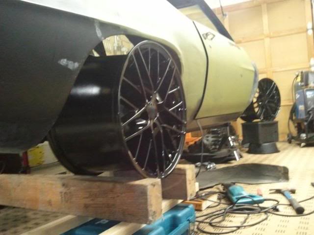

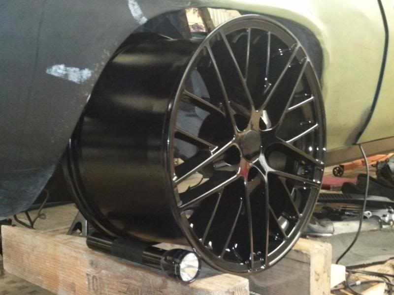

      bought my wheels today. C6 ZR1 18x9.5 and 19x12 wrapped with 275/35/18-345/30/19 michelin PS2s. adaptors in the front and custom width 9in makes up the difference in the rear.

      Tell your buddy to quit wasting time on that junk rotary and get a real motor,2JZ or LS.

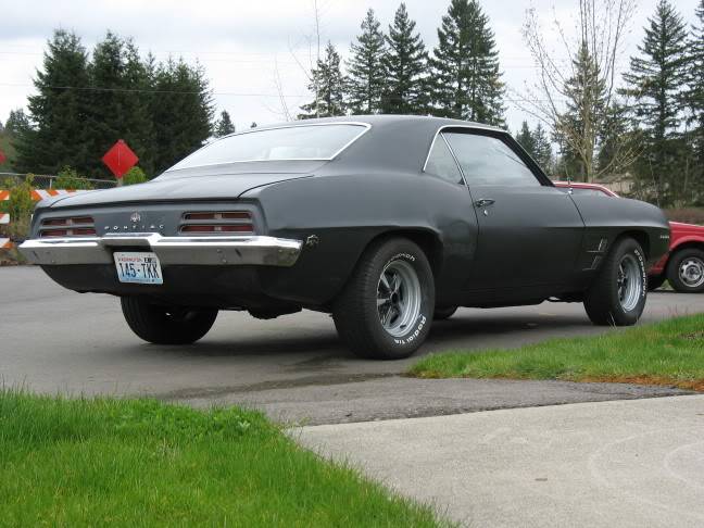

      shorttrack-hell yeah, its a cool car. so fun to drive, love how stock it is. we bought that to be my highschool car, hammerd, turns out he wanted to restore it for himself. so i got my firebird instead. stoked we got pontiacs. cant wait to smash on him when we go cruisin.

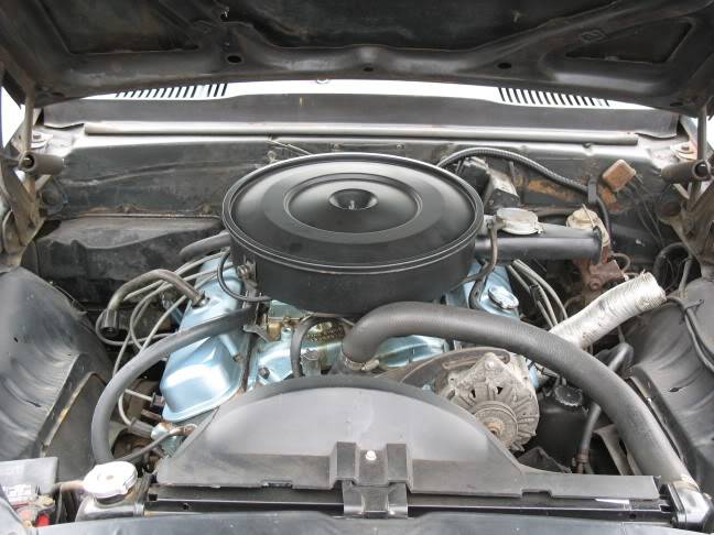

      old 350 two barrel came out and 400 in.

      Both cars in that garage need LSX power!!

      I love your choice of wheels, going to look great on that car.

      wow, people hatin on the rotary! I'll always be lusting for a RX-7, w/ a rotary as God intended. seriously, not EVERY car needs a LS swap!
      oh yeah, the firebird is cool too surprised no one has jumped on you for putting a 'chevy' engine in it, lolz...

      I just dont get what the deal is with wheel adaptors guess people like there wheels falling off.. Cool wheels tho just get the right size
      BUILD LINK
      Oct 2009
      Garland, Tx
      533
      there is nothing wrong with wheel adapters. They have been in use for a LONG time and have had plenty of real world testing.
      Easton, PA
      989
      wheel adapters are not the same as wheel spacers, which are dangerous.
      but IMHO I would just get wheels w/ the proper offset.

      i just think one should get the right backspacing for the car

      i havent heard anything bad about wheel adaptors, and no stories of wheels falling off. i saw nothing against them in the scca guidelines.

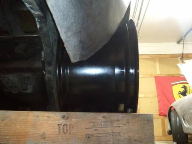

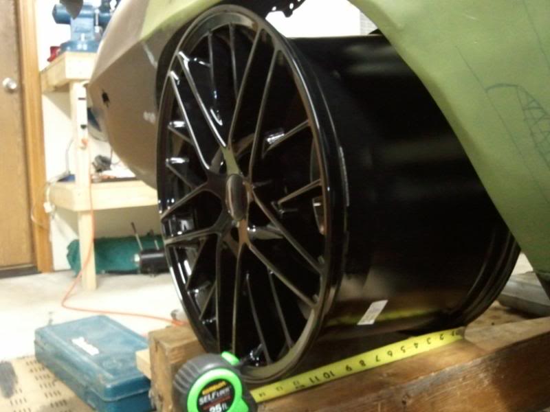

      well, these were the biggest, widest, wheels i could afford, that look ****in sick, without having customs made or spend mad change on a set. Love the positive offset, flush look.
      got the wheels tonight!!!!!
      Oh my, these are wide.

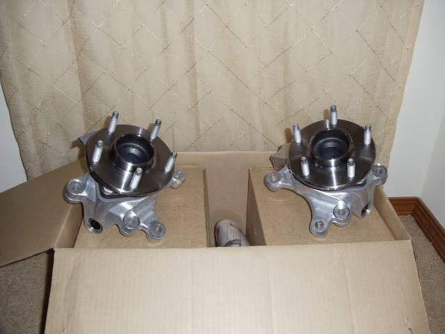

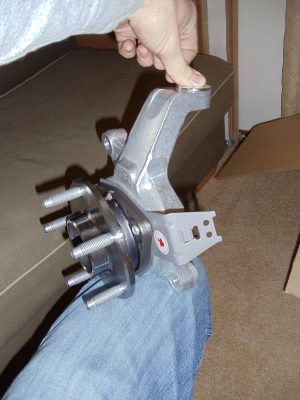

      ordered my AFX spindles yesterday with pro-lite arms from SC&C. Marks a G, cool guy to talk to.

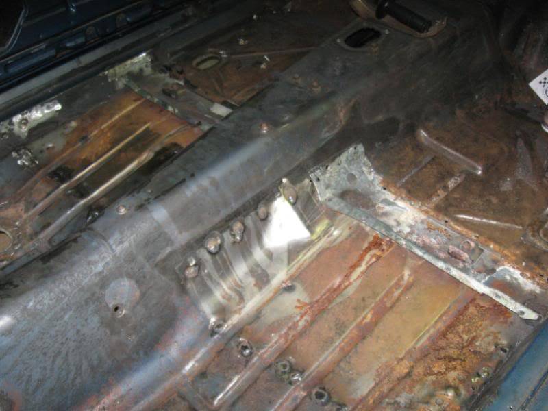

      finished up the drivers side floor pan frame mount/seat mount, need to align the brackets and finish the rear mounts to get my seats in.

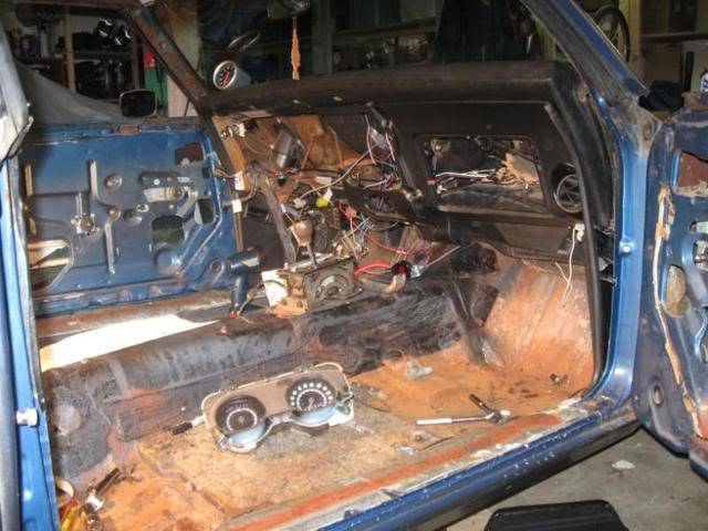

      cut out my dash, and got my heater delete started.

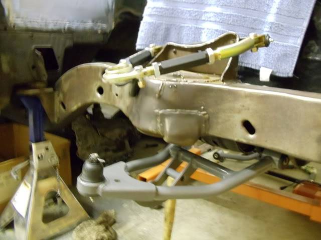

      as soon as i get working on my cage with the front down bars i can start mocking up my front coil overs. plan to cut out a half moon shape from the subframe and base the coil overs off the down bars.

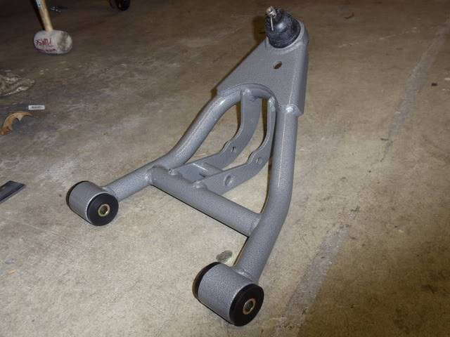

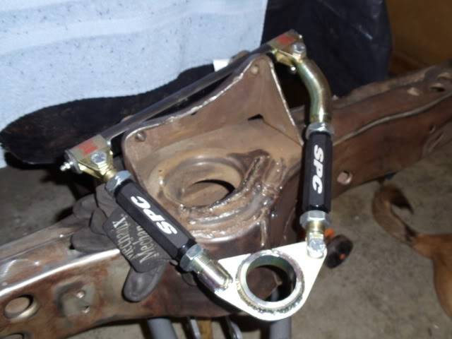

      spc uppers, chris alston coilover lowers

      yeah dom i was hoping my positive offsets would help me squeeze the irs in there. but nope, tires stick out an 1" beyond the fenders, according to my friends dads outside of tire-to-outside of tire measurement. still determined, and cant wait for this setup on the track.
