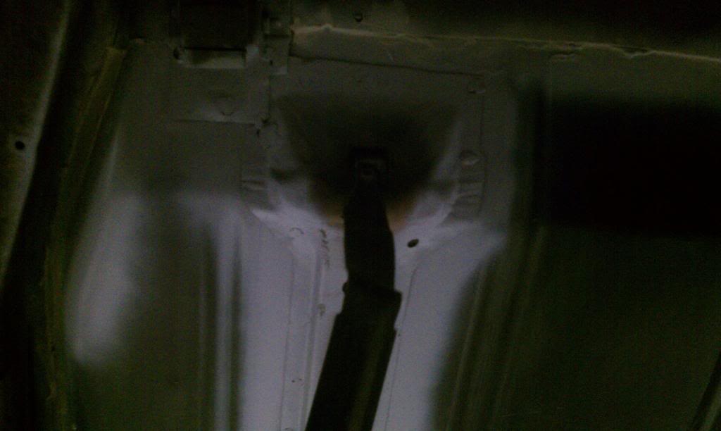

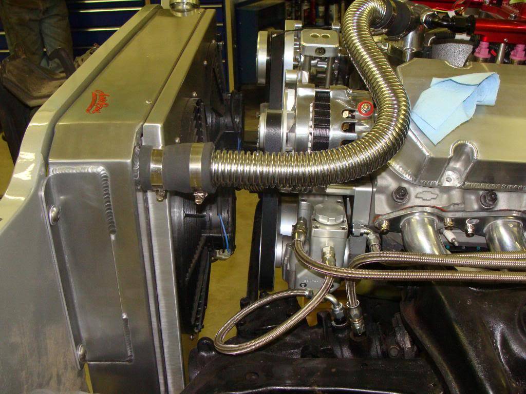

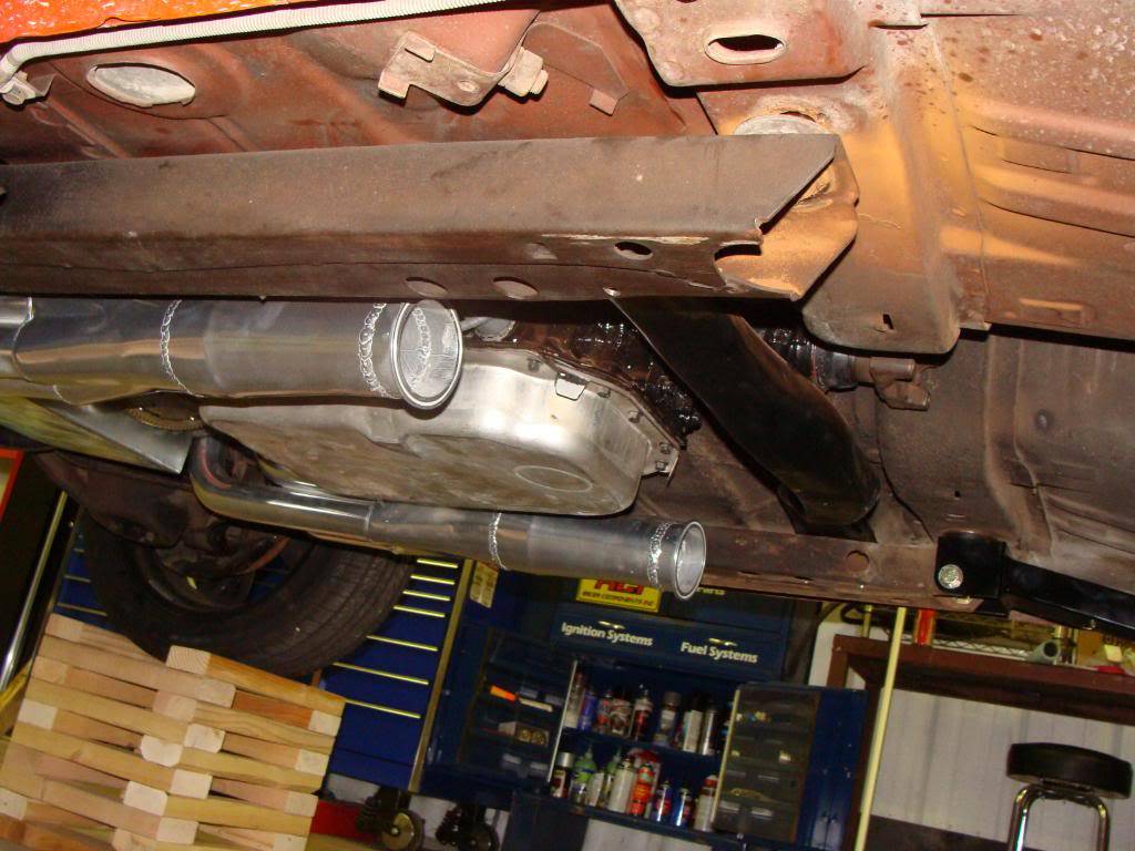

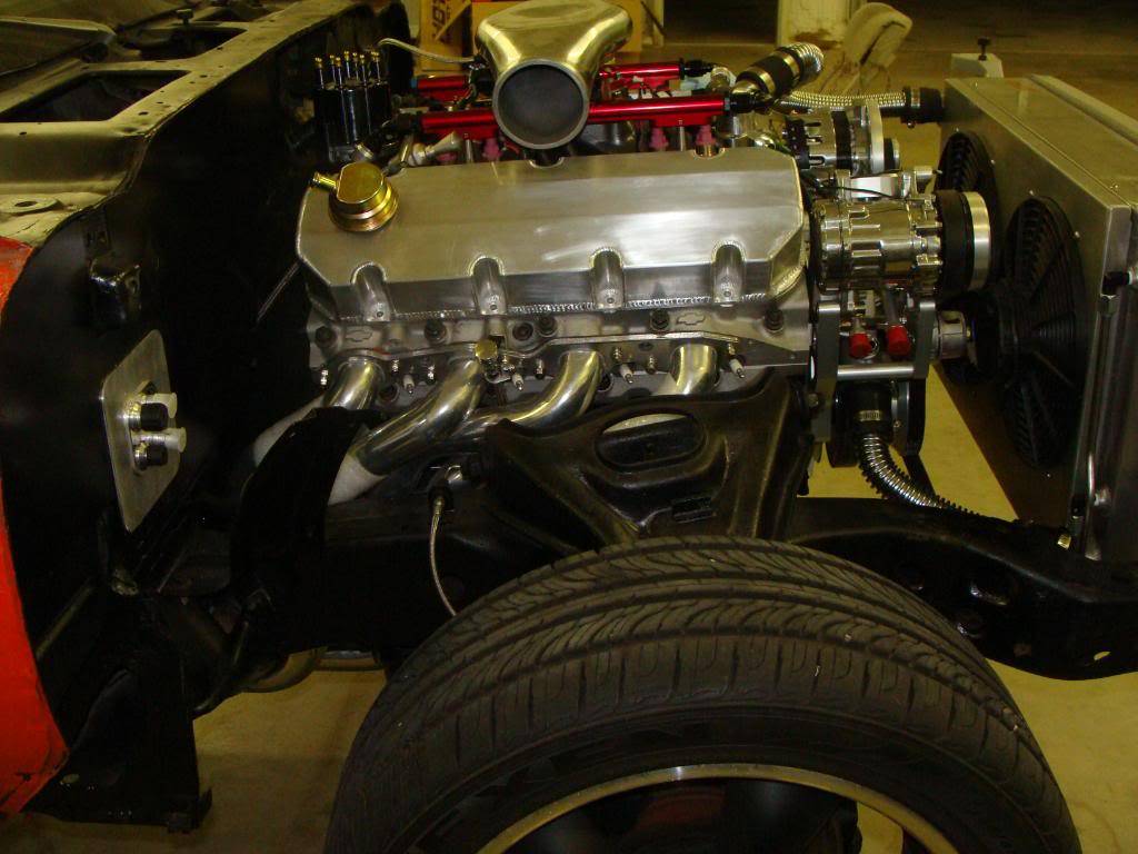

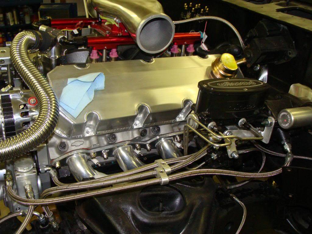

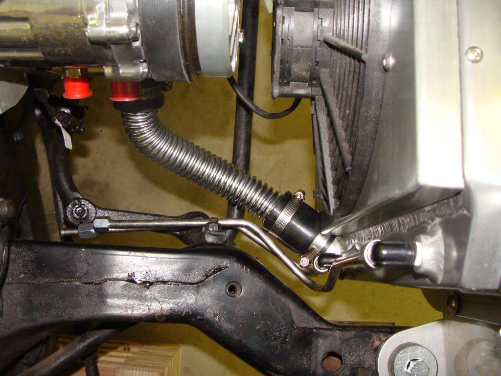

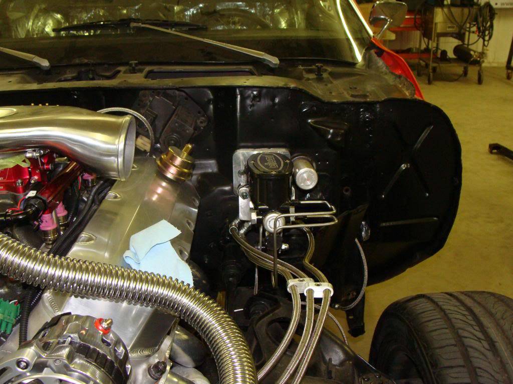

      Its been a while and progress has been steady but work on alot of the little things...
      I have started on the stainless tranny lines in this pic (they are actually done now)

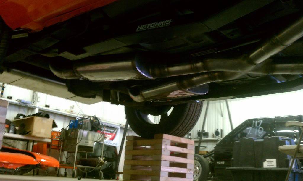

      got the headers on here they were actually a good fit for being the run of the mill HOOKER, I had jethot coat them
      From here you can see the mod I did at the collector, I reduced the collector from 3-1/2" to 3" and I am using V-clamps to connect the exhaust I will use them just behind the mufflers too so I can easily remove the exhaust if need be.
      Here are some pics of my Hydroboost and plumbing (Its my first time on alot of this stuff)
      Thanks for looking guys. I have more done but no pics yet...will bring the camera out to the shop tonite.

      Gene, I figured you had SCFs in mind since you plan to make some power....where are you mounting the procharger? I'm guessing over on the driver's side somewhere since the hat is aimed in that direction.
    11. #31
      Mar 2010
      Clovis NM, 88101
      329
      John is right, the kit is a 496 stroker but the block is only bored .030. An .060 overbore is needed to get the full 496 cubic inches. I am hoping for about 550 flywheel horsepower from the combo without supercharger and 1000 horse with the supercharger. John, to be honest the supercharger is on hold. I am chomping at the bit to drive the car and to be TOTALLY honest I would rather dump the $5K the supercharger would cost on finishing out the suspension. Only one problem with that thought...where am I going to get the $5k, LOL!!

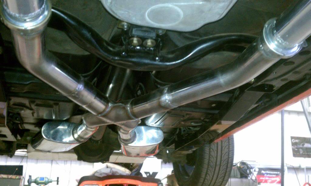

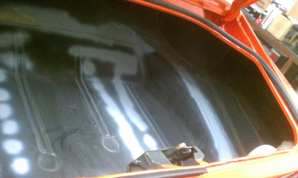

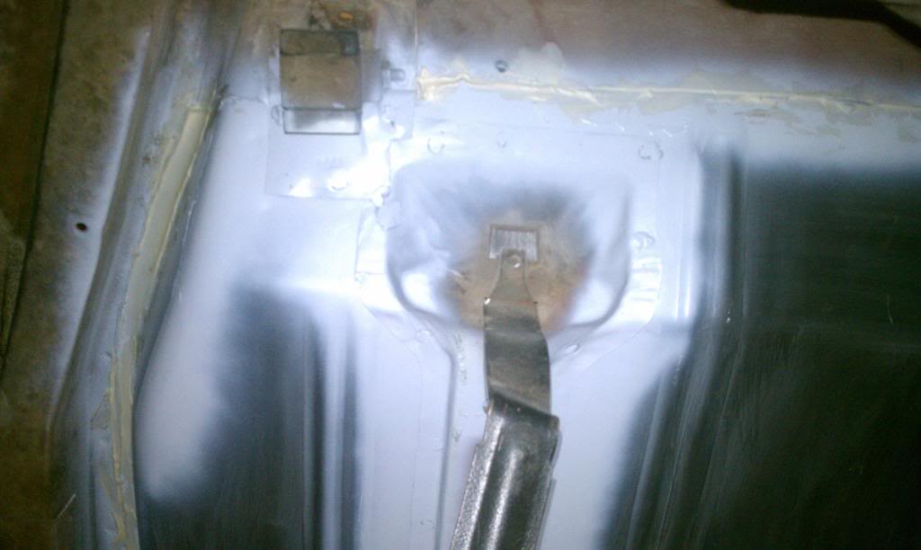

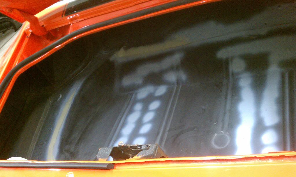

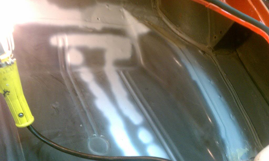

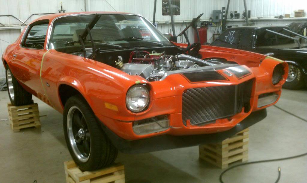

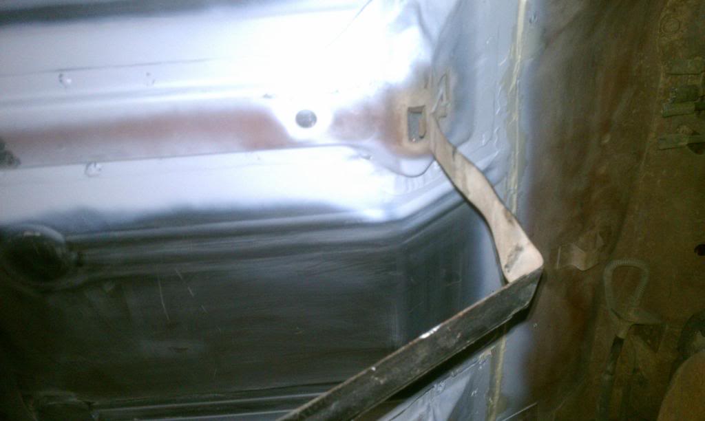

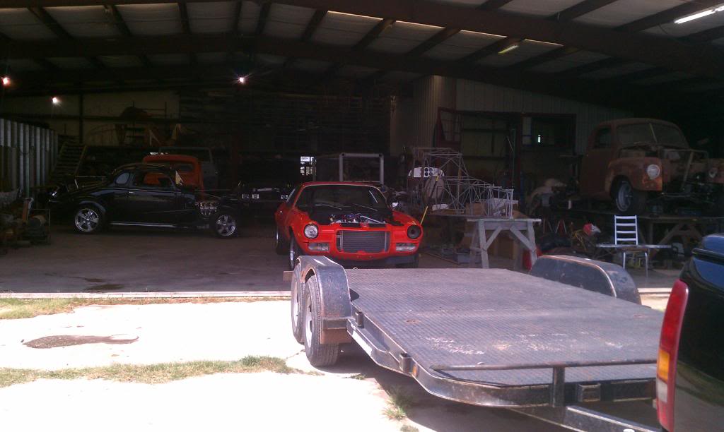

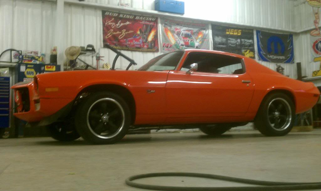

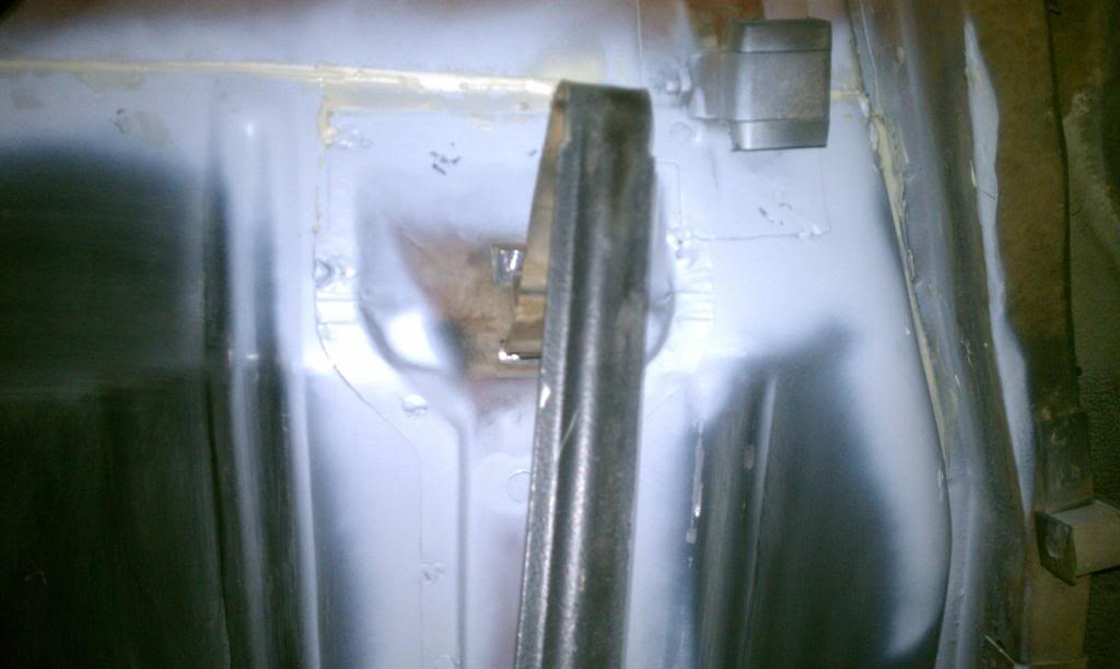

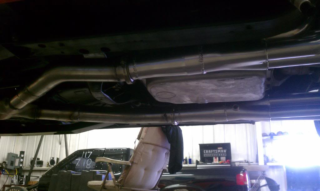

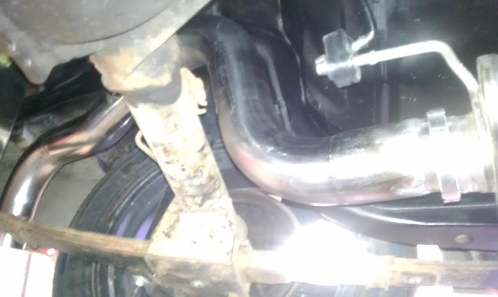

      Well guys I am back with an update. We just arrived home last night from dropping of the Camaro at Mike Redpaths shop(Musclerodz) and I thought I would bring the build thread up to date. Mike is going to finish out the wiring and get the car running/tuned. I don't know much about wiring and integrating the fuel injection, fuel management and electronic trans together seamlessly and that is why it was sent to Mike. I did get the exhaust done, drive shaft in, transmission lines complete and fuel lines done (all in stainless). The trunk was rusty so I cut out the old and replaced with a new pan. Not a body man but got it complete. Its not the finest of installs but then again its not being built for a show car either. Enjoy the pics.
      The rear end isn't cleaned up because it is on the list of things to upgrade
      I think the car needs to come down about 2" in front and 1" in the back, what do you guys think?
      And lastly, here it is fresh off the trailer at Mikes shop.
      73 Camaro

      Car looks great. I agree that it would look a little bit better if it can come down a little in the front and back.
