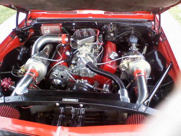

      I measure intakes last night and it looks like I will gain every bit of 1.5 inches probably closer to 2. I have an EV hat on the way and I also have a 5" Brute flow with a 4" inlet. The Brute flow is suppose to be a really good hat. After speaking with Kevin at CSU he told me that changing from my short turbonetics hat would make probably 30 to 45 more hp. He said with the the turbonetics hat that my AFR would never be any good and that the way that one is designed that it would reak havoc on my carb and engine. I am really hoping I can squeeze the 5" hat in, if not I might try to shave some off of it to get it to fit. I know the EV hat will its a little less than 4". As you see my charge pipe comes in from the side. Since you seem to be a bit more experienced than I what do you think? Do you think it is fine?Name:  motor shot.jpg

      On my CSU hat, we ended up welding about a 1/2" on the back side to bring the front to point down. And I don't think that it affected it in any negative way. It looks like yours should be fine....but I don't have any experience with a carb blowing from the side, but I have seen some drag cars that way.
