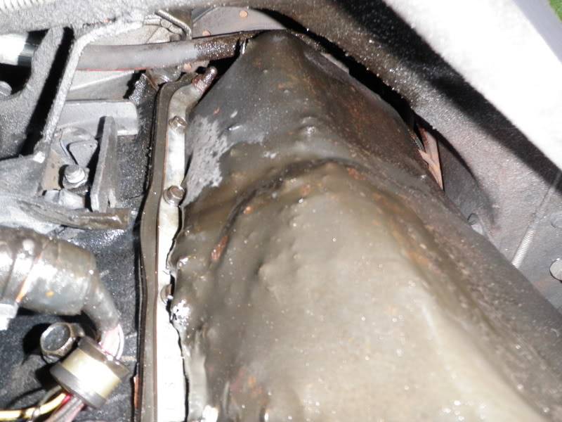

      so yesterday night i was at adams motorsports track in riverside for their grip driving tuesday nights. I was racing my 69 camaro with a mildly modded LT1 and t56.
      It started out well as i beat my buddy in his 08 STi. This is particularly impressive as his engine isnt stock. hes running a stroker kit that brings him to 2.7L and is running 24 lbs of boost. plus long tube header, exhaust, intake the whole 9 yards.
      but he still wins overall as his car is still ALIVE.
      Mine not so much. I blew a rod out the side of my oil pan. My gf was in the car filming so when i get the vid from her ill post it. This is the first time ive ever blown up and engine and im not to stoked on it. Im waaaay to poor of a college student for this to work.
      But im planning on rebuilding the LT1 with forged internals and lower end and stroking her out to a 383 while im at it. Ill be posting in the engine section if anyone has any knowledge or good advice about either LT1s of 383.

      what ive found thus far.
      more pics once i open her up

      Ok, first off, solly for the loss. Racing costs money, but this type of expense is not a good one VS some expense due to power adders. But it happens so yer not alone.
      Now, looks like the rod whipped around a few times before it holed the pan, the pan took some hard knocks before it gave up. Did you solid the track pretty bad? They hate that.
      Carnage pics!!! We love them. Not so much because it looks good (although carnage pics do give a sense of the awesome destructive power that was present). But just to see what failed and how the rest of the lower parts were effected (besides the pan and the rod).
      You might not be in too bad of a condition. One, maybe two rods, a rebuild set of bearings, a pan. Hope it didnt crack the blocks pan rail. But as much damage that was done to the pan (for and aft) looks like the broken part was loose and did some free flying around the bottom of the pan before it got holed. So that would be the cap flying around in the pan area before the pan got holed. If it didnt wedge itself into the other rods and just got bounced around then thats a good thing, if you can even think of any of it as a good thing. Ive seen some engines where the cap got flipped up into other rods and ruined them also including cracking the web.
      Bummer the rod or cap let go. Curious to see if you will be able to determine if it was the cap, rod bolts, nuts or rod that gave up. JR

      That just happened to me last May. It's part of the deal- if you race long enough, you'll grenade an engine.
      If you want to get back on the road right away, buy a running stock engine and just swap it out. If you want to upgrade, now is the time...but plan on sacrificing the summer's events to do it. Rebuilds take more time and money than they should, but it's necessary evil. If you're as broke as you say, get a stone stock engine back in there and keep the car on the road until you can afford to build another engine outside the car (maybe starting with what parts you can salvage off this one, like the heads/intake). Once the 'new' engine is done, swap it out and sell the stocker to get some cash back.
      Worst case scenario- you pull the engine for a rebuild and the car sits for more than a year while you wait on the machine shop and save up the dough to pay for it all. When mine went, it took out 2 rods and the block and the cam got bent. They don't make those rods anymore, so I was into it for 8 rods, 8 pistons, a new block, new cam, and all the machine work required on the new/old block. The heads were damaged, but repairable, and I bent a few valves so I got a fresh set of those, too. Of course, a new oil pan, pump, and pickup were also needed. Even being able to re-use my heads, crank, intake/carb, distributor, etc... I was still out over 5K and the car was off the road for 5 mos (all last summer from May-Sept). And I had the cash!
