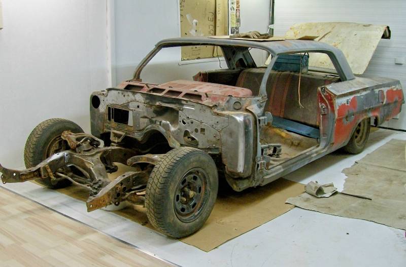

      thought I´d put up a build thread of my beat up 62 Impala,the car has been hit hard on the drivers side in an accident many years ago,and at some point someone thought it would be a great idea to make a "new body" for it out of bondoand when the bondo started to crack and fall off,someone decided to strip it down and do a resto,to make a long story short,that failed and the car became a donor car.and that´s were I came in to the picture,I traded some free stuff I had for the carcass,and dragged it home,it´s missing all glass,all crome,all interior,drivetrain,well,you get the picture.
      the body needs new rockers,new floors,right qrtr panel,new trunklid and hood,and I allready got a fresh driversdoor and driverside fender for it.
      plans were vague for starters,but when I found a 2002 8.1 litre vortec engine,the plan started to form,I soon realized that the oem frontsuspension needed everything replaced and uppgraded,I got a 86 c4 z51 frontend off ebay,and got it shipped to sweden.
      that´s about were I´m at,I also ordered some wheels for it,but they won´t be here until mid/late Jan.
      now on to some pic´s off my Impalaish pile of wrinkled steel
      after second nite scraping and cursing

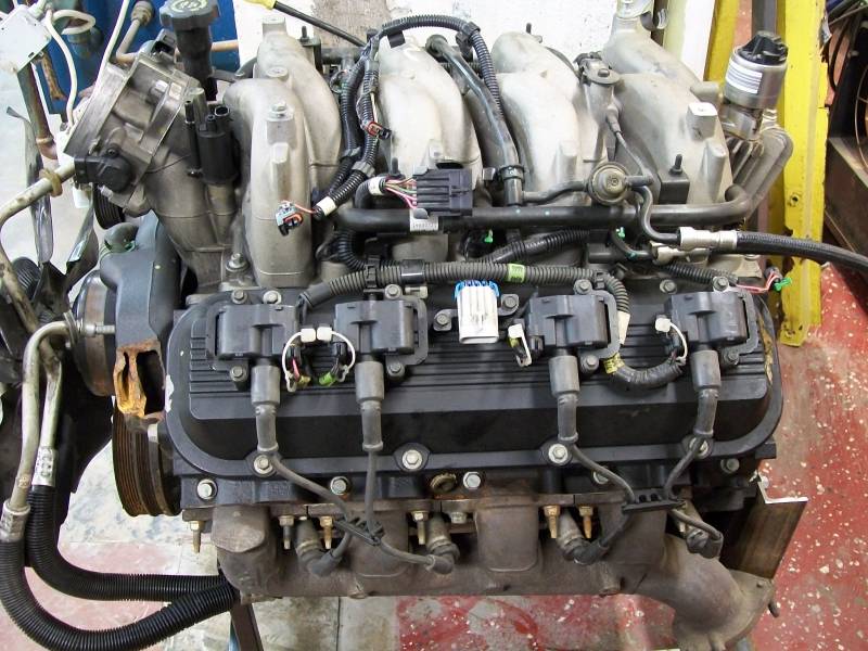

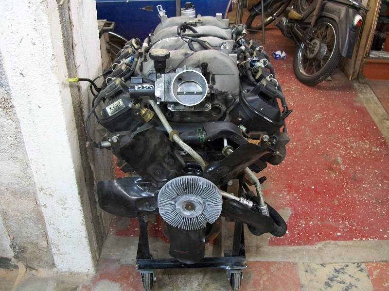

      engine fresh out the junkyard low mileage out off a wrecked ambulance
      cracked watercrossover,I will probably fabricate a new one out of aluminum,need to shave every possible ounce of this beast

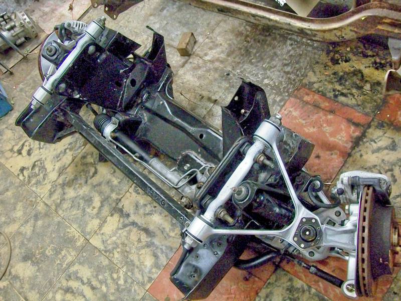

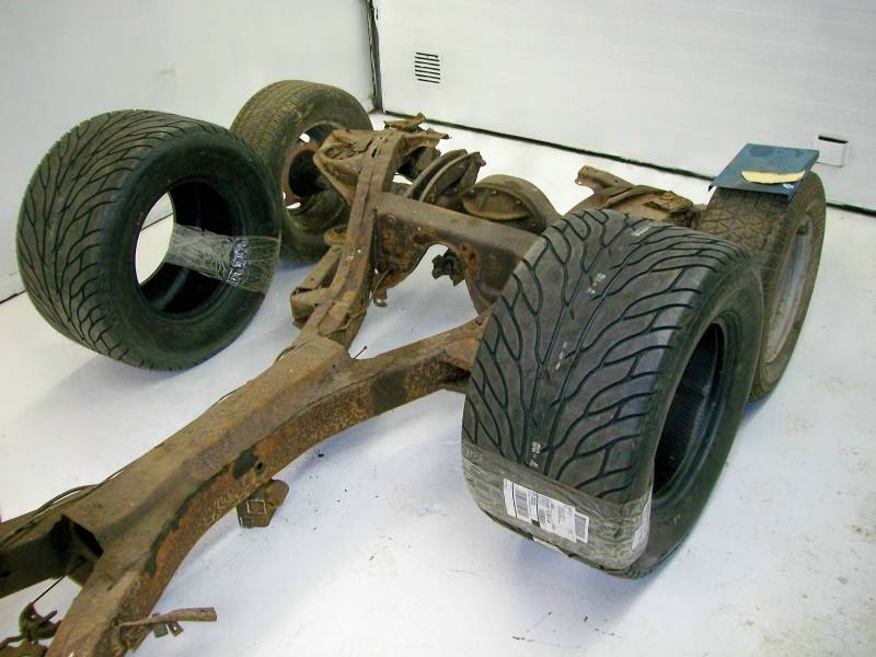

      z51 frontend still wearing the old framerails
      mocked up at desired ride height,give or take 1/2"
      well,not much going on here yet,need to fixate the frame square and level to the floor before I start cutting.

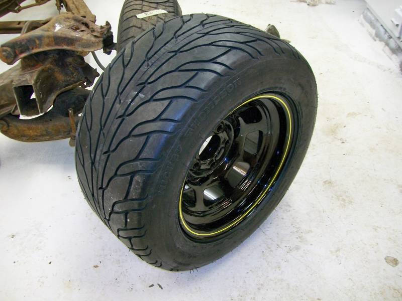

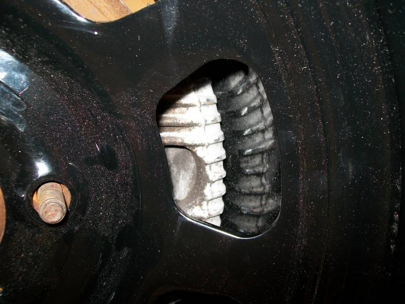

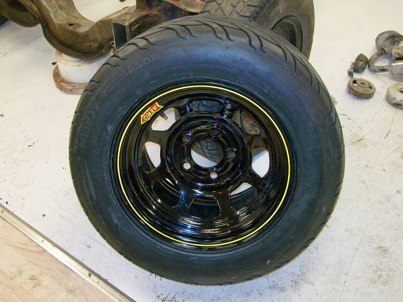

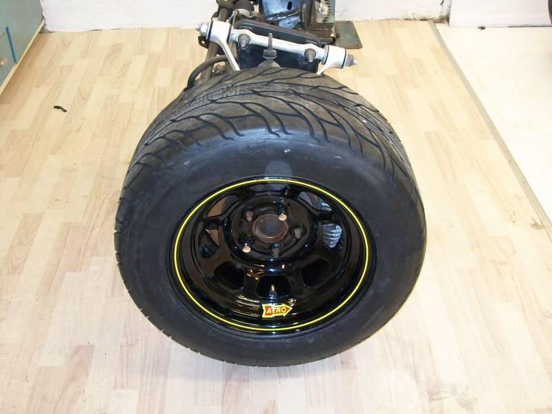

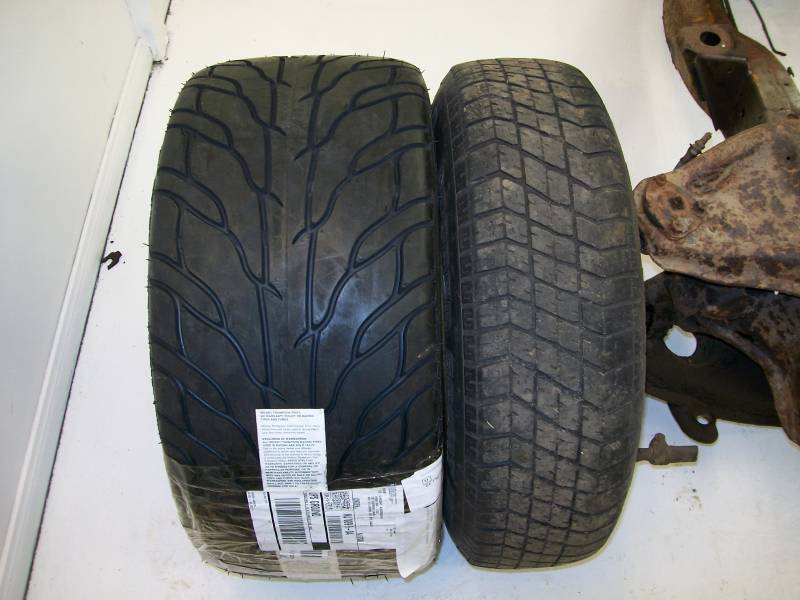

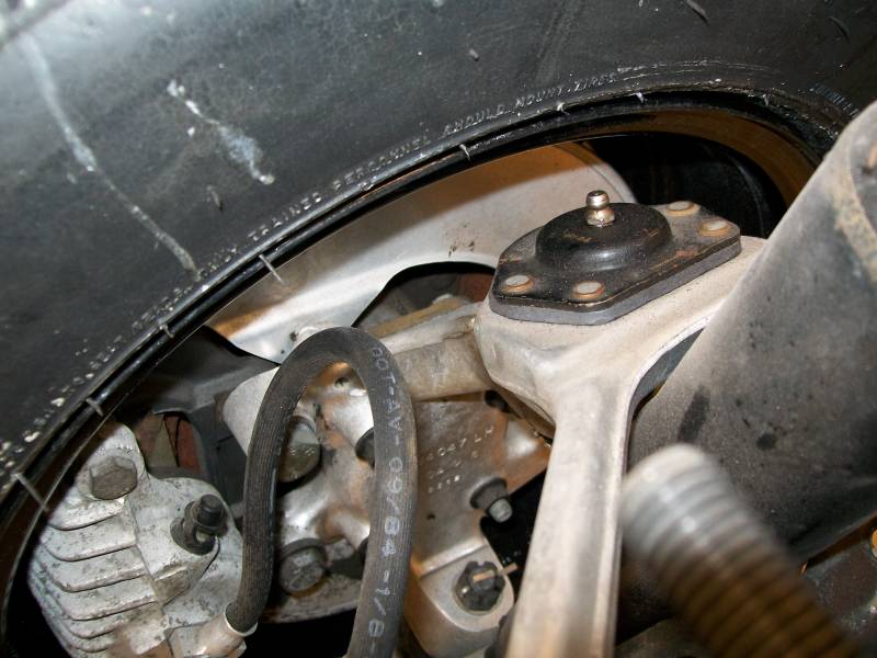

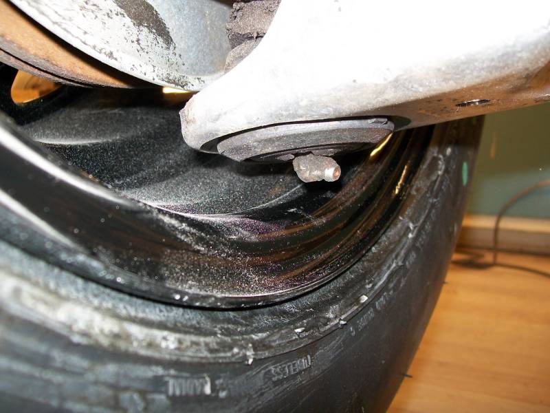

      a little more info:the wheels I ordered are aero racing wheels series 50,in gloss black,10x15" fronts,12x15" rears,also ordered tires;m/t sportsman s/r,12x26x15 fronts,15x29x15 rears,a little to much sidewall for a cornering monster,but I just had to have the nascar wheels!,as for clearance of the front suspension with a 10" wide 15" wheel,I will have to tweak the caliper some,and remove the greasefitting on the lower balljoint.

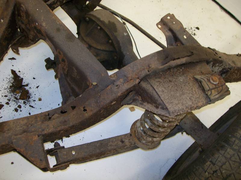

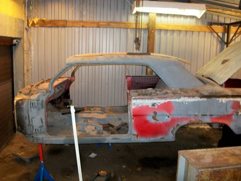

      got the body off,and the frame back inside.
      rear part of frame is toast,but I planned on making new rails out back anyway.
      body out in the cold...
      cleaned up the garage,and cut off the frame horns,next is drilling the floor for some fix points.

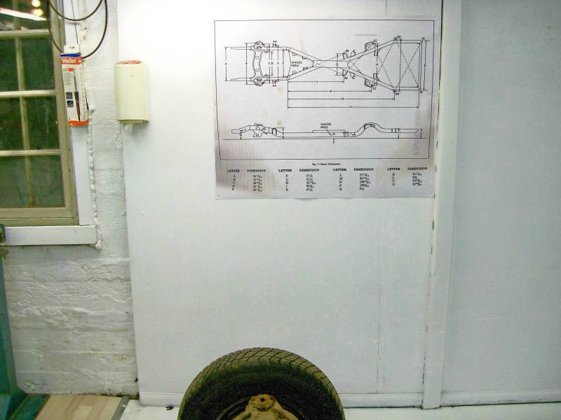

      got this up on my wall today,it´s from the 1961-62 gm shopmanual,blown up to a decent size and laminated to last a long time.it was expensive though...
      but it will save lots of time,as I don´t need to move away from what I´m doing to check the drawing.

      well,today my front wheels and 4 tires showed up from summit,and,sadly,both rims were dameged due to poor packaging from the manufacturer,one rim was pretty scrathed up,and the other one even bent slightly,and it was repacked at summit(said so on the sticker)so they saw the bent rim,and repacked and sent out,NOT what I expected from summit,been in touch with customer service already,and I will post up the result here,I really hope they solve this in a nice and timely manner,I don´t want my project to be held up another month waiting for new rims to arrive with sea freight.

      soo...summitracing blames the shipper,even though it´s obvious that the damage occured before the boxes were packed together as one unit(no damage on the summit stickers etc) so this looks like it will turn in to a nightmare,I wish I photographed the pallet before I opened it up,damn...

      well,trying to see beyond the damaged parts,and test fit and plan the rest of the build.
