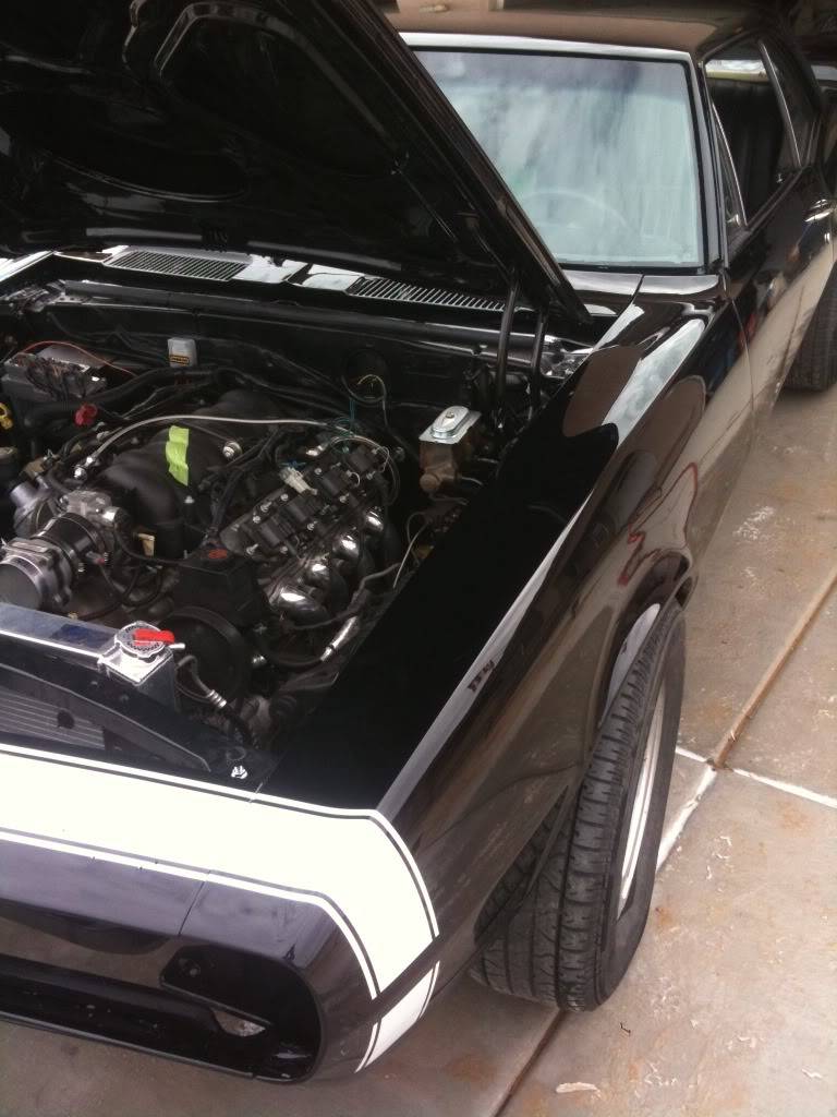

      Made some progress on the car today.
      Installed the front grill and wired the lights. Lights are H4 with relays.
      My $20 Pomona swap meet intake that I cut up to fit.
      And my Dakota Digital gauges
      I also managed to snag a Hotchkis rear swaybar and front springs that were mounted and removed. Only $200 @ Pomona good deal since this is the new one with the end links

      Charlotte
      1,295
      Tranzgenic Intake?

      I like the low profile tire in that top pic!
