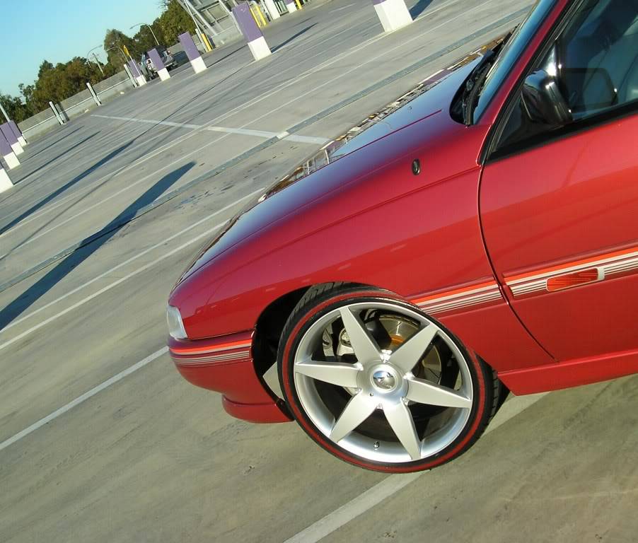

      And a couple of pics before I started the rebuild.

      20's on that car are not in my taste, but it's cool to see some variety with an Aussie car

      It had 19s on it before so 20s is only one step up. If you're not rolling on 20s in aus you don't even get a second look. Stupid I know but it's the way it is.
