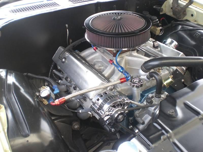

      My bad... I was referring to the "J" hose as seen on the below Oldsmobile engine, which allows coolant to skip the T-Stat AND the radiator. This allows flow to prevent hot spots even when the T-Stat is closed. I had a major brain fart, and totally forgot that it bypasses the radiator too, duhhh... I was excited that I might have a solution for you guys, thinking the bypass skips the T-Stat but still flows thru the radiator. False.
