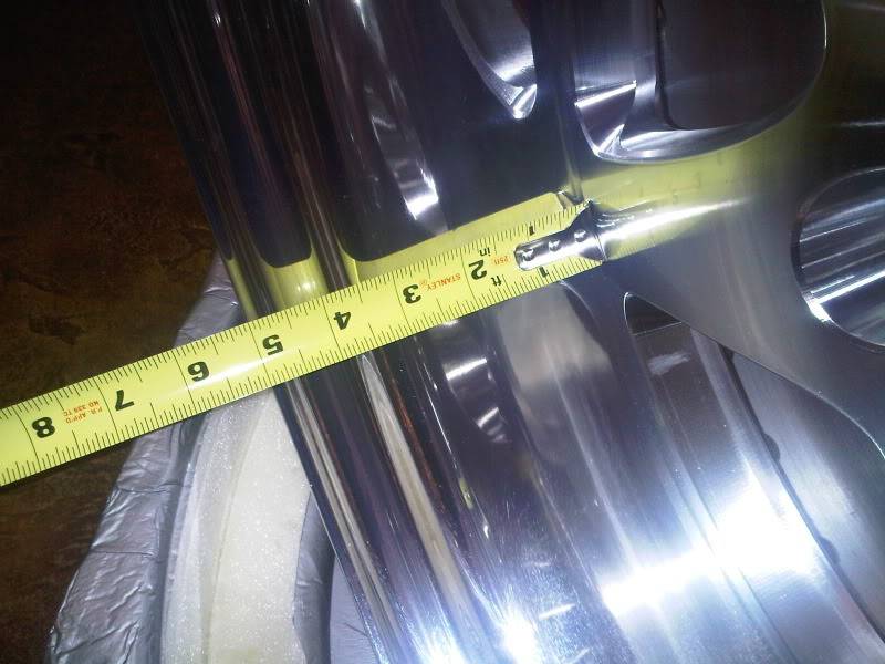

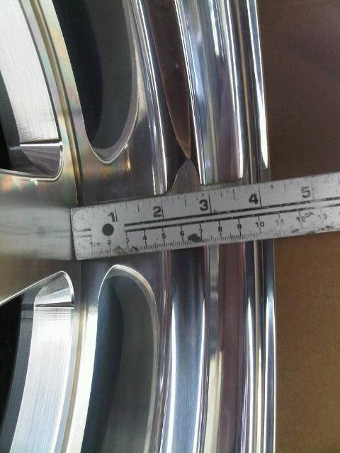

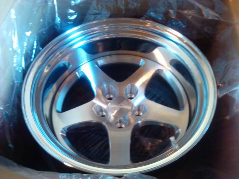

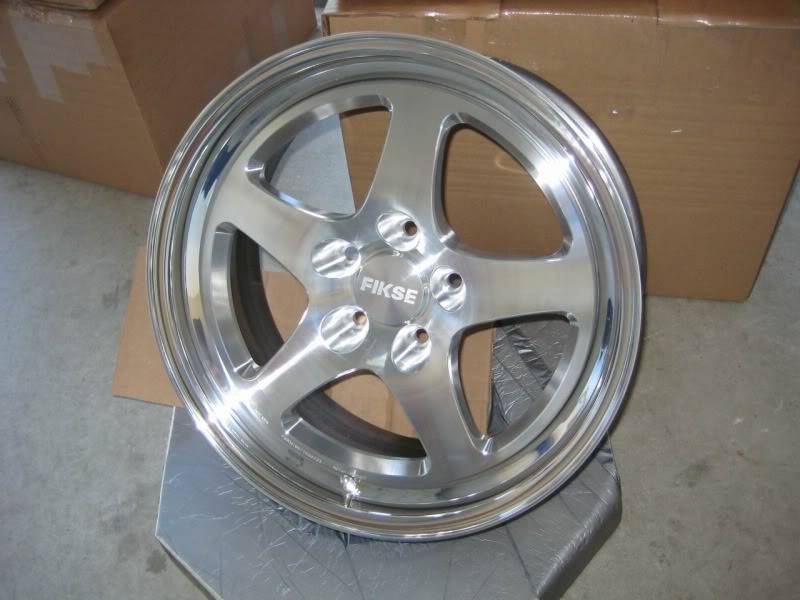

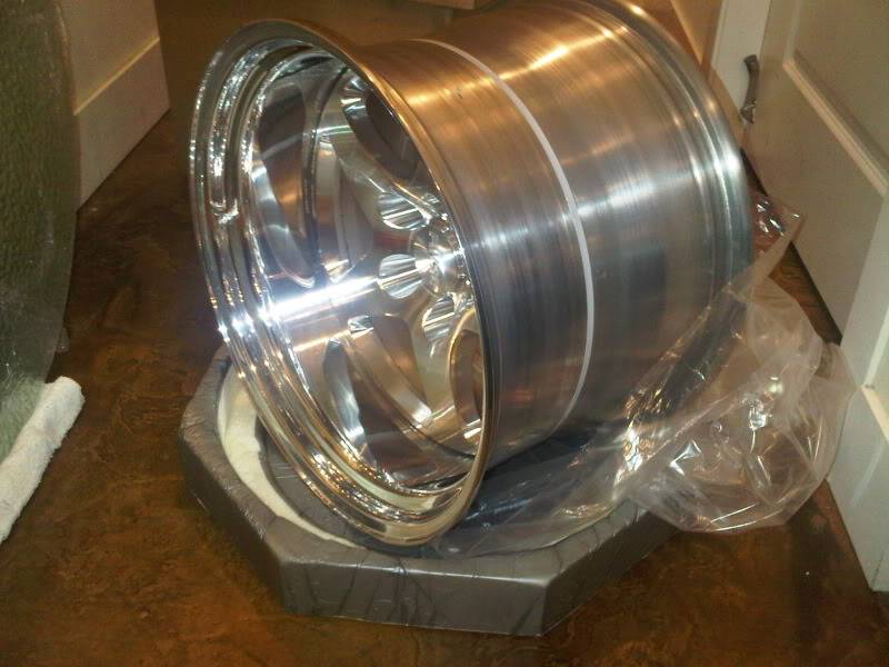

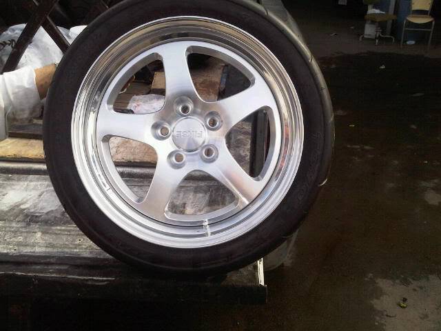

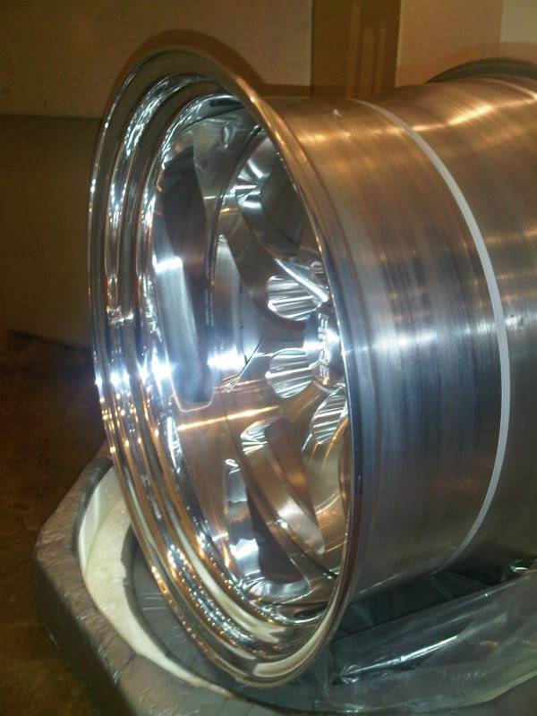

      These are pics of the wheels when I first got them. I originally ordered 6.375" BS on the rears. And when I got them I just wasn't happy, I wanted a deeper lip. So I contacted the Rep Danny Gol and we made a deal to re-hoop the rears to 5.375" BS. This took a few months as well. Fikse is a little slow, but they were very good to deal with and they are local to me now under new ownership.
      Anyways, onto some pics.
      18 x 12 6.375" BS
      18 x 8.5's
      With Toyo R888 Rubber.
      245-40-18 fronts
      335-30-18 Rears

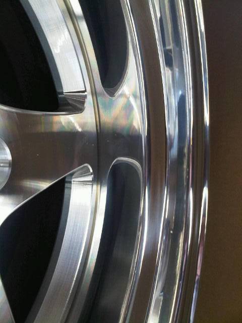

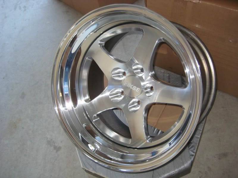

      So after I had the wheels Re-hooped to 5.375" BS they now look like this:

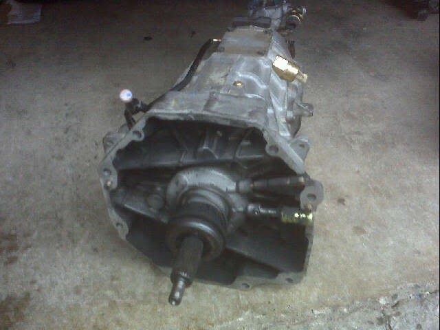

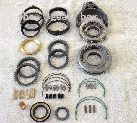

      While he had the car, he had a tranny shop listen to the noise, well the owner convinced him it was the tranny for sure. So he ended up pulling the Tranny and we had it rebuilt with the Stage II kit from The Gearbox Co: 600-650 hp capacity
      http://www.thegearbox.org/catalog/it...17/7824166.htm
      Once the Tranny was pulled apart it ended up needed new 5th, 6th and reverse gears and sychros.
      I also ended up going with a brand new Spec Stage 3+ Clutch. 900+ ft lbs capacity
      All in all, cost me about $2k to rebuild the tranny and clutch. But it now feels very solid, the new clutch engages really nice but the damn noise still persists.

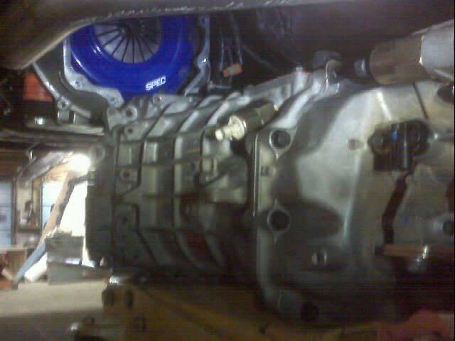

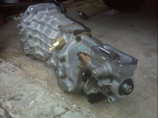

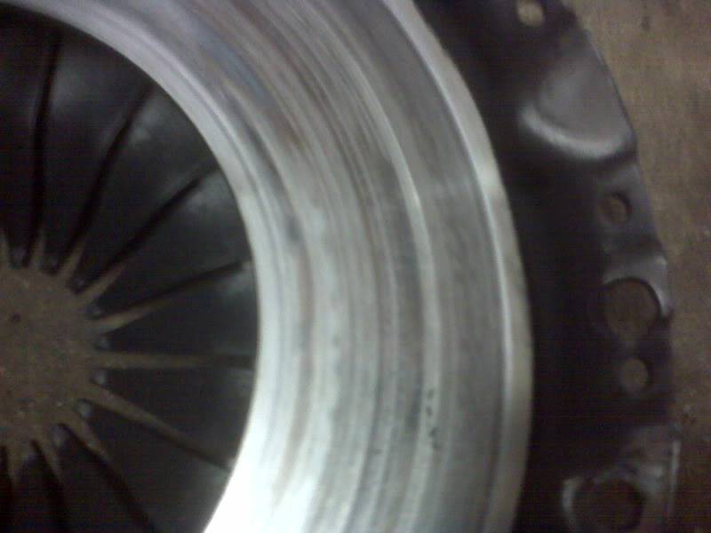

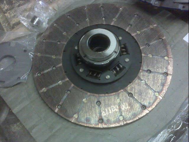

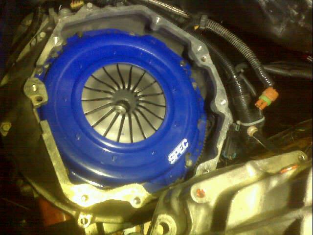

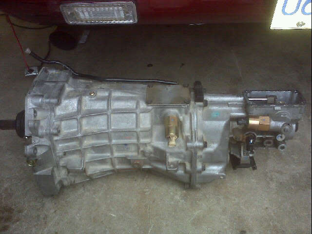

      Some pics of the Tranny and clutch, sorry crappy phone pics:
      Tranny pulled:
      Old Spec Stage 3:
      New Spec Stage 3+ cluch disc:
      Stage II tranny rebuilt and going back in:

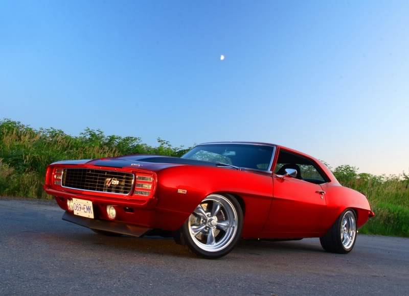

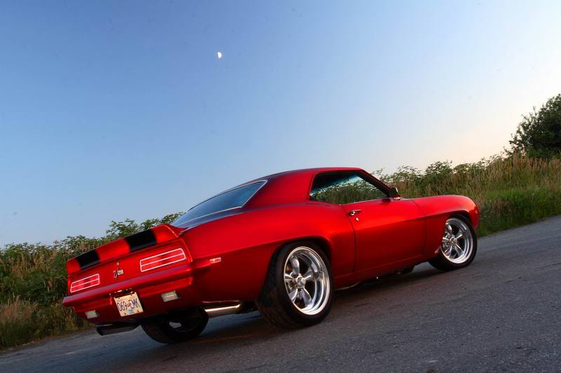

      My leaf springed, non-tubbed Torque Thrust II wheeled Camaro as it is before the mods.
