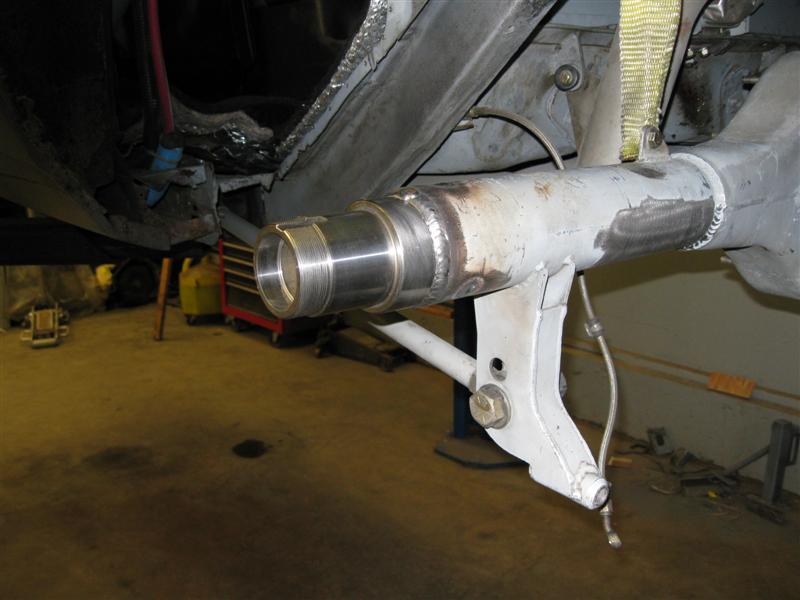

      In theory, if you pull the center cap off the wheel, although I'm guessing most cars with floaters aren't running center caps, you will be able to see (and unscrew) a cap on the drive plate which is cut to accommodate the splined axle.
      Here is a picture of a floater without the wheels attached, or the axles in.
      Does that make anymore sense?
