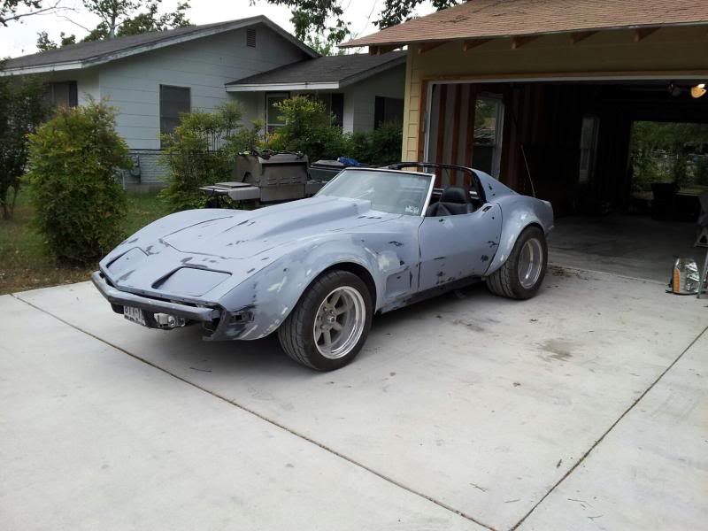

      Nice Vette... I spy a G8!
      Did you do build a garage at the same time as the car?
      It looks like it went from rough framing to drywall and doors!
      Pass through garage on the left side with doors on both sides?

      The garage that was being built was my dads, the current photo are of my house the i bought in September.
      And yeahs its a 09 g8 gt SMR

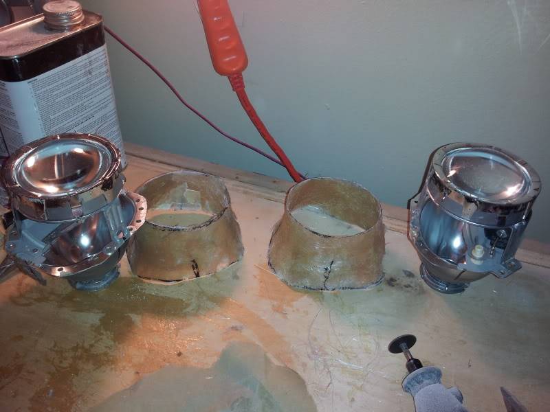

      Thanks for the compliments.
      so far this is what i have for the lights, ill work on them more tomorrow after work
      I am trying to make a housing that will keep the the insides dry so moisture don't ruin the bulb.

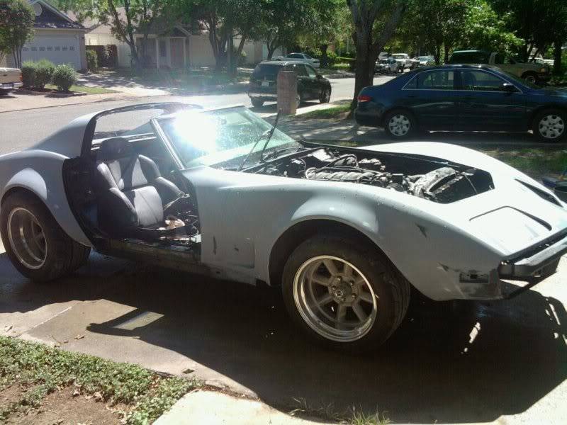

      Quote Originally Posted by sokoloka View Post
      How'd you hook the sidepipes up to the LS? I have the Hooker pipes for SBC's, but the headers don't even come close to mating up with the LS.
      Can't wait to see your's finished.
      No love for the sidepipe question?
      Eric- I believe his are custom... no one makes LS sidepipe headers yet. I think Josh at custom image was planning on making some but I havent seen any production ones.
      Look into the big block hooker sidepipe headers. The primaries will be closer to the LS flange compared to the SBC headers
      sorry man i over looked your questions,
      i am running hedman block hugger headers with a 3" collector into 90* pointing out to the side then a 3" to 4" reducer into a 4" 90* in to the chrome 4inch pipe

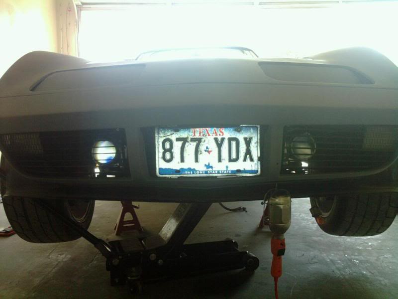

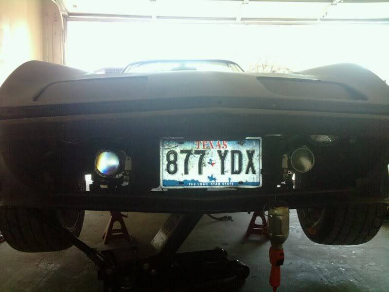

      Mounted Escalade hid projectors

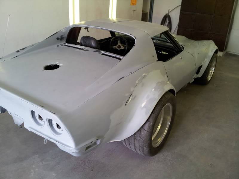

      Getting close to the end
      Off to the paint booth

      Looking bad-ass!
    12. #32
      Aug 2010
      52
      Quote Originally Posted by outragis View Post
      Looking bad-ass!
      Thank You, I hope to have her back in a month.

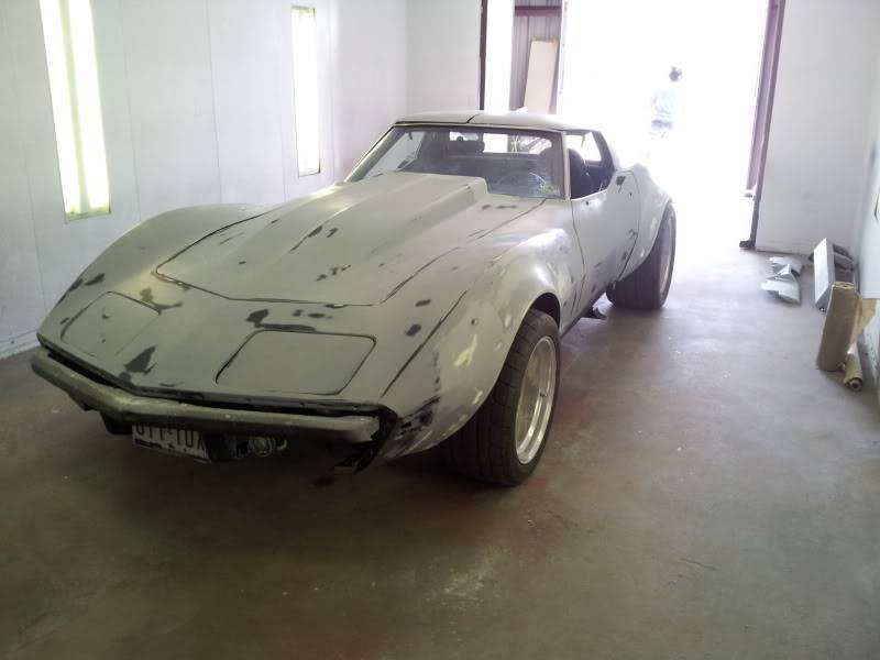

    13. #33
      Aug 2010
      52

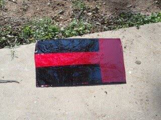

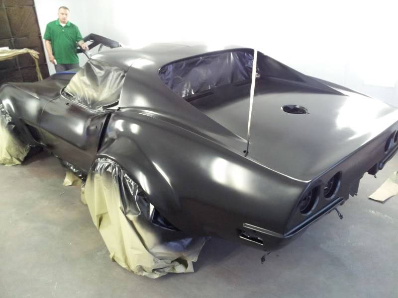

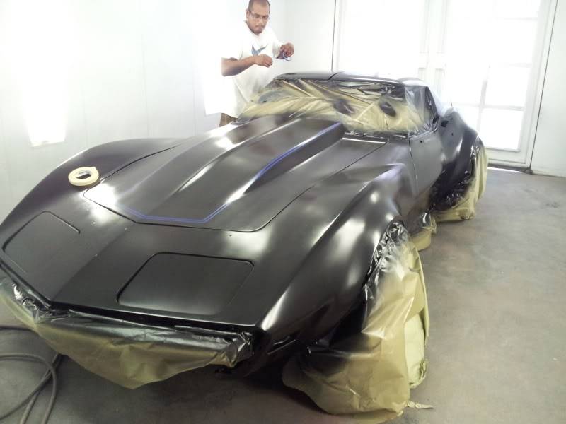

      The Body finally is finished. Should be going into the booth in 2 weeks.
      Here is a glimpse of what the colors will look like against each other.

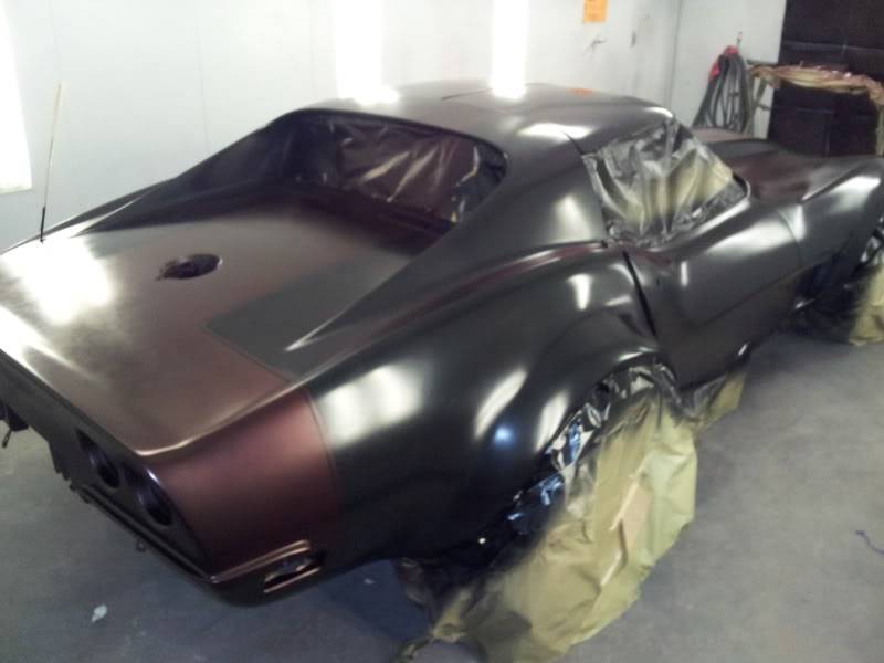

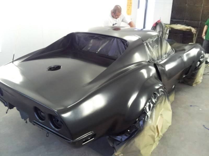

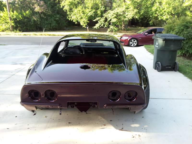

    14. #34
      Aug 2010
      52

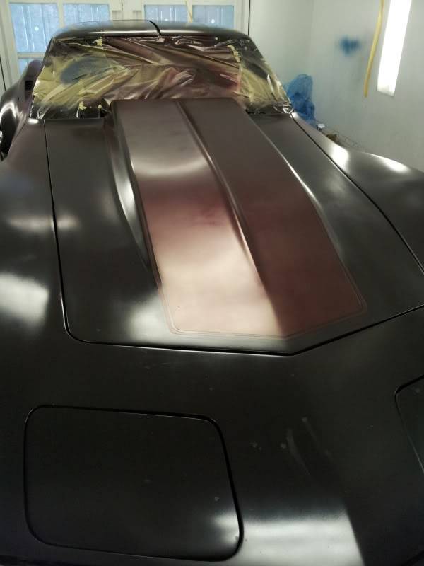

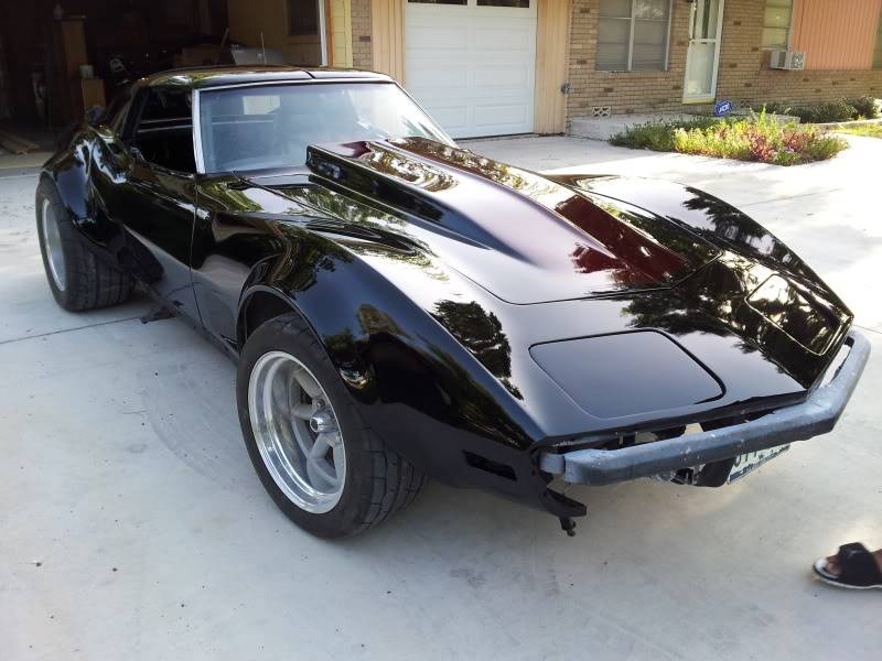

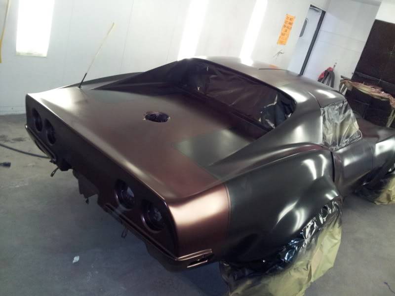

      Paint is done, just need to cut and buff next weekend, spend about 9 hours in the booth yesterday.

      Thats some nice work flaring that thing. Also love the 48's( as I ve heard those wheels are called) Gives it a nostalgic trans am race look. What part of Texas are you from?
