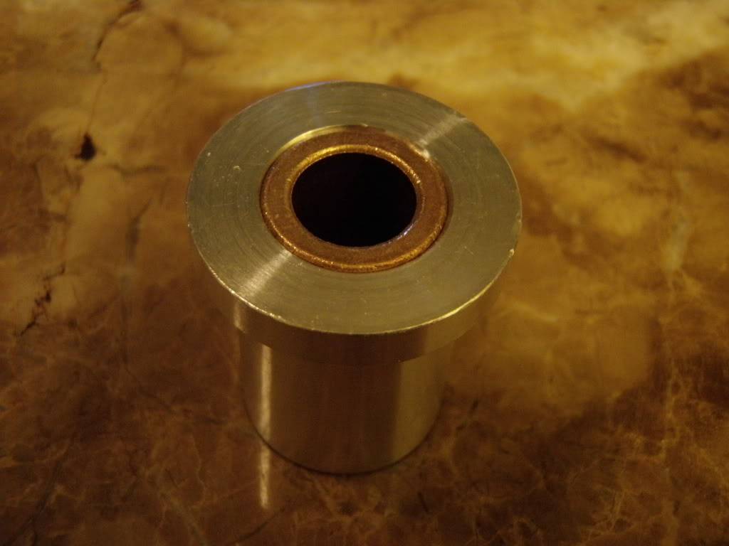

      Hey Mopar guys, I figured I'd share this with you. I found some cool solid shackle bushings from a company called American Muscle.
      http://www.carshopinc.com/advanced_s...hackle&x=0&y=0
      I recieved them in the mail today and they are nice. They are made from Aluminum and have pressed in bronze oilite sleeves. Know this however: If you use these then you can't run solid bushings on the front spring eye; the spring will bind. Some people think that poly bushings are still too stiff for leaf springs. I still wanted a solid connection on the other end of the spring so I picked up the Afco pivots. After I installed them they really do pivot very freely with no perceptible play. Anyway, I took a couple of pics and posted them here:

      They are nice, but not very popular. I had a set and it took me a year to sell them.
      2,624
      If you use sliders, couldn't you put solids on the front without binding?
      IL/TN
      908
      Quote Originally Posted by 68Formula View Post
      No you can't, in fact without the shackle you have even less deflection so a front pivot type bushing is highly recommended with a slider
      https://www.protouringf-body.com "doing what they say can't be done"
      2,624
      Where can I get a pivot type bushing for a '68 F-body?
