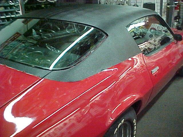

      I replaced about 8-10" of exterior sheetmetal of this C pillar in my 74 Camaro. It had rusted through where the vinyl top ends from the door window to the rear window. Used a panel flanger, formed a piece of sheetmetal, and bonded it in. Skim coat, primer and paint as usual. Sold the car a few years later with no signs of the panel repair in the paint even though it was stored outside in New England (yes new owner was informed). This was a bracket race car and I expected ghosting on an upper panel that the sun would beat on. I wouldn't do that type of repair on a show car upper panel because the thick area where the patch and original sheetmetal overlap will heat and cool at a different rate and I still think ghosting would eventually occur on any panels subjected to direct sun. A low panel down by the rockers or bottoms of the fenders would probably not have a ghosting problem unless the car was rountinely subjected to extremes like going from a heated garage to below freezing temperatures.
