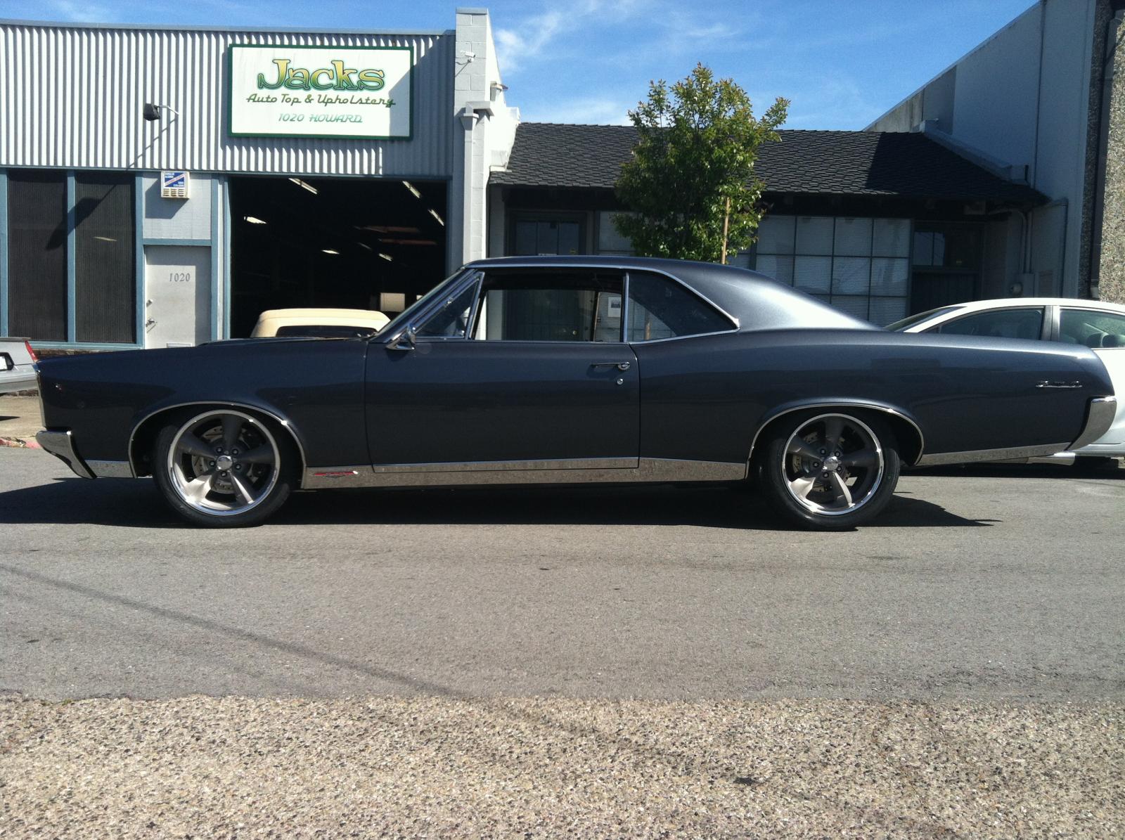

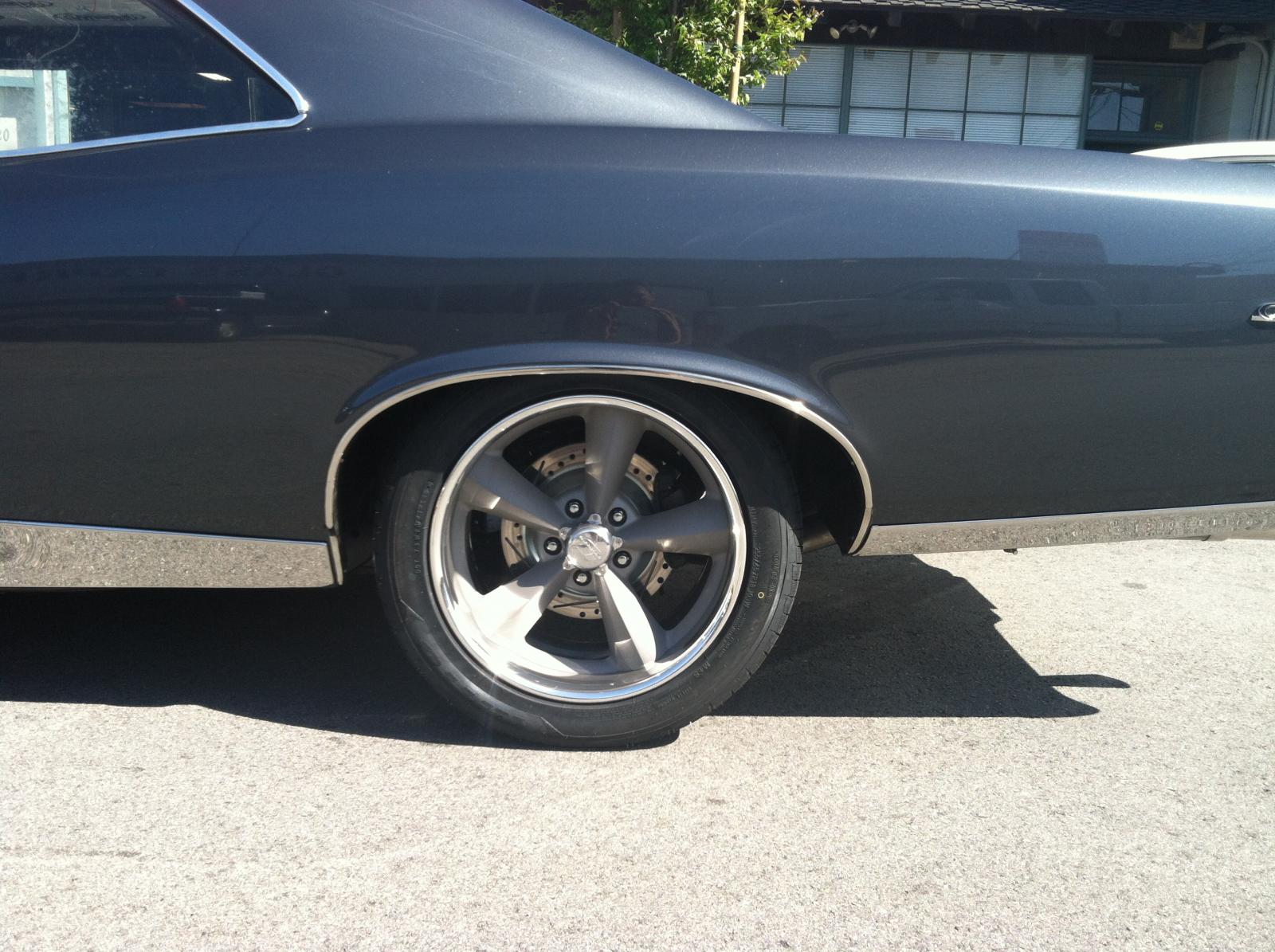

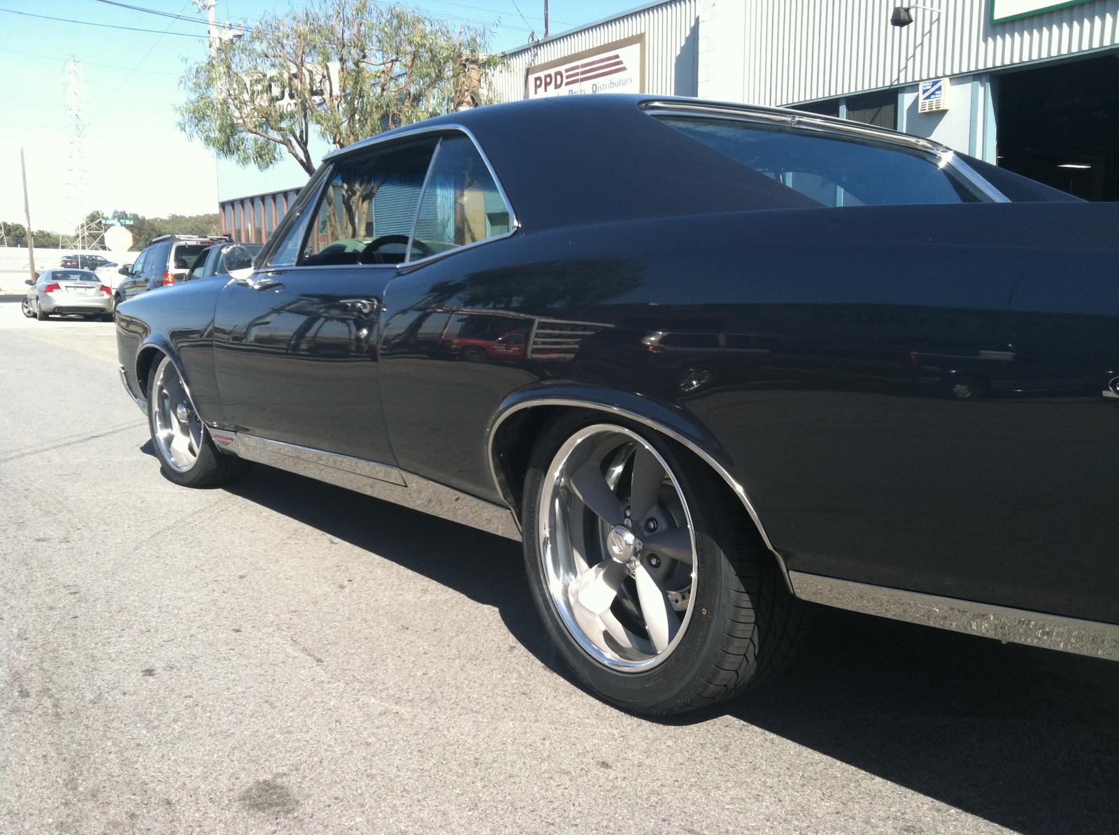

      I just wanted to say this car is beautiful! Love the setup. I am ready to order wheels and tires for my 1966 Lemans Sprint ohc6. I am going to shorten the rear end after I get wheels to assure fitment. My question is...Are you sure of your rear wheels backspace. They dont look like they have 5.75in. The baby blue car from prodigy that has 19s in rear is running 19x9 with 4.25 bs. Another member on here (quoted below) is running 18x9 with a 5.75bs and his dish on the wheel looks way smaller. I am just trying to get a good baseline before I order wheels. The rear end is out of my car and torn down so I cant measure now.
      Quote Originally Posted by mmag36 View Post
      Attachment 75416 Attachment 75417 Attachment 75418 Attachment 75419 Attachment 75420Here are the final wheel pix! Final stats: front 18X8 Billett Specialties MAG G 5" back space,245/40/18 NITTO MOTIVO tire. Rear 18X9 5.75" back space, 255/45/18. 275/45/18 tires will fit as well. This car has stock wheel wells and rear end. CHEERS!

      Sorry about the delay. Your best bet is to ask a reputable wheel guy on this board. They'll know the right measurements for A-bodies. We changed my rear axle width and wheel backspacing mid-order. What's on my invoice may not be correct, and I haven't had the chance to physically measure them.
