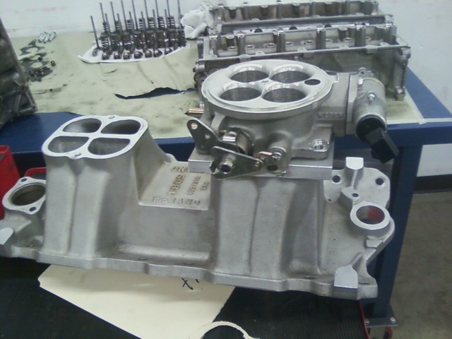

      Name:  new intake.JPG
      Just a quick look at where we're going with the intake. This isn't the Stealth Ram, it's an old tunnel bottom we used for mock-up.
      No dyno results yet. The dyno has been tied up with a blown SBC.

      Dunwoody, GA
      4,983
      Cool. Keep us posted. Thanks
