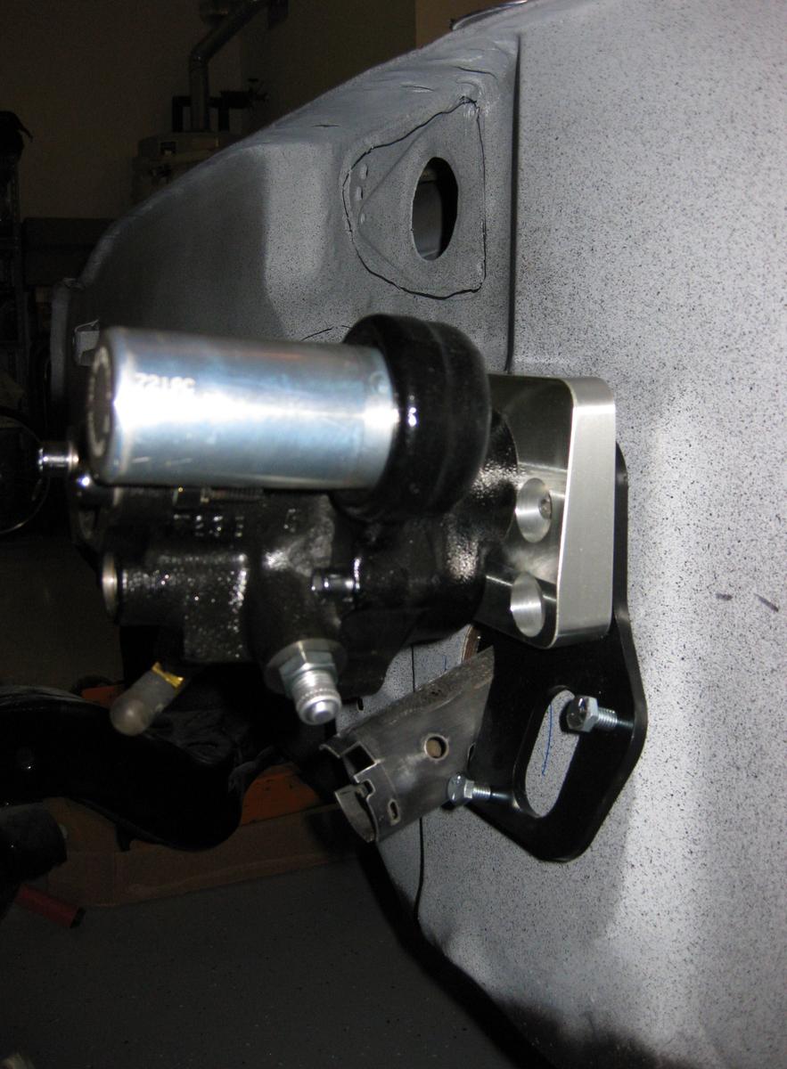

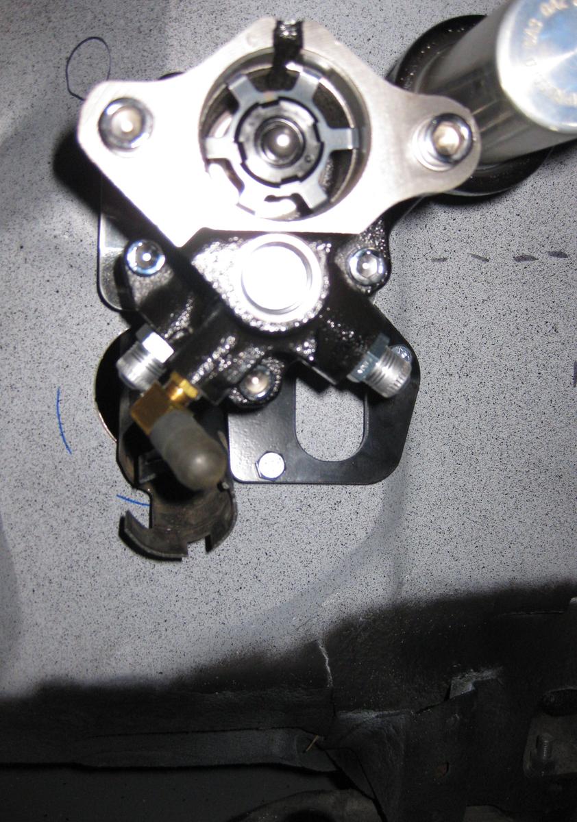

      I have flattened the firewall in my '72 Chevelle and have added hydroboost and the bracket for a hydraulic clutch. I am currently looking for ideas to seal the opening from around the steering column into the interior of the vehicle.
      I have looked at several options including a 4" wide seals-it grommet on the exterior of the firewall. Does anyone have any suggestions that I may have not explored or thought of yet? Obviously I am a bit short on space which is one of the major limiting factors to my options.

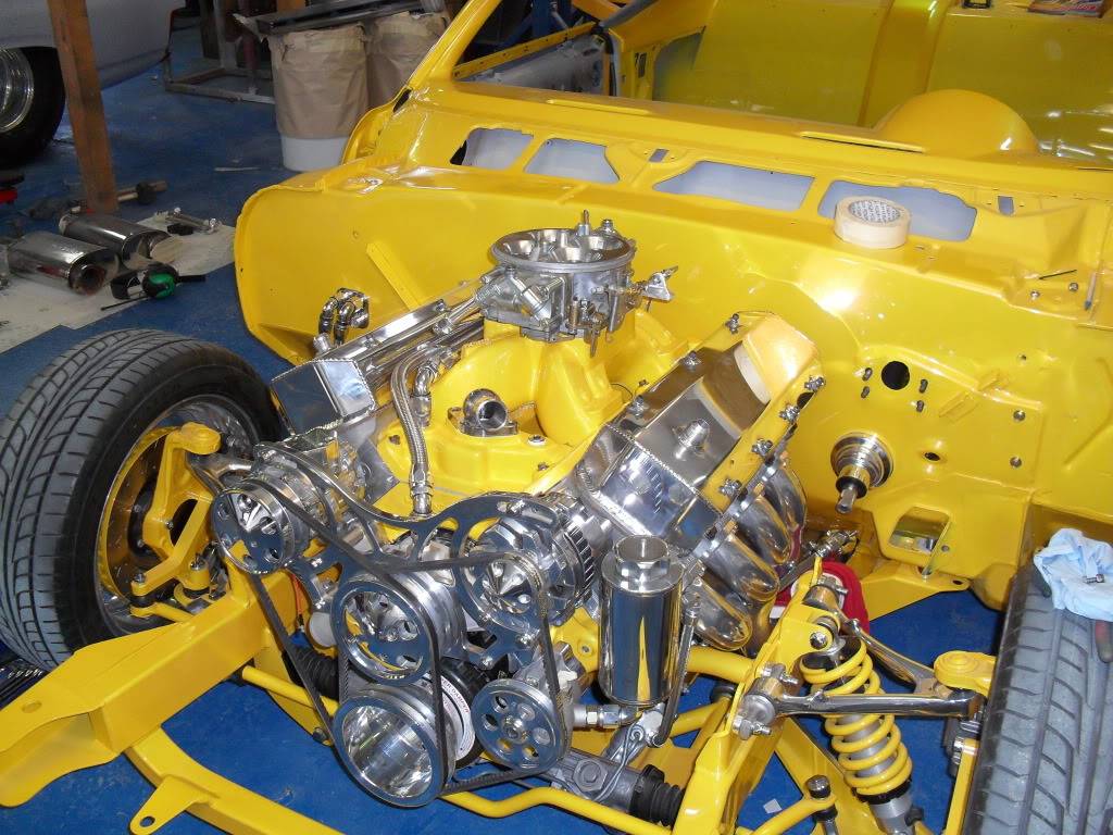

      Here is what I used (smoothed firewall and Hydroboost).
      Ididit sell em
