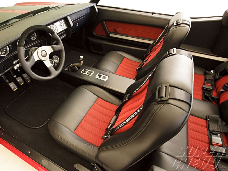

      what we need is somebody to design a seat that is meant to take the load. if the belt holes are above your shoulders and meant to take the load, there would be no issue running them to the floor. but, i dont see anyone making an reclining seat with this feature and assuming the liability with any seat design.
      im in the same boat; i wont put my kids in the back seat with just a harness bar, i wont run a cage without a helmet, and i would like something more than 3pts for the street. ive thought about running dual harnesses like stated above; harness bar with 5 pts for the races and morris 3pts for the street. i figure i can make the morris clip in and out some how.
      im hoping somebody comes up with some options in this thread http://www.lateral-g.net/forums/showthread.php4?t=28920
      also, the roadster shop came up with something for their chevelle convertible. im pretty sure they took the correct measures. does anyone know for sure? http://image.superchevy.com/f/322080...m_interior.jpg

      It looks gorgeous -- but without a headrest, it could be deadly.
      Also, they are relying on the seat to vehicle interface to carry the entire load as well as the locking mechanism in the seat back. Lack of headrest aside, I am curious what loads this seat and interface was designed to. Does it meet FVMSS? I have seen enough sled tests of prototype seat designs and it's surprising what fails. Also, at least in the photos, it looks like the spacing between the shoulder belts is a bit wide -- could be the perspective though.

      i agree with the headrest. i also agree that there are some serious forces involved. i recently saw the upper portion of a rear seat tear all of tack welds and end up in the front seat. it wasnt torn off from being hit, it was torn off due to the sudden deceleration of the vehicle it was part of (she rear ended someone that was stopped while she was doing about 45).
      i hope RS did their homework. i have a lot of respect for their builds, and im hoping they may have a solution.
      Does it meet FVMSS?
      what in the aftermarket does? im actually asking, but im pretty sure its almost nothing. my current favorite is the rigid ididit/flaming river columns that are being sold to replace the factory collapsible columns. but thats a whole other thread.

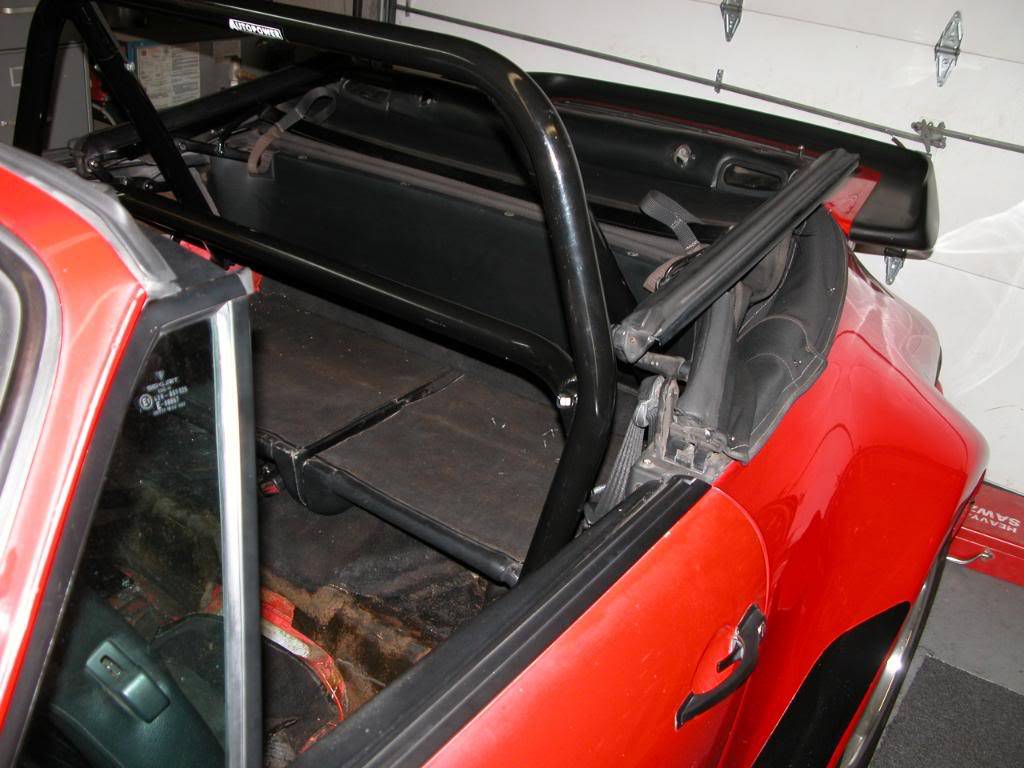

      I don't know if any of you guys with the occasional need/desire for a rollbar/harness bar for certain types of events have considered it, but there are bolt in rollbars that can add rollover protection and provide correct harness mount points. Like anything there's compromises to consider but it might be an option for some. I have one in my Carrera and I can install or remove it alone in under an hour. When the bars not in the car you can't tell there was one in there unless you go crawling underneath to find the mounting positions. You'd be surprised how many vehicles they're available for.
