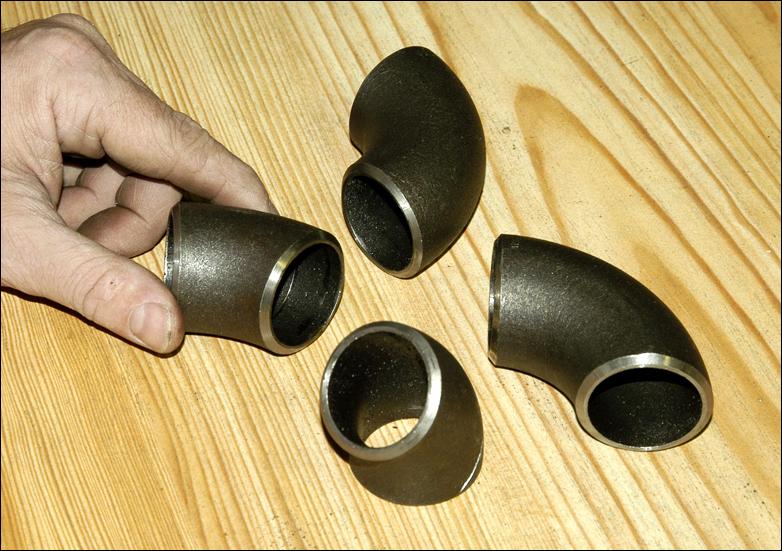

      Criteria I will try and maintain:
      1) Keep tucked up against block.
      2) Keep above oil pan to maintain gravity drain to pan.
      3) Use heavy sch pipe for reduced underhood heat, better turbo ops and strength.
      This is what I'm thinking http://autospeed.com/cms/title_Makin...4/article.html

      McMaster carr makes some really good elbows for turbo projects. I will try and find a old thread that went through the process of using them. Also, there was a guy who used them on high HP builds...let me look.
      Oct 2009
      New Derry, PA
      1,265
      Ron,
      You might try these guys.
      http://www.murrayequipment.com/dynca...ipe%20Fittings
      Also, B&B Surplus in Bakersfield has CS and SS weld fittings...along with a lot of other cool "project metal".
      http://www.elistingengine.com/listin...2618&c=43&f=37
      Forget their website, though. They have a ton of stuff you won't find on there...
      One of the problems with using welded pipe fittings is the odd sizing and lack of choices. I've done a few of these types of manifold, and the ID tends to be either too big or too small. I've had the best luck with 1 1/4 SCH10, but it's hit or miss on what you'll get each time...
