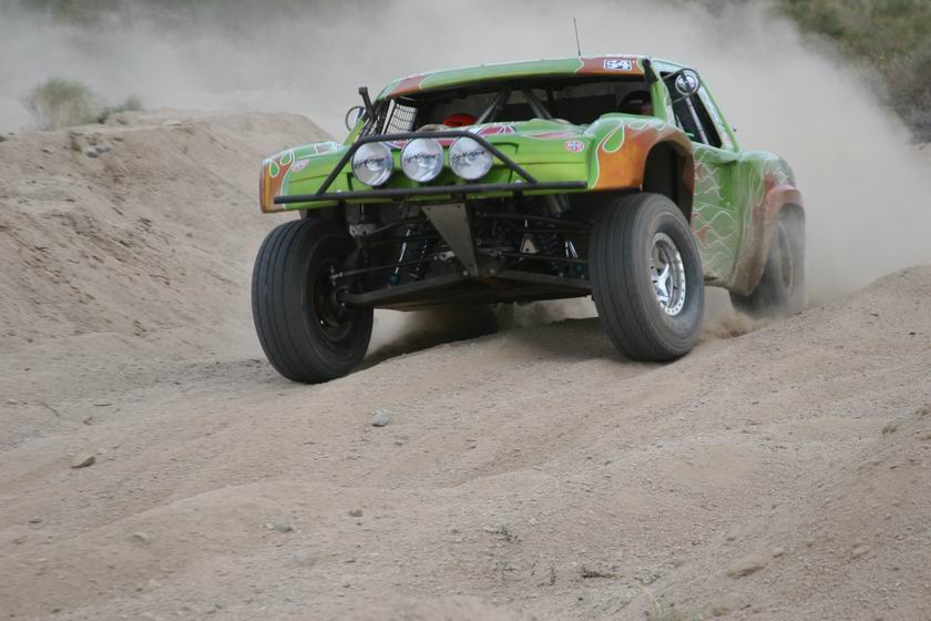

      We have been contracted to rebuild the "Jesse James Monster Garage Trophy Truck" by another desert racer to make it competitive and more reliable/ race legal. I know that this is not a Pro-Touring build but this is definitely something different and cool that im sure some of you would enjoy seeing.
      Here is the old truck and Chassis.
      Jason
