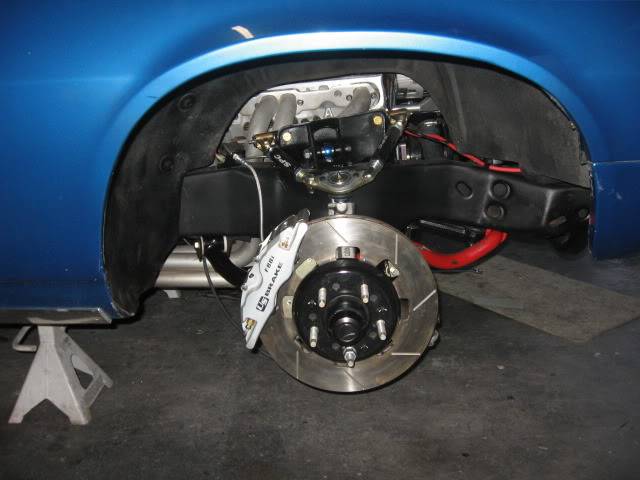

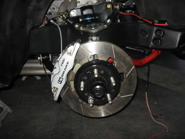

      here are some new shots of the front suspension and our new brake kit

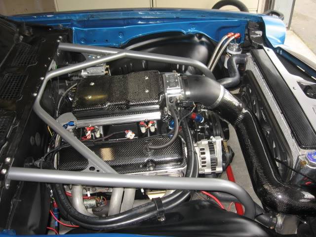

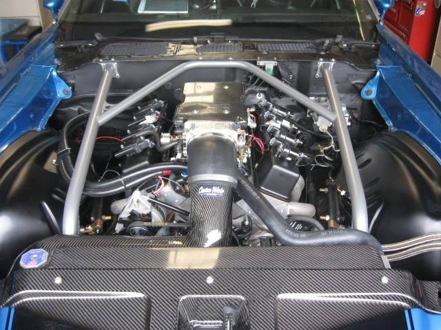

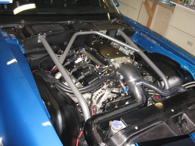

      Here are some new shots of the engine compartment, with the new Holley HP EFI controlling the LS coils on a conventional small block chevy. Oh yeah the upper intake was made by us, the base is a Holley Stealth Ram

      We got the engine fired up. I have to say that even though this engine is very complex with the coil on plug ignition and such, the Holley HP EFI system, really made life easy. We have been using this system and are authorized Holley installers for about a year and a half. The Holley set up is way better than any system we have ever tuned, bar none! If you are running an LS motor or a small block chevy, getting it going is not nearly as difficult as it once was. Self tuning feature is great. bellow is a video of the first run

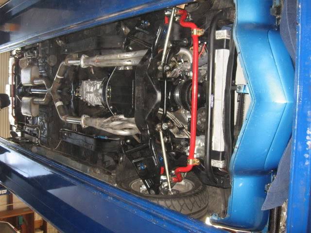

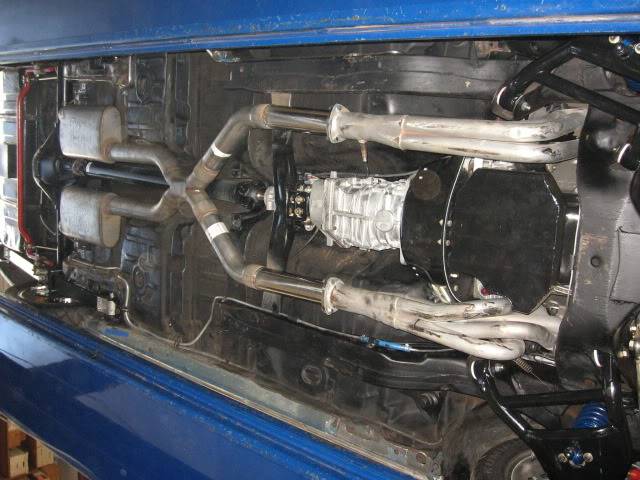

      while the car was on the lift we took some shots
