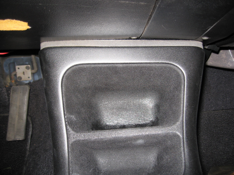

      Center console for bench seat chevelle.
      After a lot of searching the junk yards I found a perfect donor. It's out of a 95 explorer limited w/ rear air. I just cut it down, took out all internals and fab'd up some mounts. Then I painted it and added the stainless cup holders. The contours and shape is perfect. Had to keep the bench seat it's a wife thing!

      Nice job! Looks factory! I'm thinking of doing something similar in my 72' LeMans... Can you shoot a pic of where it connects to the dash? I'd like to see the fit there.

      Here is a close up fits real good. If you get one it has to be a limited version explorer with rear console air. Then you need to take out all the guts, cut to fit and fab up some brackets and mounts.
