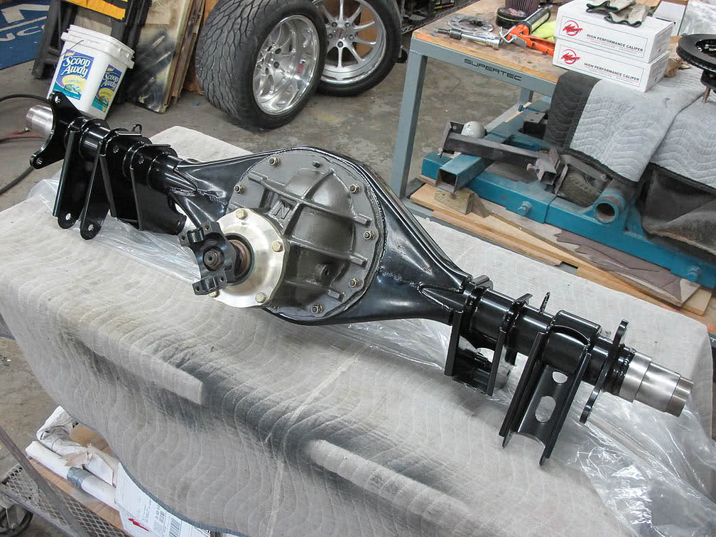

      So, after a couple little incidents, all of which have been taken care of, the car is progressing on schedule. The floater is now under the car, and pretty much everything is together. The rear brakes and clutch remain to be bled, so as long as they work properly we will have a drivable car by the end of tomorrow.
      14.25" Probably not necessary, but definitely cool looking.

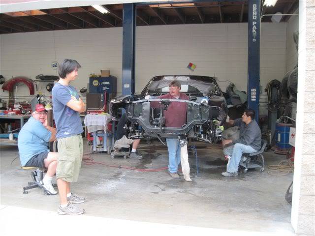

      First the stupid:
      It was posted a while back, but it needs to be seen again. Here we have D!ck installing a subframe using a lift an engine hoist, and jackstands, all at the same time.
      Figure 2: again we can't seem to grasp the concept of the lift. Apparently I haven't figured out what creepers are for either
      Figure 3: while an explanation is probably necessary, there is no remotely logical explanation of what is taking place here. Perhaps Jon rolled over onto the floor so that he could complain (which makes him happy).
      Figure 4: Given the timeframe for the scope of this rebuild, it seemed only natural that we do our best to emulate the manner in which people dealing with big projects work. Here we've taken some pointers from Caltrans and the lovely state of California. While there are only two of us who are "supervising" pictured, there is likely one more person standing out of view, one who had to take the photo, and at least one person off in the corner fiddling around with something like a steering column (Gregg, aka Gandalf).

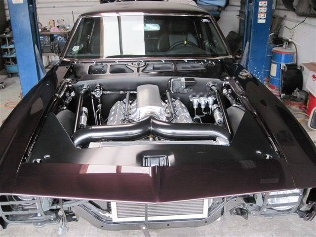

      Jon, other than sitting in the car while on a lift and pretending to shift while making engine noises, along backing the car into a parking spot, I have no idea how the pedals really work. From what I can tell though, the pedals are pretty trick. The new brake pedal has way less movement than the old one. Tilton's master cylinders are supposed to have less dead pedal stroke, and I think that might be true. I'm not sure how much more effort it will take to stop the car, but in theory it shouldn't require that much more effort than before, since the only actual change in mechanics was a slight decrease in pedal ratio. My initial parking lot impressions have me hopeful that the floor mount assembly was exactly what I was looking for. I'll talk more about that once I go and drive it though.
      Matt - where did you get the intake - i want something like this and i know Spectre has one but i'm digging the black runners.
      Don, you're talking about the cold air intake right? We made it out of left over four inch truck exhaust tubing that had 90 degree bends. We just cut the pipes and welded them where you can see the seam in the middle. Afterwards we powder coated it a semigloss black.
