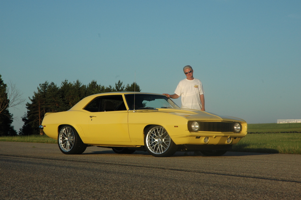

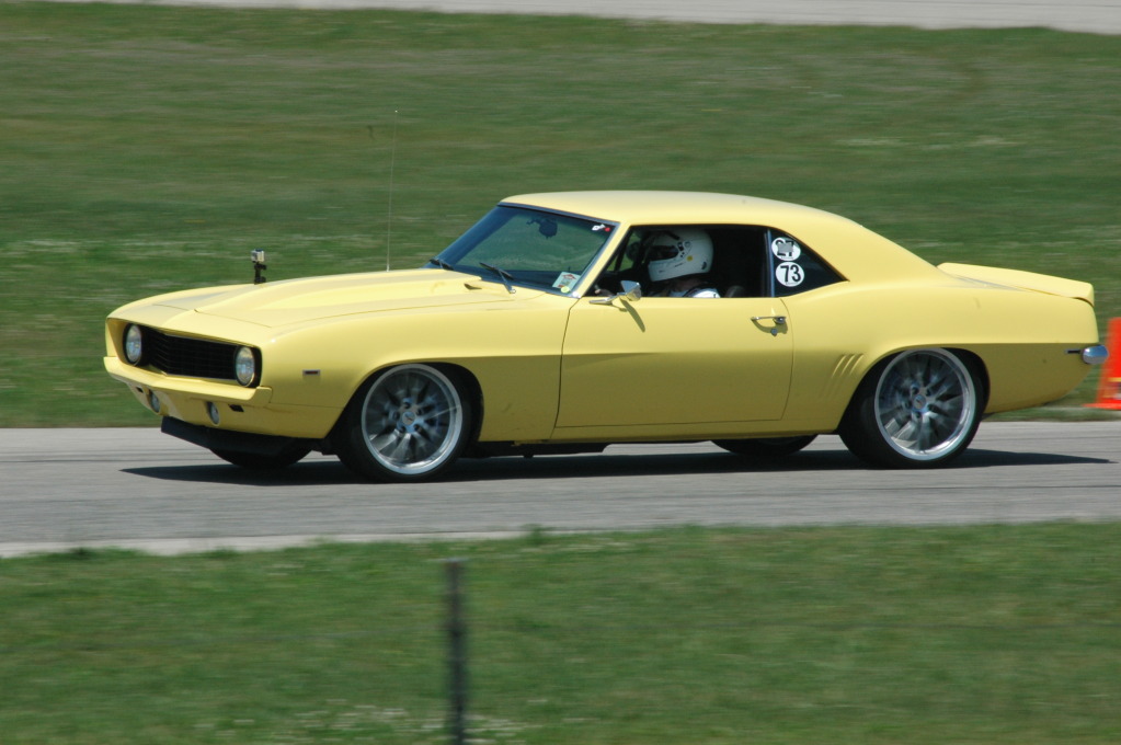

      Mine is similar to what Charlie describes. It's a lot of fun to drive. An LS3 with a Magnuson supercharger would have significantly more power than mine.
