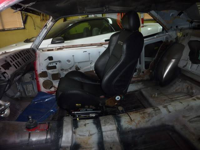

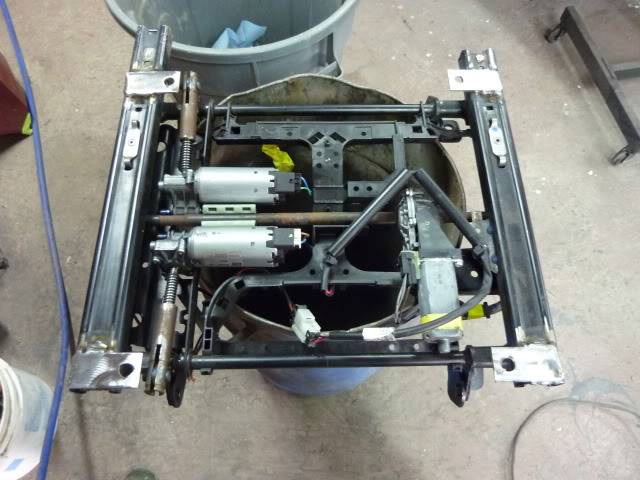

      I have a set of GTO seats that I'm putting into my 68 Acadian (Nova). I also wanted to keep the power option so I cut off the stock mounts and welded some new ones right to the stock base. I then welded some bolts onto the floor of the car where I needed them. Here's a few pics of what I did. I have more in my build thread if you want to see them.
      They sit pretty high in this pick, but once I got the power hooked up, they dropped right down. This was in the highest setting.

      Thanks Mike ..they look great...any pics of them in the lowest position? Thanks. I just may do the same thing.

      Unfortunately I don't have any pics in the dropped position. If I had to guess though....they probably dropped at least 2-3 inches.
