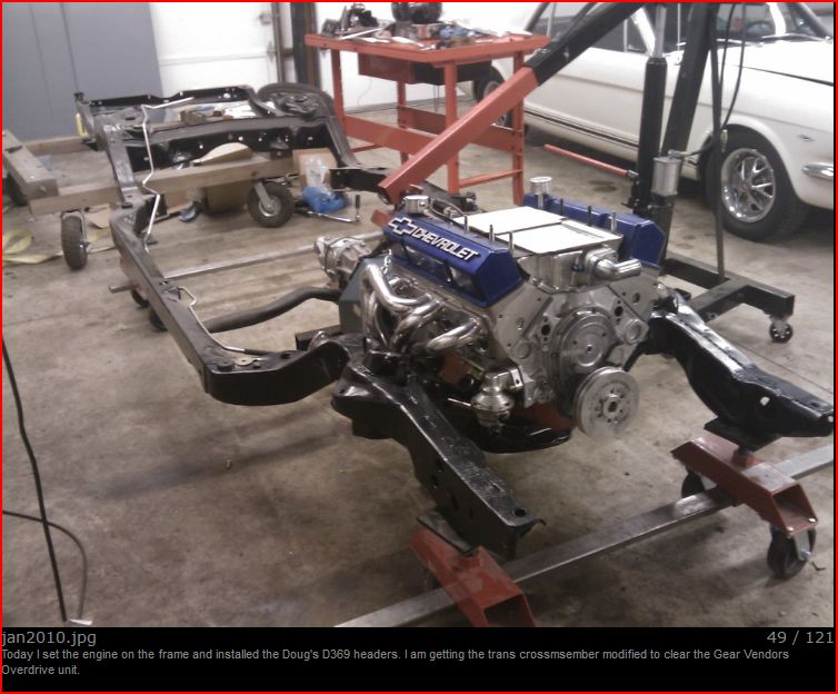

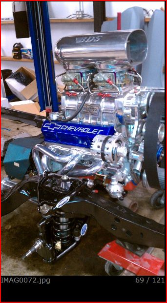

      I have been randomly posting since I picked up my chevelle and figured it was time to start my official build thread. My screen name reflects my prior ride of 13 years. I bought a 66 SS Chevelle and am installing the powertrain from the Monte with some mods like a Gear Vendors. Goal is to have a Chevelle that performs well on the street and at the road course or drag strip. I am going for a retro look with big ET 5 spokes and a 671 Roots style blower. I can't recall seeing a big Velle with a roots blower on a road course so this could be interesting. Who knows, maybe I won't be able to see around the blower scoop well enough and will have to go procharger after all .
      The build features:
      359 Cube 740HP blown SBC with dual 1150 dominators. This engine put my Monte in the 10's in the 1/4 mile.

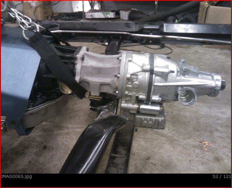

      TH400 trans with Super Comp direct drum, Hipster's brake, 3000 stall. Trans is backed by a Gear Vendors over-drive.
      Ford 9" rear features Currie Track 9 housing, iron N Case with Detroit locker, and 3:50 gears.
      Rear suspension has Currectrac arms and HR bar with Budzter adjusters and 150# Hypercoils.
      Front suspension features Detroit Speed arms and spindles, splined sway bar and 650# springs.
      KRC power steering pump and Jeep Grand Cherokee box.
      Shocks are Strange dual adjusts front and rear.
      Brakes: Z51 Corvette calipers and rotors with Kore3 hardware front and rear.
      Wheels are classic ET 5 spokes 18x9.5 rear and 17x8 front.
      I will update this list as the build progresses and post pics.

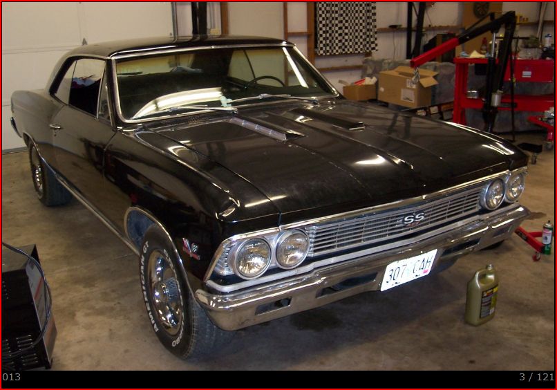

      Before I took it apart it didn't look to shabby. If it wasn't for the body rust I found in a few spots I would have dropped in my engine and had some fun.

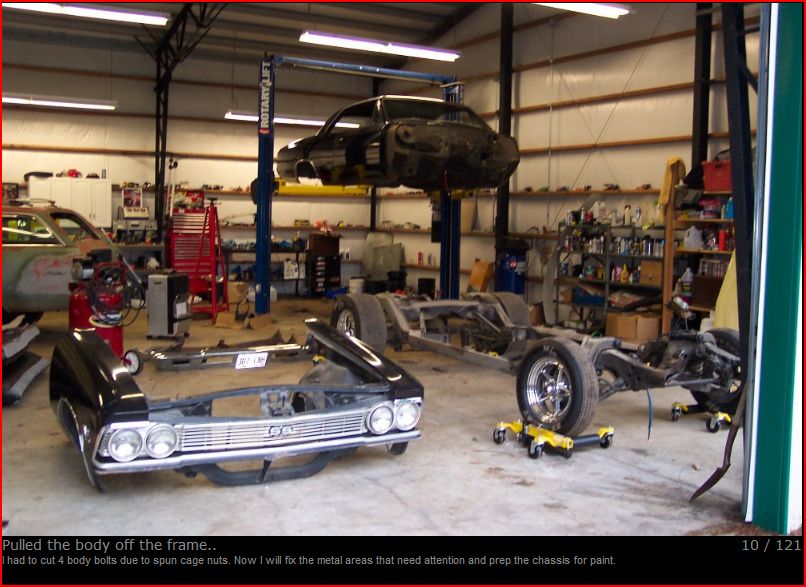

      Pulling it apart.. The adventure begins..

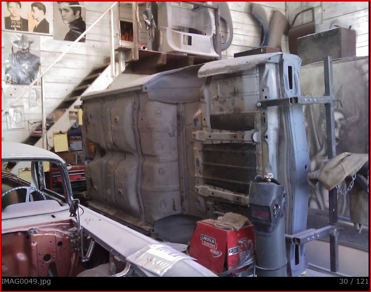

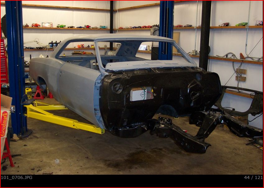

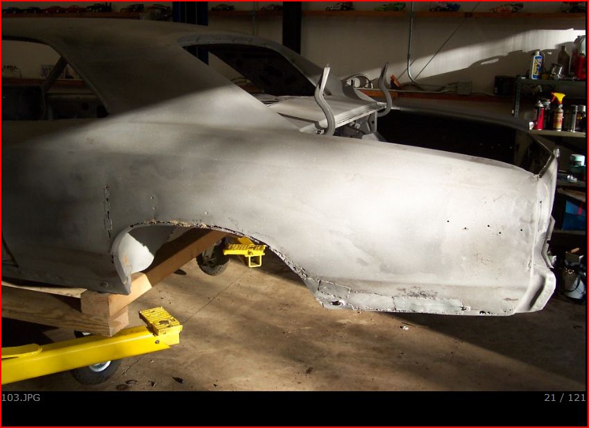

      Amazing what you find when you media blast a car. This quarter looked pretty darn straight before blasting but the blasting revealed some seriously ugly patchwork and looked liked someone ran a circular saw up it for fun. This side got a new quarter.

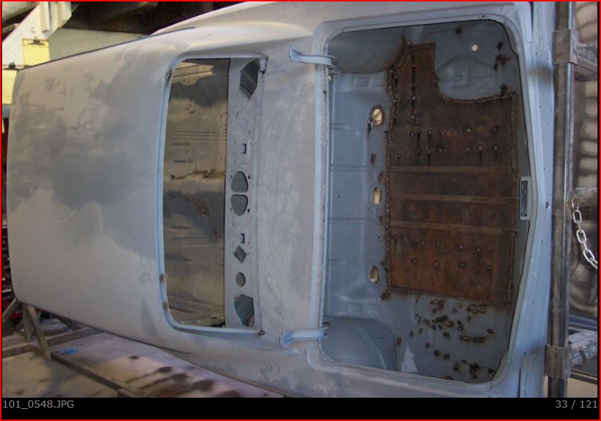

      The trunk had some drainage holes created by rust so it got repaired with patch pieces from a donor car floor pan. With all repairs the idea was to retain as much OE metal as possible. The rust free pan I found really helped. My car was a factory automatic trans but someone had converted it and butchered the floor. It was nice to have a spare pan to cut patches from.

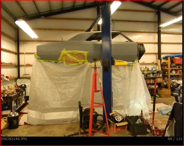

      On the rack at Fat Wallet Customs getting the metalwork done.

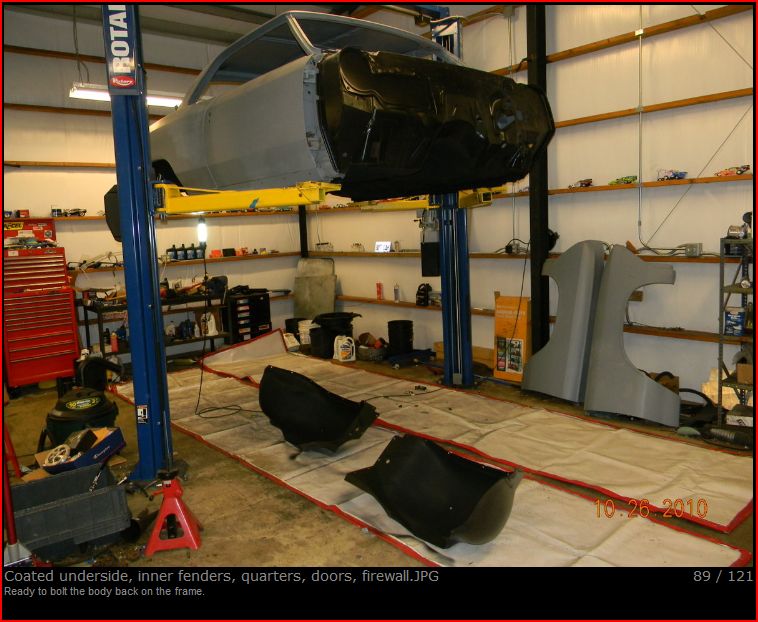

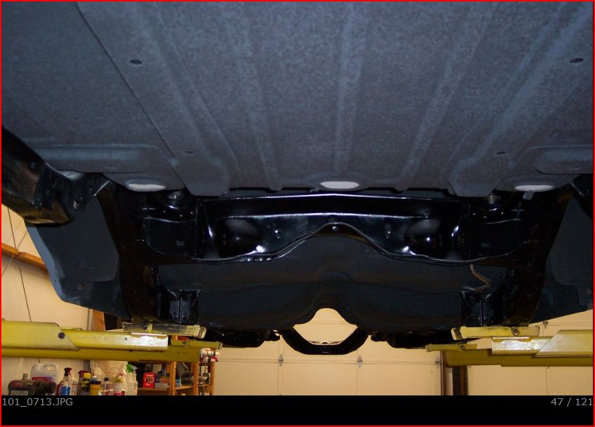

      Look ma, no more rust! I got the body home after all major metal work was done. The underside was coated with Lizard Skin and then I shot it with Wurth Underbody Seal.

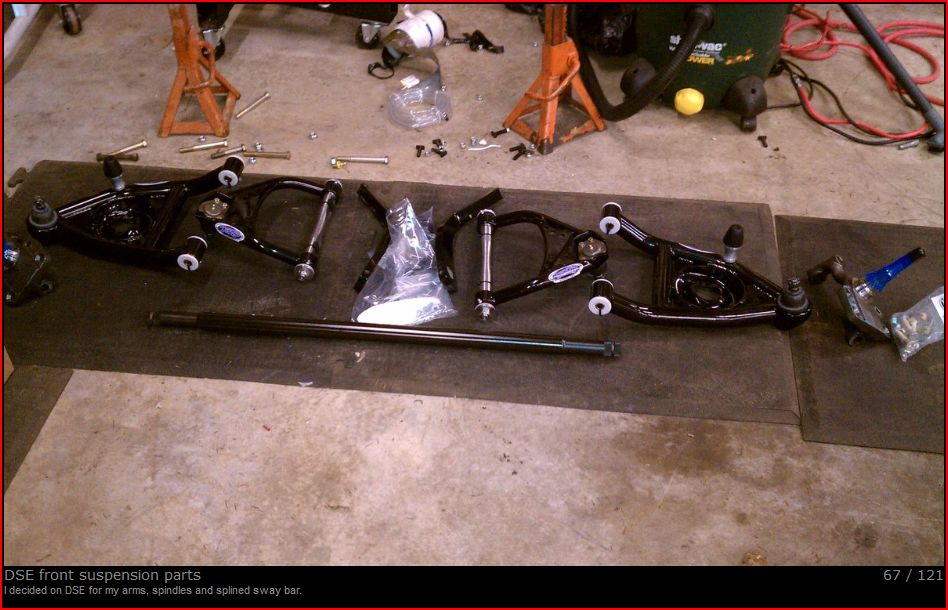

      The pics posted above were of progress up until today. I had the body work done at Fat Wallet Customs in Portland Oregon and I do the rest by myself. I plan to tackle the front suspension in the next few weeks and have the DSE pieces coming UPS.

      Front end parts arrived!! Springs were mis-boxed so waiting on the correct ones but this DSE stuff looks sweet!

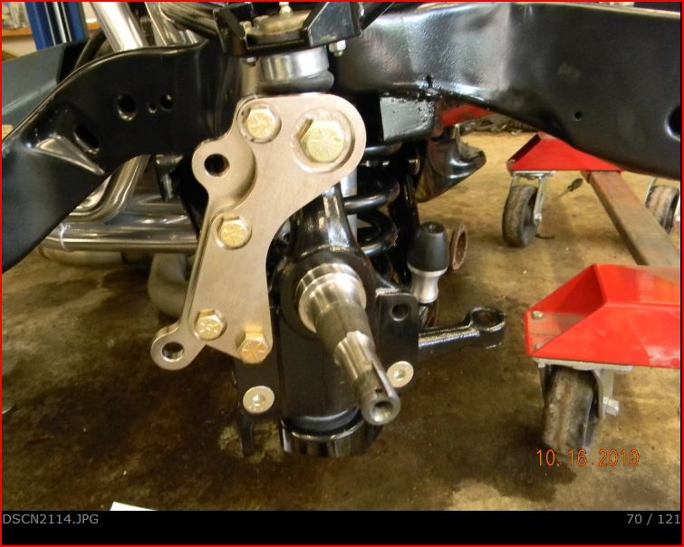

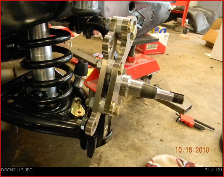

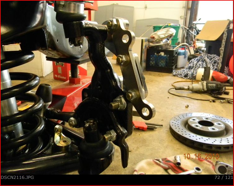

      Today I bolted on the front control arms and spindles. Putting in the shocks first would have been a good idea since they don't fit through the lower arm.. I ended up having to pull the springs back out a few times. Oh well it's just time and cotter pins.. One of the adjustment knobs unscrewed the whole valve on my Strange shocks so I had to remove it and repair it. I lost some shock oil but hopefully not enough to cause an issue.
      Next time I work on it I will install the front brakes.
      Here's a pic from today.

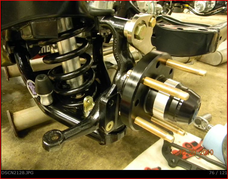

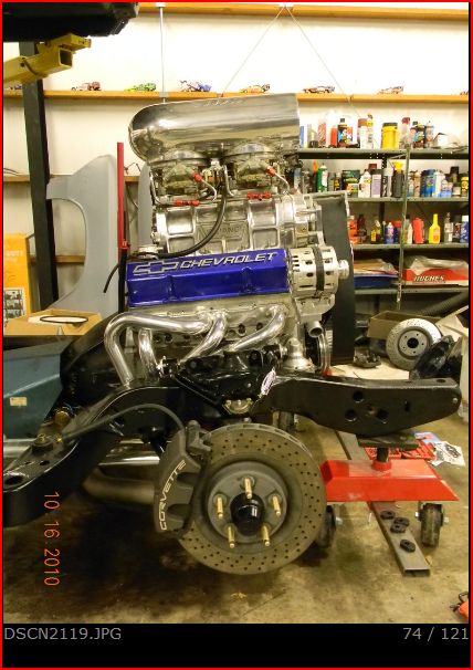

      Here are some pics of my Kore3 offset brackets and front brakes installed. I had to turn down the centers on my aluminum hubs for wheel clearance but it was no big deal.
