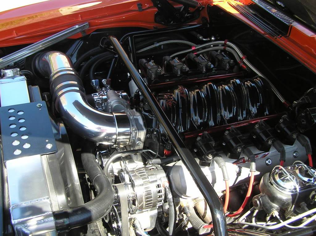

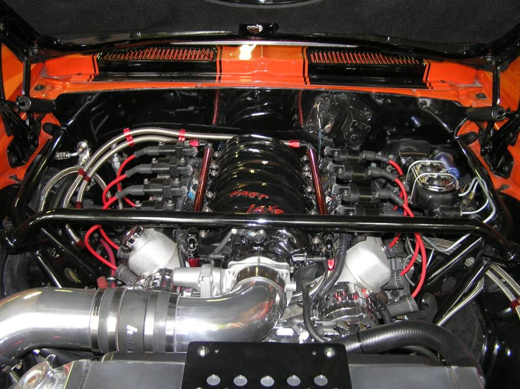

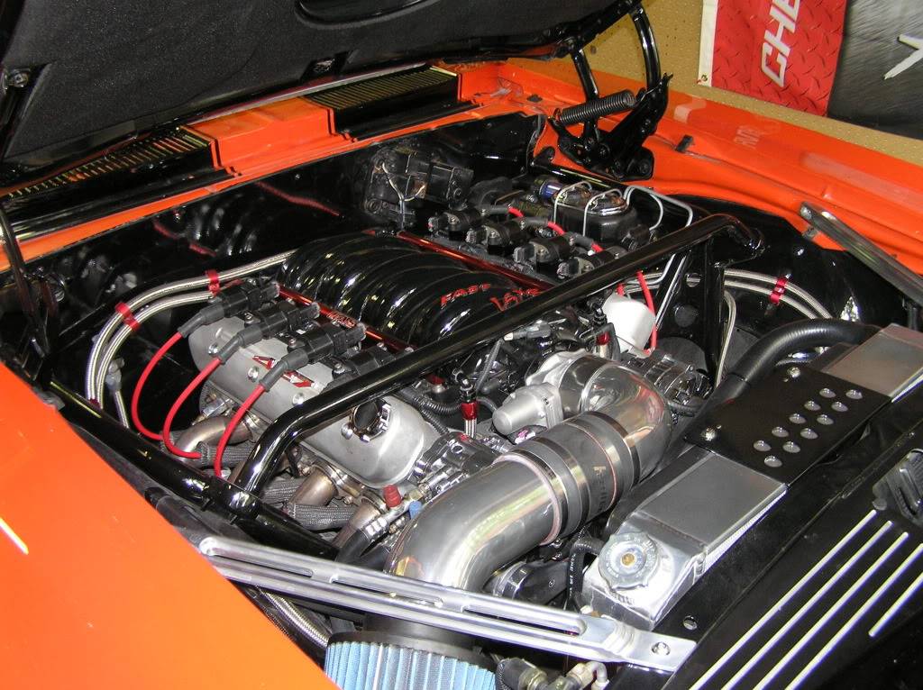

      Ever since I've had this ride I have been trying to remove the cocktail shakers and still maintain integrity and stability.
      When Hotchkis released their handle bar system I believed I might have found a way.
      I'm happy to announce that with the installation of the bars the stiffness has increased and removing the shakers has been phenomenal.
      I added both the front and rear bars and the shakers are in a secured storage!

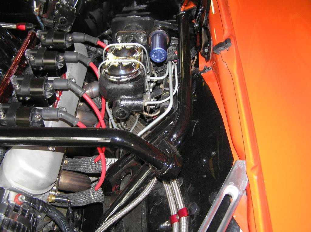

      Can you get a picture of the mounting where the uppers meet?

      We had to lenghten the tabs that attach the cross bar to the bracket in order to raise and move the bar forward to clear the FAST LSX 102 manifold.
      My UCA are the SPC Pro-Lite arms.
      I removed the rear shakers but in a vert we had to modify the rear panel to get it to fit.
      The bars weigh probably a third of a shaker.

      I'll refer to Hotchkis for the tech questions
      you can see from the plcs where they mount.
      They give the car a stiffness that you can feel.
