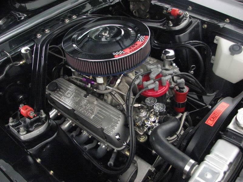

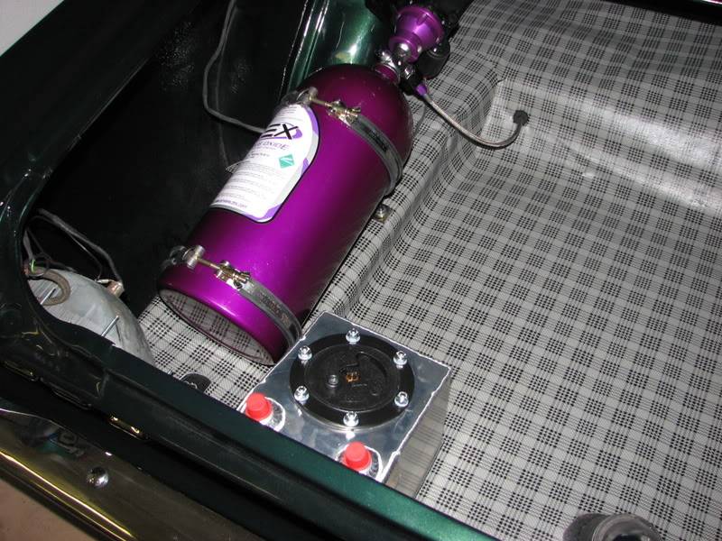

      I run a ZEX perimeter plate system on my carbed Mustang. And to make it as safe as possible, and to allow me to run a bigger "shot", I installed a 1 gal dedicated fuel system just for the nitrous that I run 105 unleaded race gas in (unleaded because I also have a wide band O2 sensor that would fail if I ran leaded race gas). This dedicated system has its only electric pump, filters, and regulator. This pump come on when the nitrous system is armed. I also run a fuel pressure switch that opens the ground circuit to the solenoids whenever the fuel pressure drops below 6 psi. This saves the engine when the 1 gal cell runs dry. I also have an indicator light in the car so I know when the fuel pressure is above 6 psi. I also use a wide open throttle switch mounted to the carb to engage the nitrous only during full throttle.
      To further enhance my system I also have a purge solenoid that will ensure that there is nitrous gas at the solenoid instead of vapor. This will prevent a temporary rich condition when the nitrous is first engaged.

      That's a pretty cool system. A question occurs to me. So when you "arm" the nitrous system, the fuel system switches over from the default electric fuel pumps and fuel cell. I'm assuming then that you'd need to run a bit before actually hitting the nitrous? Otherwise all the fuel in your bowls is still from your default fuel system but nitrous would be injected through the plate, right?

      Thanks...the dedicated NOS fuel system only provides the 105 to the fuel solenoid. It is completely separate from the system that feeds the carb. A carb plate NOS system injects both nitrous and fuel through the plate.
