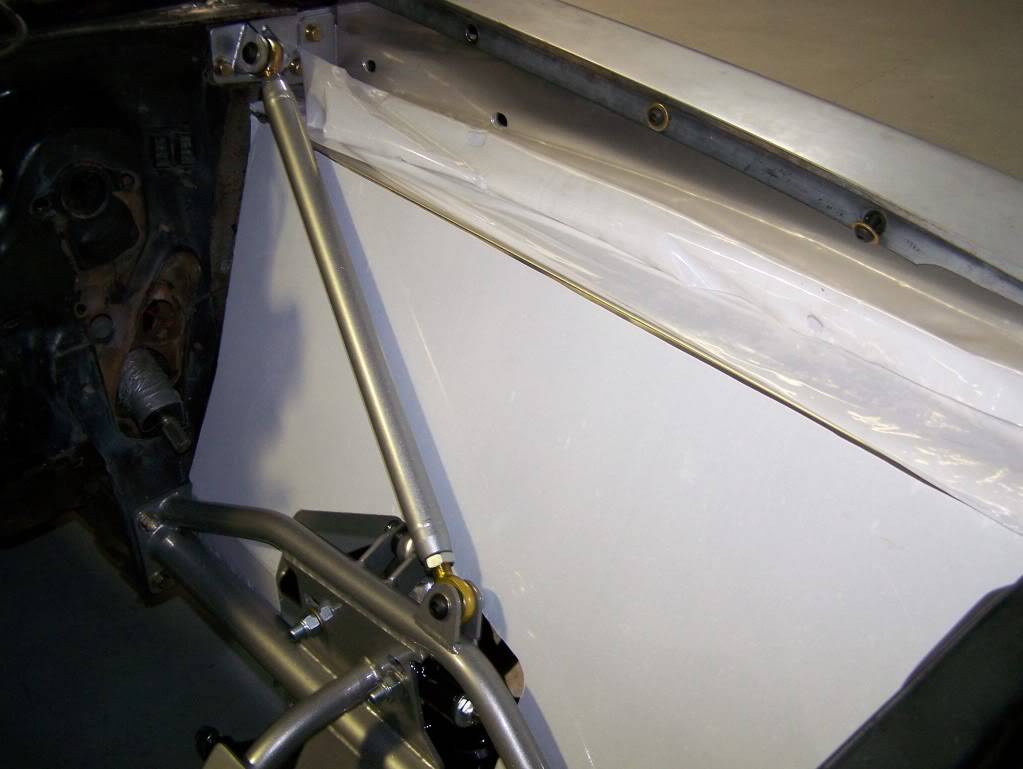

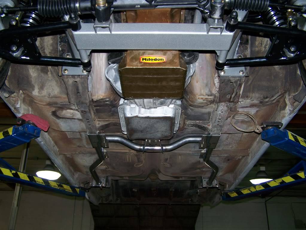

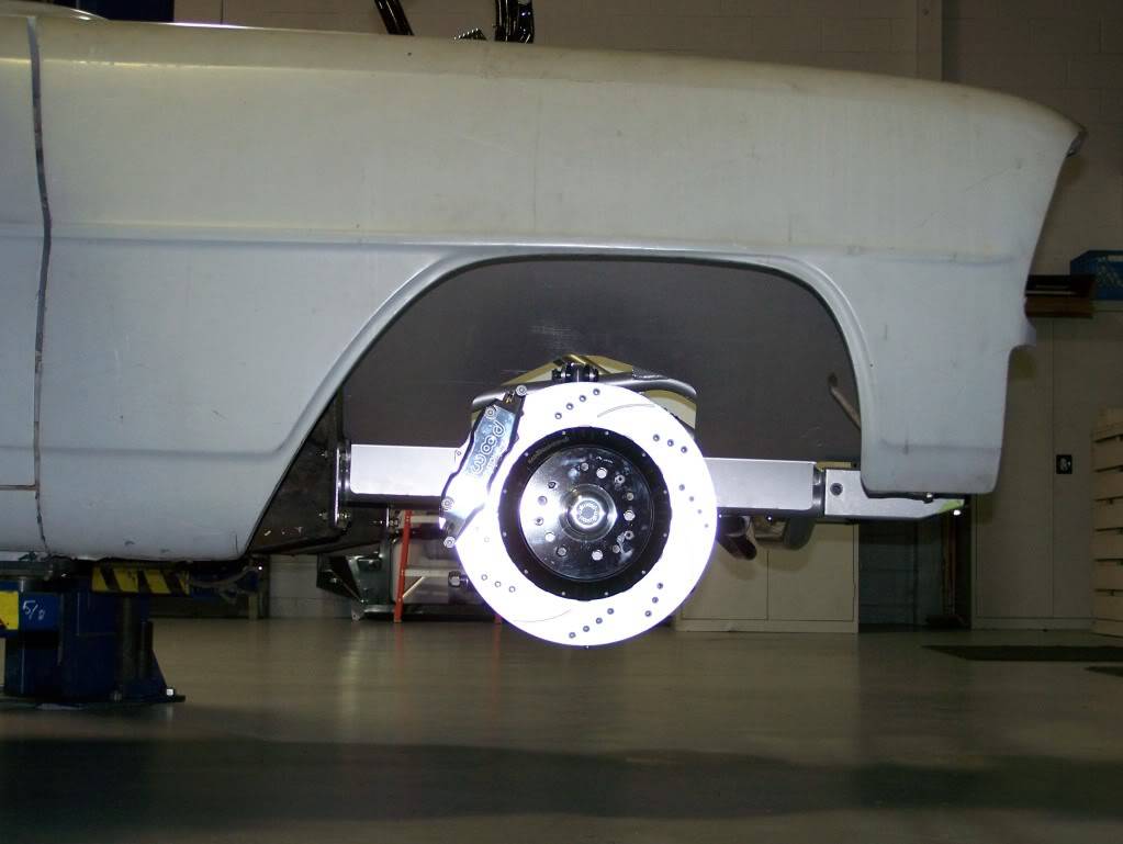

      Here is a early moch up pic of the P/T front end with 12" Wilwoods. This red front clip is now a display/see below for the 14" brakes on the silver front end for what Sal will be running.

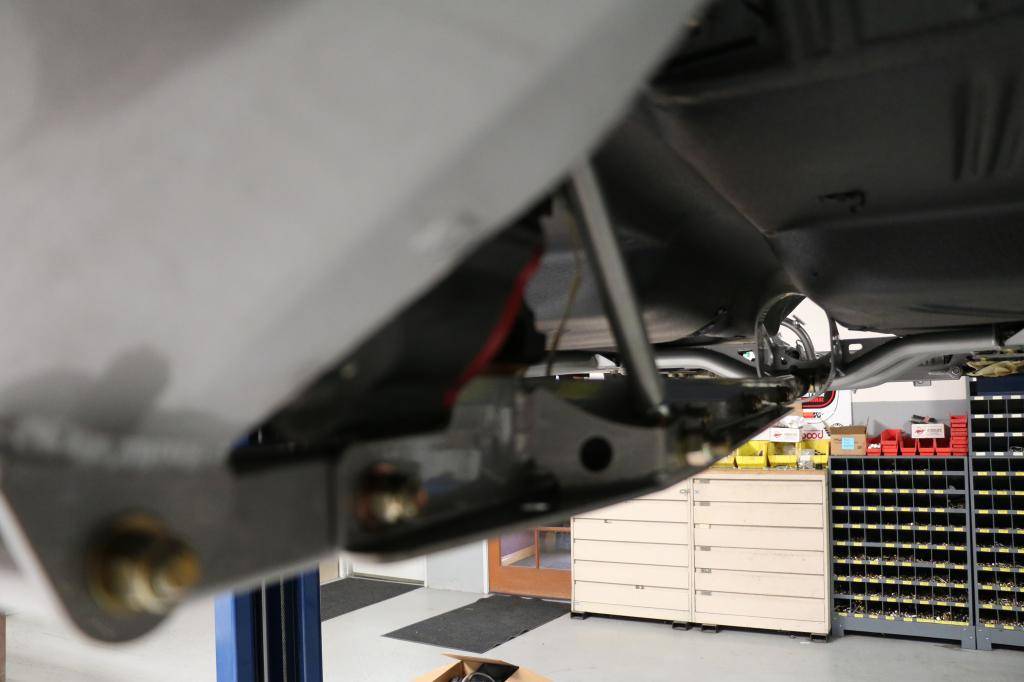

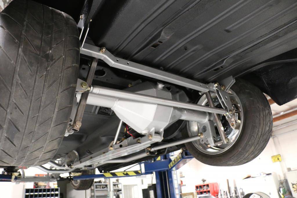

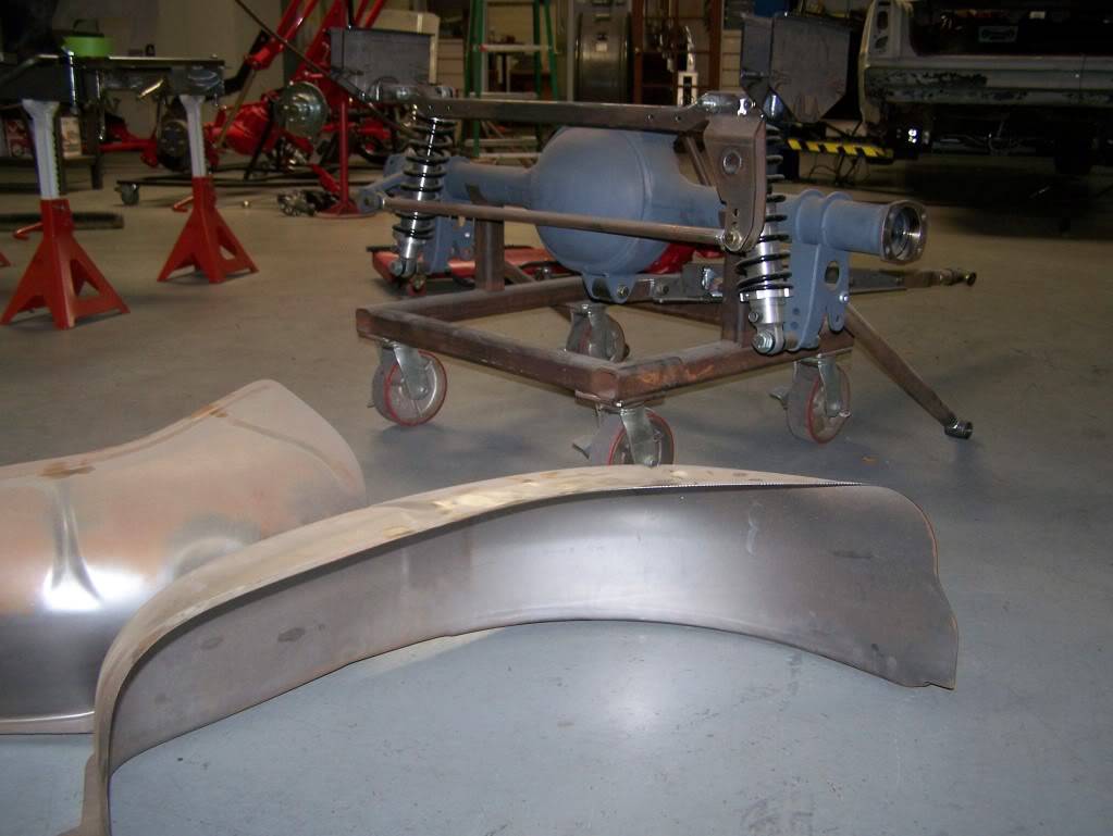

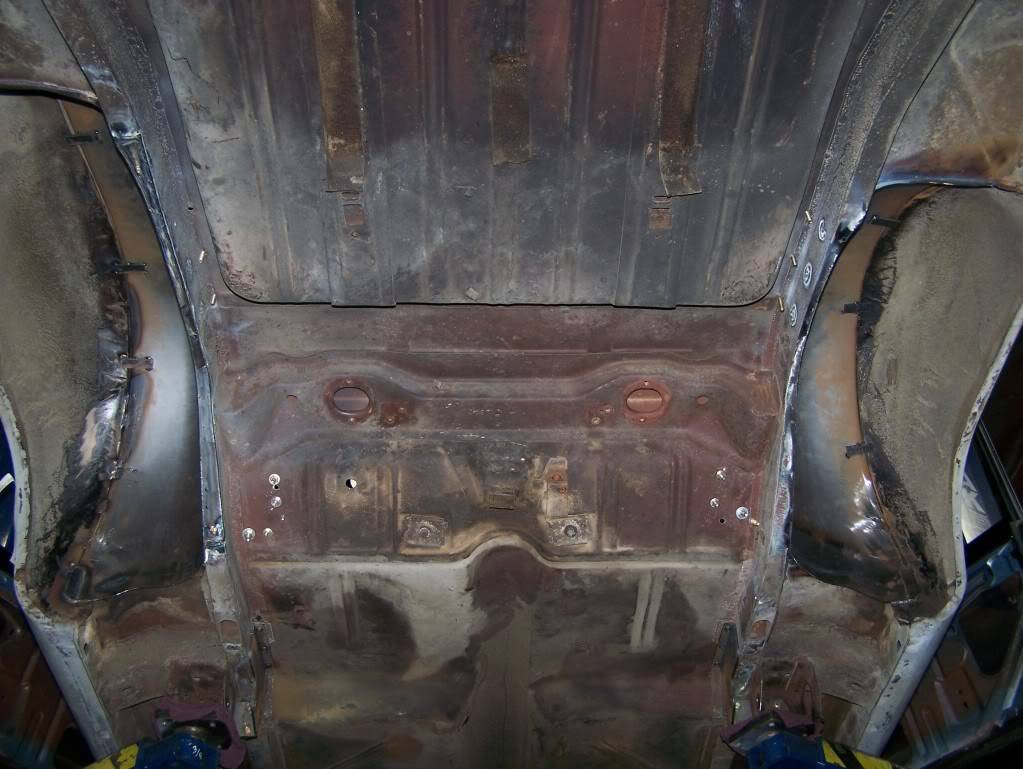

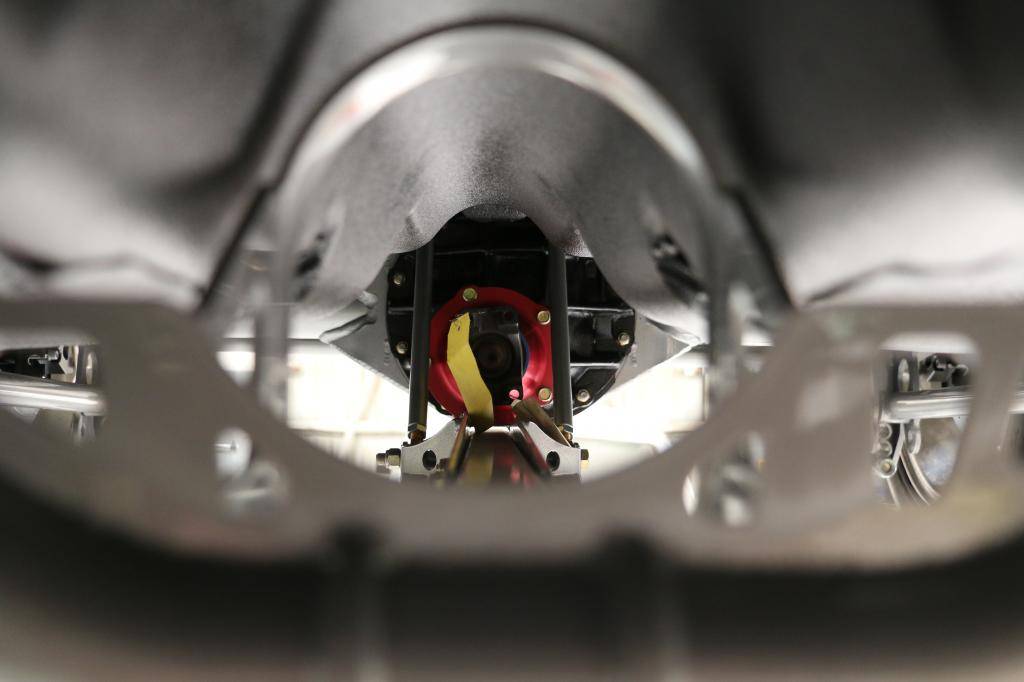

      Early moch-up pics of the rear suspension.

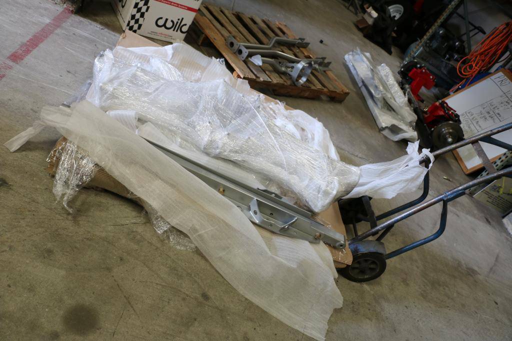

      finalized pieces before being installed
      Sal talked to Kyle at the Columbus Goodguys and came home with these goodies.
      We've got a plastic moch-up engine and an automatic tranny in the car right now.

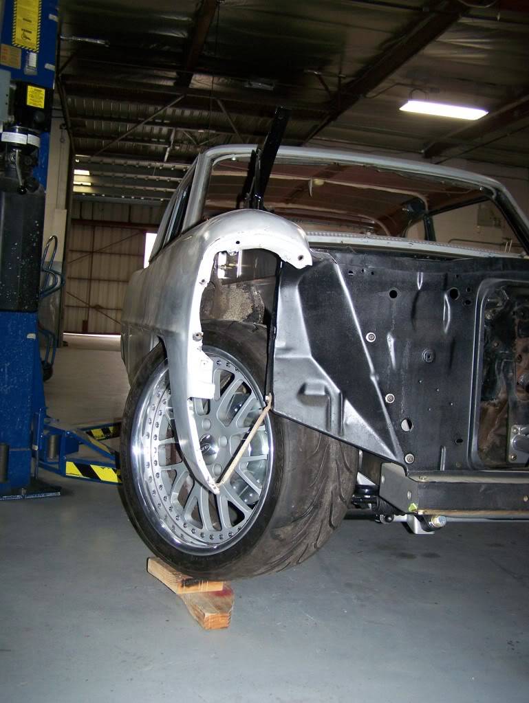

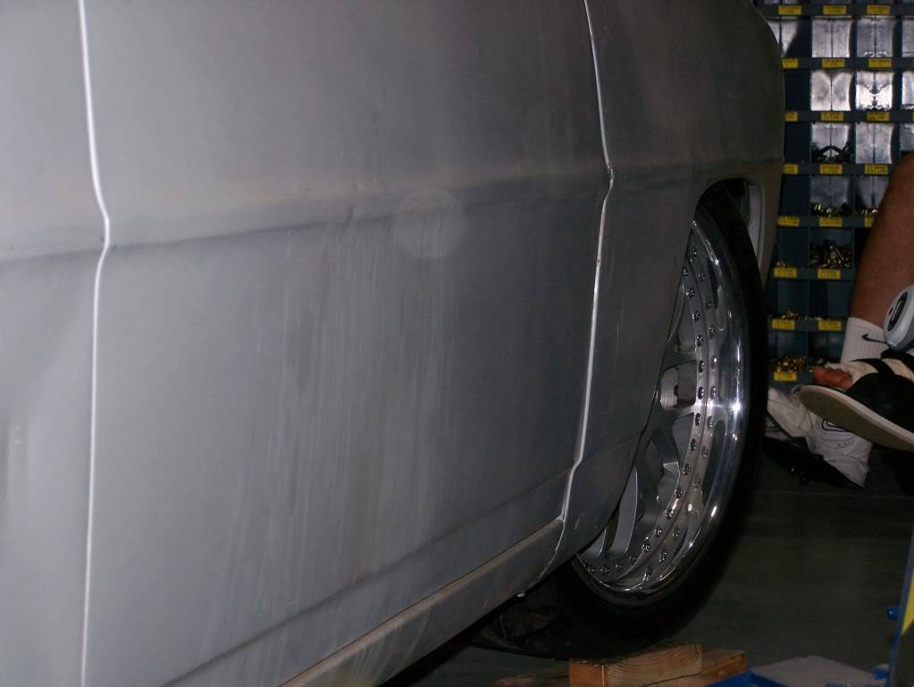

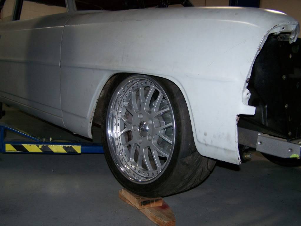

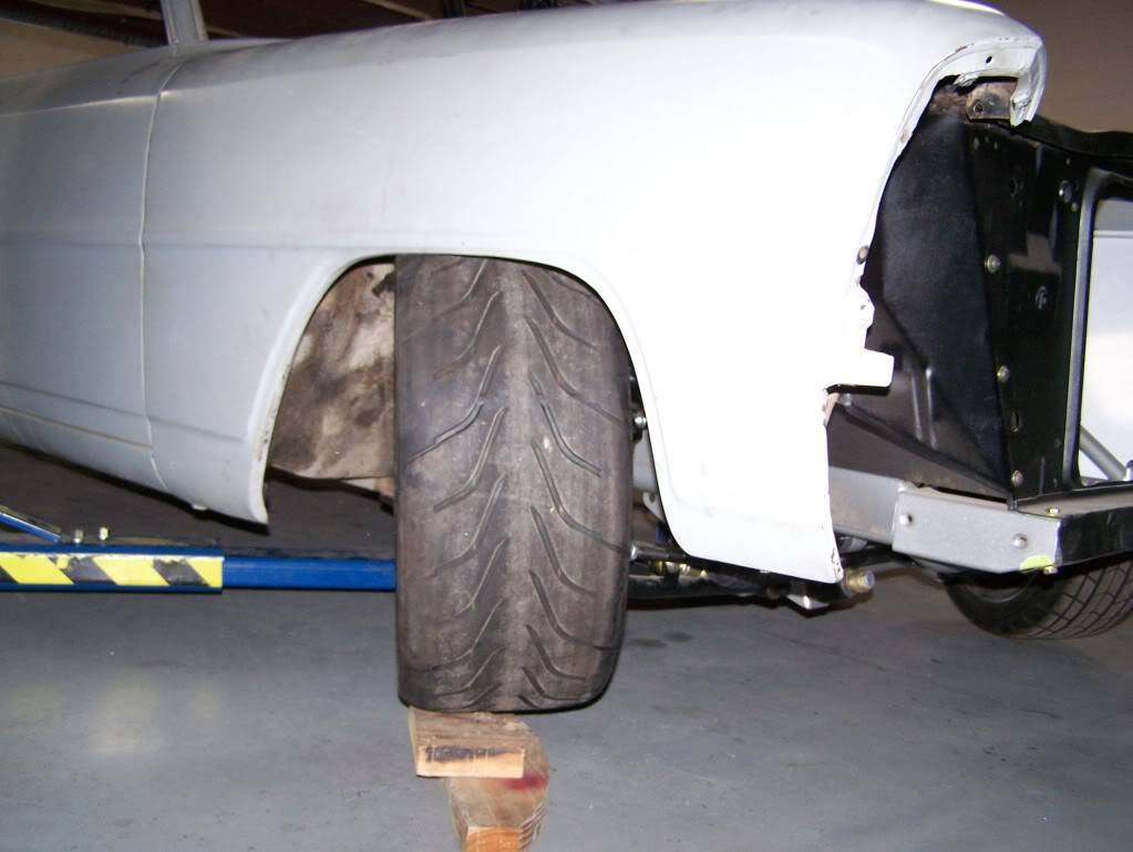

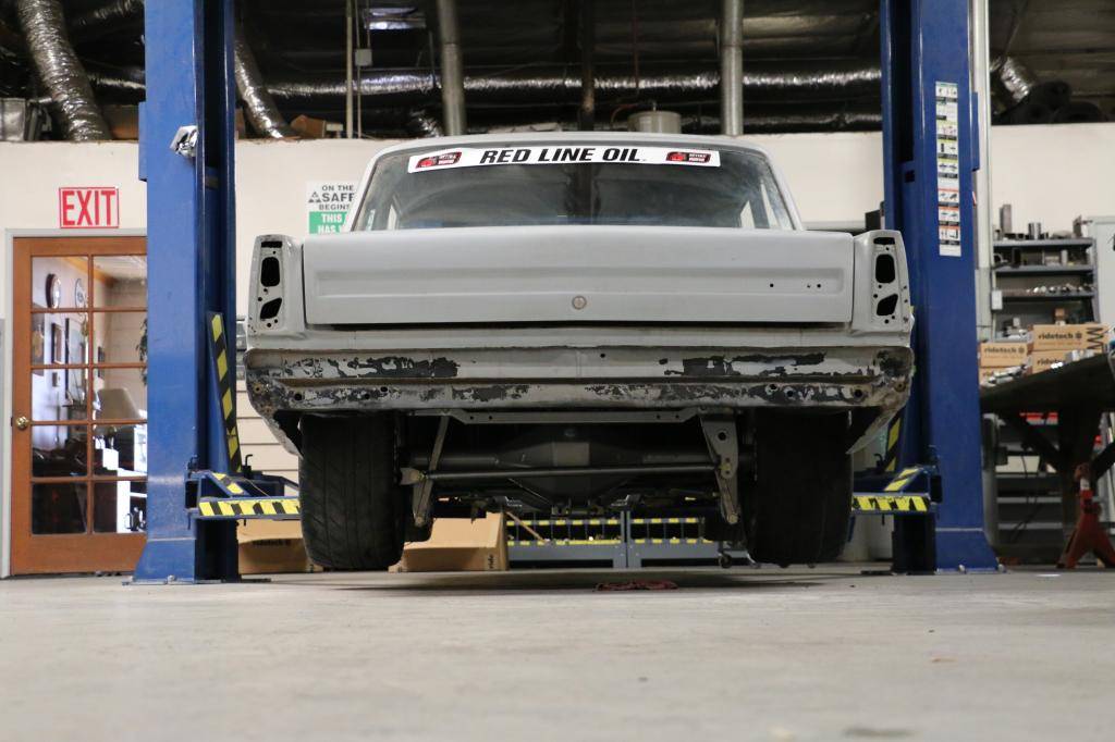

      The car has been in a stand still since Sal broke his leg but he has been making some headway lately.

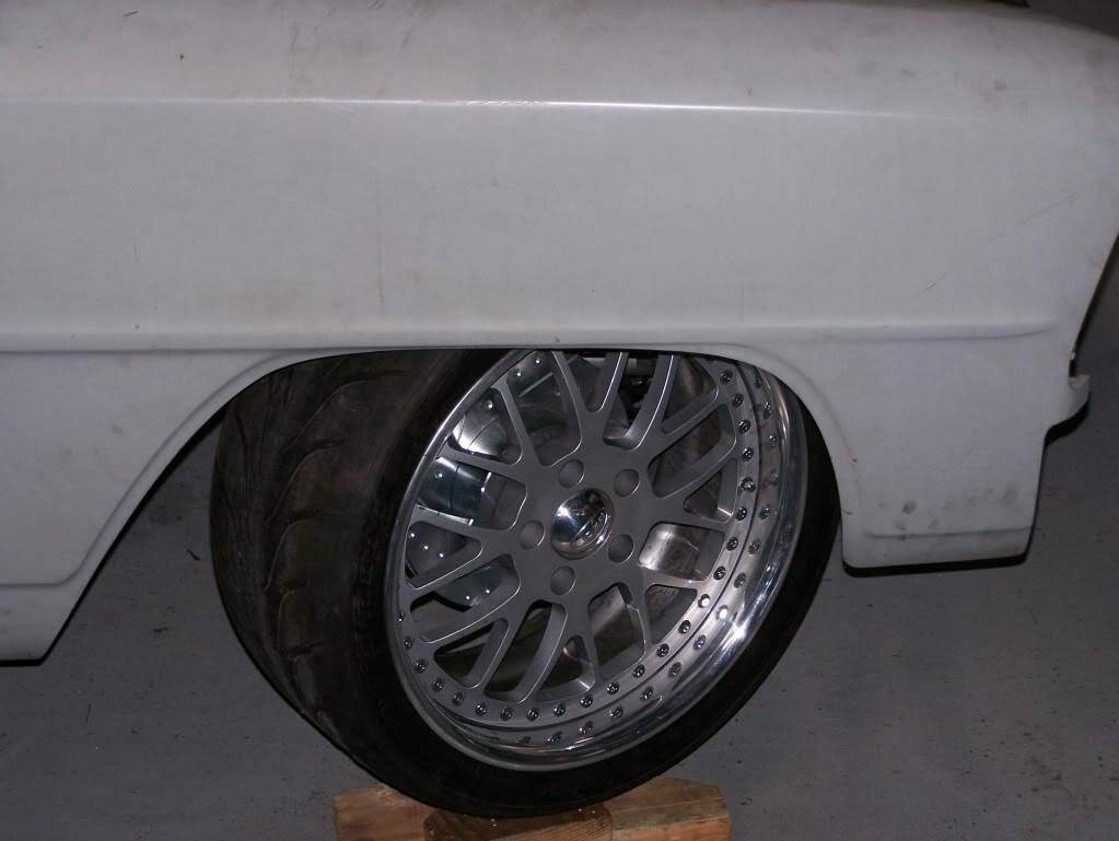

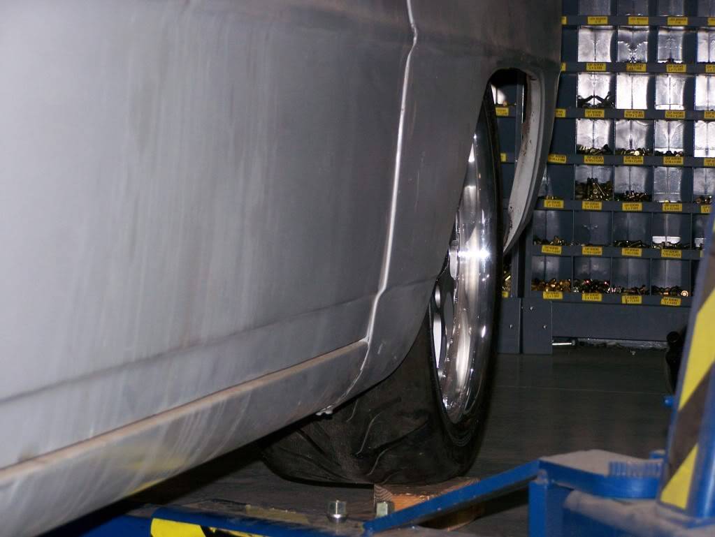

      Here are some pics of Sal's '66 with a 5.75" backspace 18"X9" wheel shod with a 255/35/18 R888 tire
      These tires measure out to 25.1 overall diameter & 10.5" overall width.

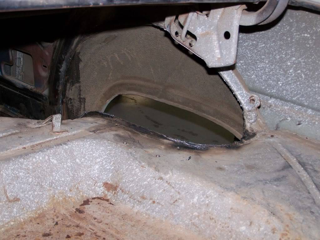

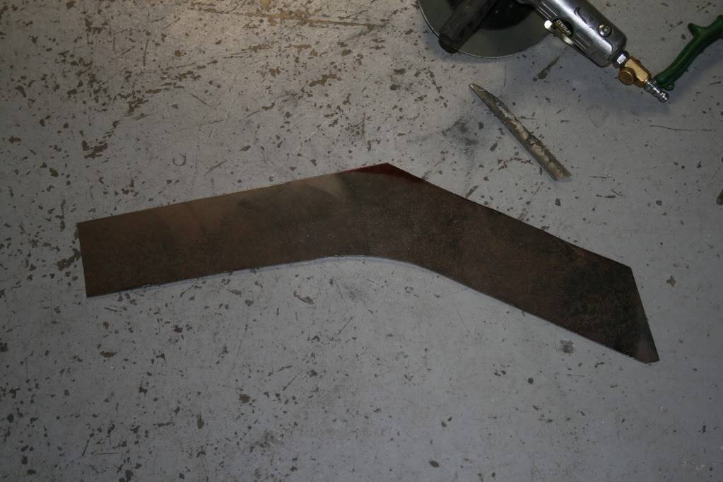

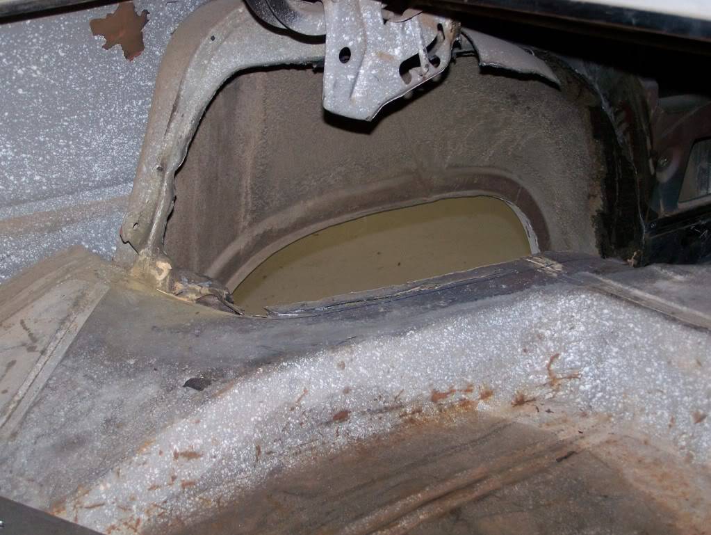

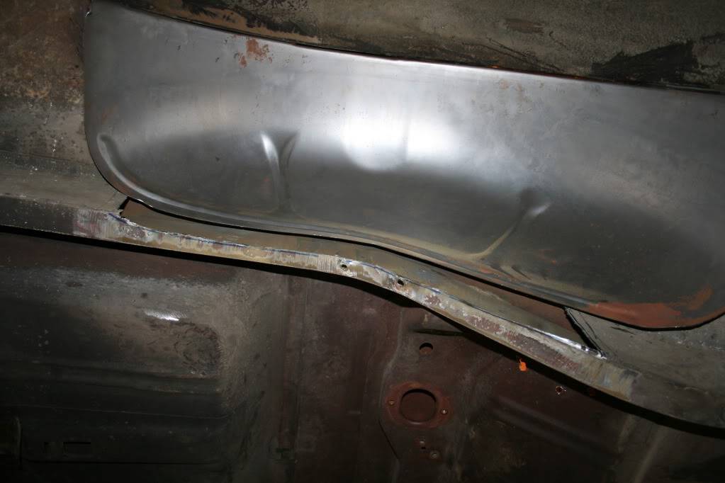

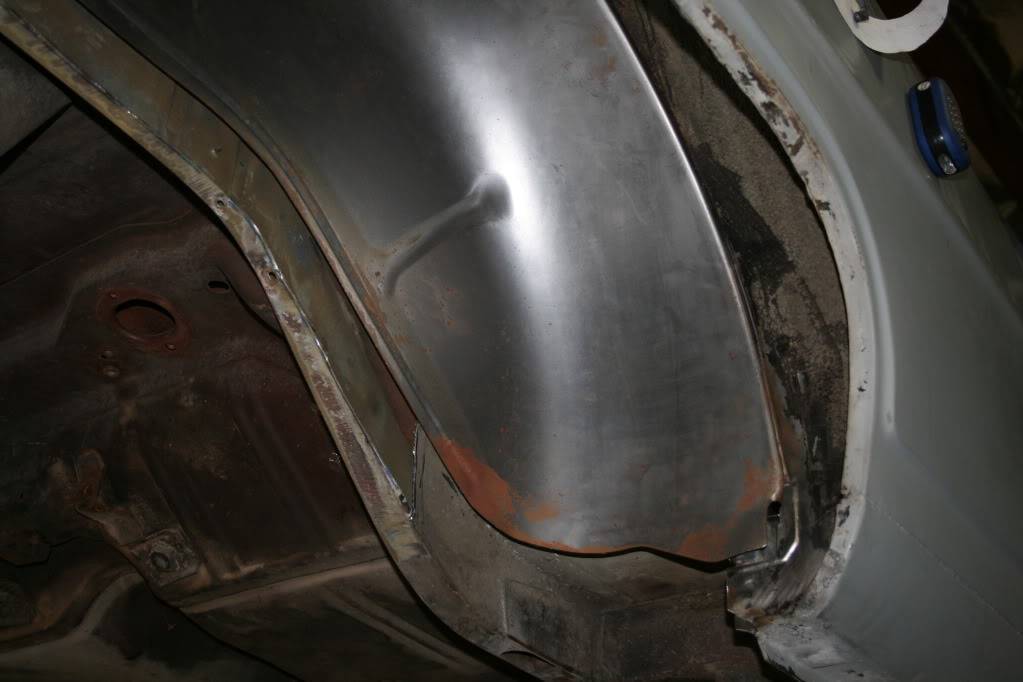

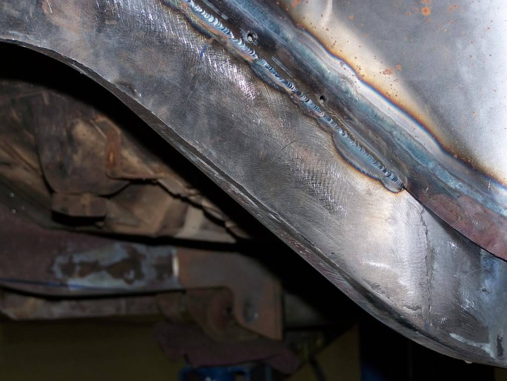

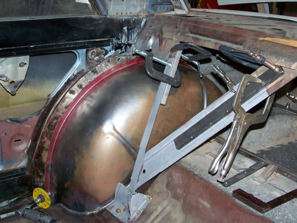

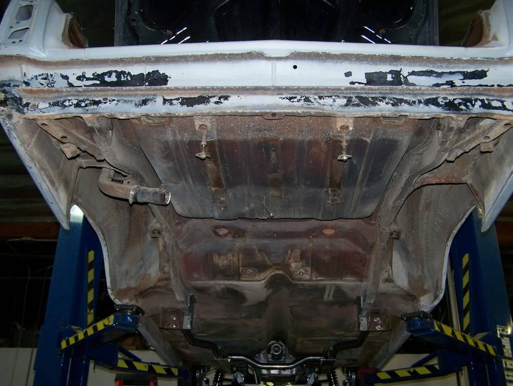

      There's finally some room on one of the lifts so Sal got to work on the tubs this weekend.

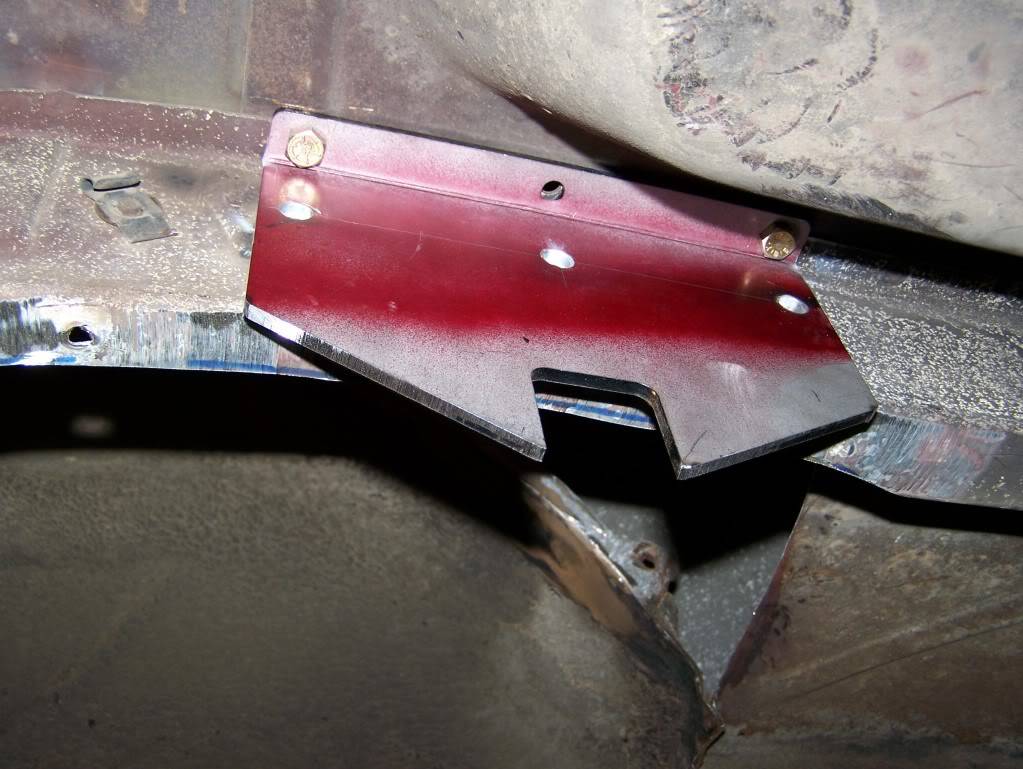

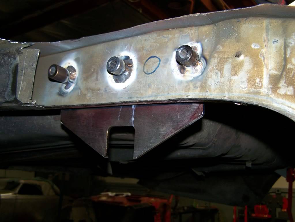

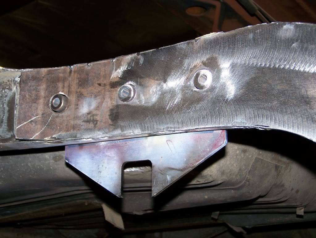

      We're going to use some counter sunk bolts to sandwich the coilover cross member plates into place instead of welding it them to the frame.
      The new frame plate formed and the holes drilled to match the bungs above.
      -J
