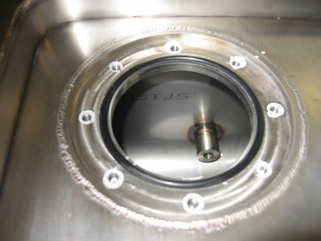

      Just a little teaser for ya. When you're ready Mike.....

      Carl is correct, it is coming, he knows. It is so close now, look for a introductory sale from us very soon.

      There will be a lot of information and tech coming in the very near future. Suffice it to say that every problem that has been mentioned above, and in other posts, has been addressed and steps taken to fix them.
      If you think what you see in the photo above is cool, wait until you see what's inside the tank.
