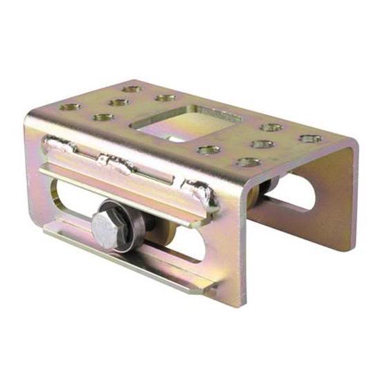

      Has anyone used these? they are for leaf springs not binding under load....
