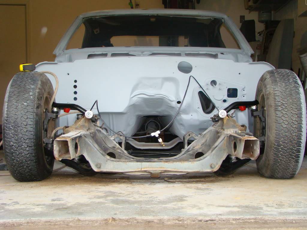

      This will be a slow project due to money. I'm a 28 kid who used to do mini trucks and have switch over to the dark side. I'm working on a 68 camaro with airride. Just wanted to show some pics.
      Drivetrain:
      * ZZ502 crate motor
      Chassis:
      * Fully welded factory subframe smoothed out
      * DSE subframe connectors
      Rear Suspension:
      * Custom made 4-link
      * Shockwaves
      Front Suspension:
      * CPP drop spindles
      * Tubular a-arms
      * 1-1/8 swaybar
      * Shockwaves
      Steering:
      * Iroc steering box
      Wheels & Tires:
      * 18/19 Pro wheels
      Interior:
      * Full custom interior
      Body:
      * All new sheet metal
      air ride installed
      Fire wall smoothed
      and this color with dark grey strips

      Just got done welding the frame up and smoothing it out. slow coming. about to bolt it back in.
      Norcal
      157
      That looks pretty nice man. That's how they shoulda been from the factory!

      Quote Originally Posted by astross89 View Post
      Excellent job to fully weld all the seams, really increases the frame strength, I Think That's one of the cheapest top upgrades to do
      summerville,sc
      160
      that looks killer i should do that to mine. what size metal you use? and did you brace it up at all?
      Feb 2008
      Melbourne, Fl
      237
      weld then grind, weld then grind. Then use a small skim coat of all-metal is what I did.
