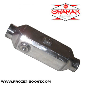

      I'm also looking at a par of these water-air intercoolers for a nice clean compact look..What do ya think? $170ea

      How complicated is an air-water system? Do you have to cool the water off with ice or can it run on its own much like a standard cooling system?
      Phillip
      Rustburg, Virginia
      3,436
      Quote Originally Posted by PhillipM View Post
      ...and do they have a pump to circulate the water?
      Oct 2009
      New Derry, PA
      1,265
      Either way. Most drag only units are plumbed into a separate ice water reservoir (Coleman cooler) and use a circulating pump. They can also be plumbed into the cooling system, BUT this is obviously less effective cooling, and you will need to look at radiator size because you are going to need a LOT more heat rejection to keep everything cool.
      (Sorry, misread your post slightly... You are wanting to use a separate water radiator cooling system without a reservoir? Yes, it will work, but what is really the point? You will need a radiator for the intercooler system, which negates the space advantage of the water/air units....might as well just go air/air and eliminate the middleman.)
      Sep 2002
      So. Cal
      1,179
      How complicated? I guess it depends on the space available. Air/Air would be less if you don't need to hack/modify your front end to make it work.
      I like how compact and efficient the water/air coolers are. (e.g.;ZR1) I was thinking of putting a small water tank and pump in the trunk and running the lines to the front. Heat exchanger looks kinda like an A/C condenser if you place in front of the radiator. I think you can run a smaller coil with a 10" fan anywhere you can find space under the car?
      I was also thinking--with the turbos, you don't need to have the pump running all the time while cruising. For the street, use a boost switch to turn on the pump (adj time delay off) and for the track use an override switch (Ice in the tank for a colder charge on dragstrip days)

      If you want the same amount of temp differential, you need the same amount of heat exchange. If you're doing water/air with a radiator, the water is just a transfer medium; it does NOT improve the cooling efficiency of the overall system (compressor outlet temp vs. intercooler outlet temp). It can improve the packaging in the car, but a smaller radiator works the same way as it does with the engine...it won't remove as much heat.
      Water/air with a chilled water reservoir is a whole different story...
      Socal, Ca
      924
      Ron,
      What CFM are you looking at? Are you looking for the 700 CFM each intercoolers?
      Quote Originally Posted by RSX302 View Post
      Sep 2002
      So. Cal
      1,179
      Quote Originally Posted by exwestracer View Post
      I'm all ears (ok eye's..LOL) and do appriciate your input...
      I know that water is a better heat transfer medium than air(hence smaller turbo intercooler).
      I agree that once you get the heat into the water, you now need to pull it back out using air (1:1 heat transfer with a bigger radiator)
      I haven't done the math but most radiators I've seen don't use the same size as an air/air intercooler.
      Also max 1:1 heat transfer would be based on 100% throttle all the time at max boost. I don't know too many that would plant the throttle with 800+hp 100% of the time? Road racing on the big track at Willow I might see full throttle on the front/back striaghts for less than 10sec? 145mph

      I think my new set-up will be around 750-800hp. (~800 is the limit of my turbos) 800 = 1040cfm so I was wondering about the 450cfm units (pictured) x 2 to make up 900cfm? Too small? They use the 2.5" in/out which is the same size as my Banks intake box. My Turbo outlets are only 2" (1.60" I.D)
      They claim up to 450cfm at .1 psi drop.. That pressure is very low..could I get 500-550 out of them with less than .5-1 psi? These units are only 13"x4"x3.5"
