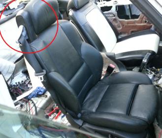

      got some 2001 330ci seats, can this part be removed with out setting any bags or explosives off?

      The part you have circled in your pic is unique to the BMW E46, convertible seats, which have the built-in shoulder belt. This part also supports and adjusts the headrest. If for some reason you don't want this part (and the shoulder belt), I would not try to modify the seat, but rather look for some coupe seats (which do not have the integrated shoulder belt). The coupe (non convertible) seats are typically less expensive without the integrated shoulder belt and much easier to find as BMW built fewer convertibles. Hope you find this info helpful.

      I like the intergrated seat belt, but interested in just removing the headrest part so that its as low as the low back bucket seats. the shoulder belt will still be there. plus the passanger side is cracked during shipment.
