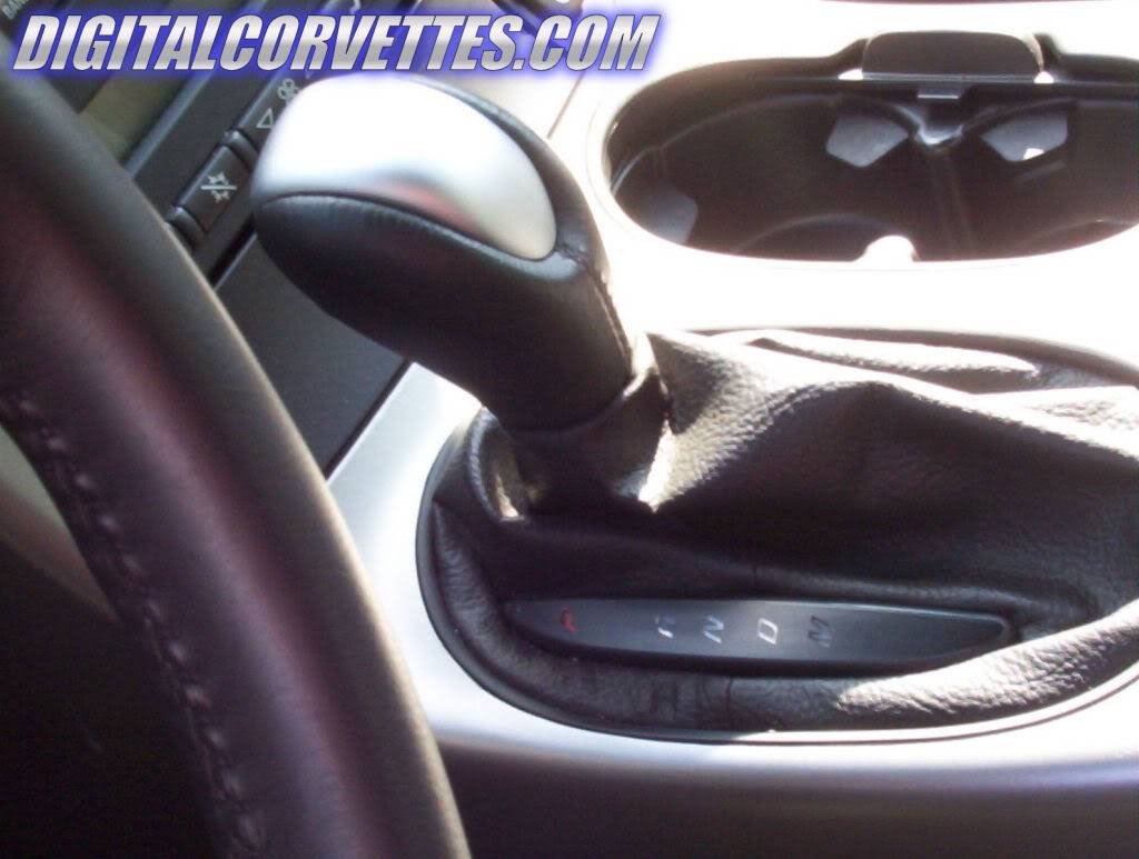

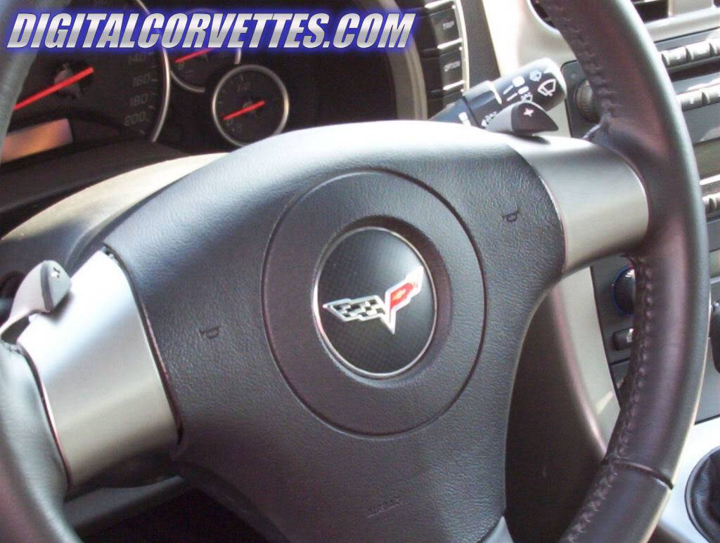

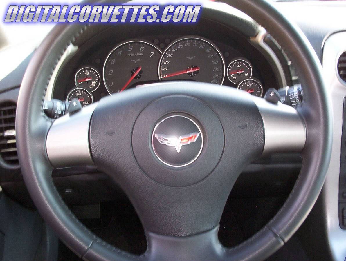

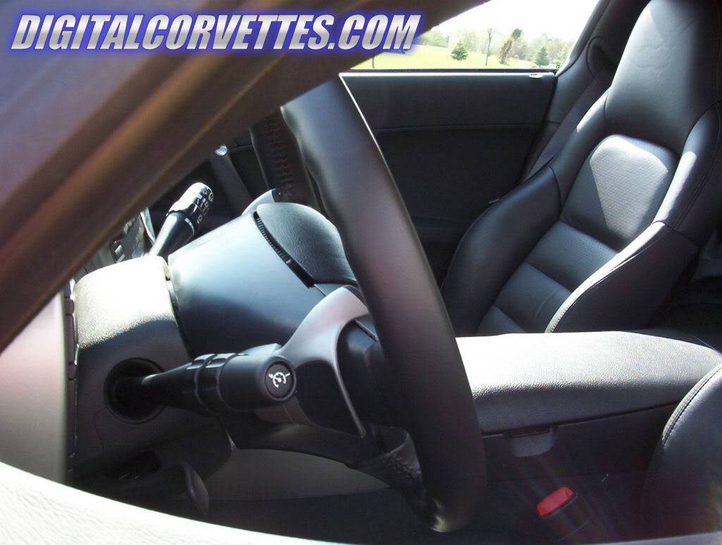

      One could expect it to be larger. Otherwise the additional components must be made smaller (read: weaker) to fit. But you never know. This really is a whole new generation of transmission.
      Cripes, I'd hate to see how much bigger it is. The 4l80e was a tight fit and required enough tunnel mods!
      Its also going in the 06 Vette, Paddle shifter, with auto option.
      Heres a few pics of the Vettes paddle type shifter.
      http://v-series.com/home/content/view/21/31/
